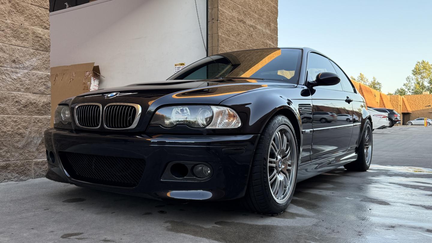

    What's up guys! I have an issue that I thought was resolved multiple times now, but it continues. Take a look below -
    Overview -
    Video showing the issue - https://drive.google.com/file/d/1i2P...usp=drive_link
    Related changes for your info -
    - Koni yellow suspension and H&R springs (26k miles old)
    - Control arms and with poly bushings replaced (36k miles old)
    - Tie rods replaced (38k old)
    - Steering rack replaced (38k old)
    - Wheel and tire setup: Stock 18’s staggered setup, stock sized brand new Michelin PS4’s - F: 33psi, R: 36 psi
    - No camber kit or anything else aftermarket on suspension
    Summary of problem -
    Shimmy in steering wheel came once installing spacers that will not go away - occurs around 50-80mph - This is still happening even with a brand new Turner Motorsport Flush kit.
    This all started when I put 15mm spacers on the front, and 10mm on the rear. I bought a set of used spacers from another e46 M3 guy for $100 (Macht Schnell) with extended bolts and threw them on. I got a wicked shimmy in the steering wheel from this. From there, this is the diagnosis and solutions I’ve gone through.
    Current setup -
    Front: 15mm Turner Motorsport Spacer, 39mm extended bolts, Stock 18” style 67 Wheel on brand new PS4’s at stock tire size
    Rear: 12.5mm Turner Motorsport Spacer, 39mm extended bolts, Stock 18” style 67 wheel on brand new PS4’s at stock tire size
