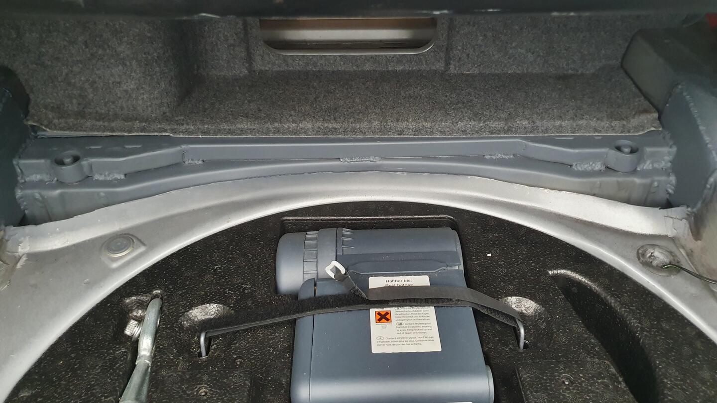

                CMP advised me that the convertibles don't need a front reinforcement bar due to the fixed rear seats (but you can still get popped gusset welds there). I had a DIY stealth bar made up out of 1" box section steel. This size required an extension strip to be added to the floor panel cutout so it could be welded back on (but that's probably unavoidable anyway). I had the cutout re-welded and boot floor repainted by a body shop - looked OEM when done. Noticeably stiffened up the backend (had poly subframe mount bushes put in too)
                The stealth bar combined with a good front strut brace really stiffens up the 'vert nicely.
                The CMP is an H bar config adds another directly between the chassis rails - but this intrudes into the boot
                From what I learned this kind of bar is essential to stop cracking. Putting reinforcement plates on the underside to repair cracks is treating the symptom not the cause. The bar directly couples the rear mounts to the chassis rails, thereby solving the chassis design flaw that relies solely on sheet metal to do the job (which flexes and eventually fails due to fatigue)

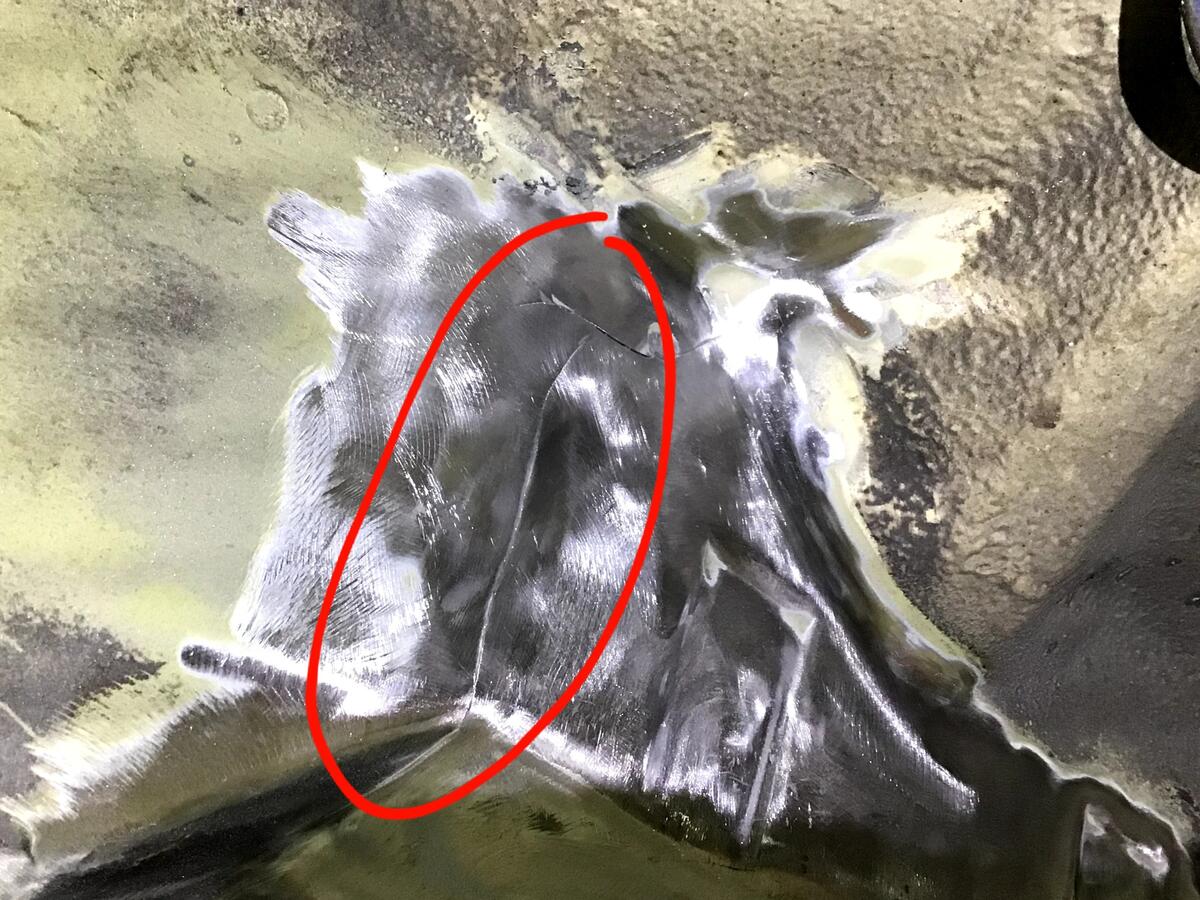

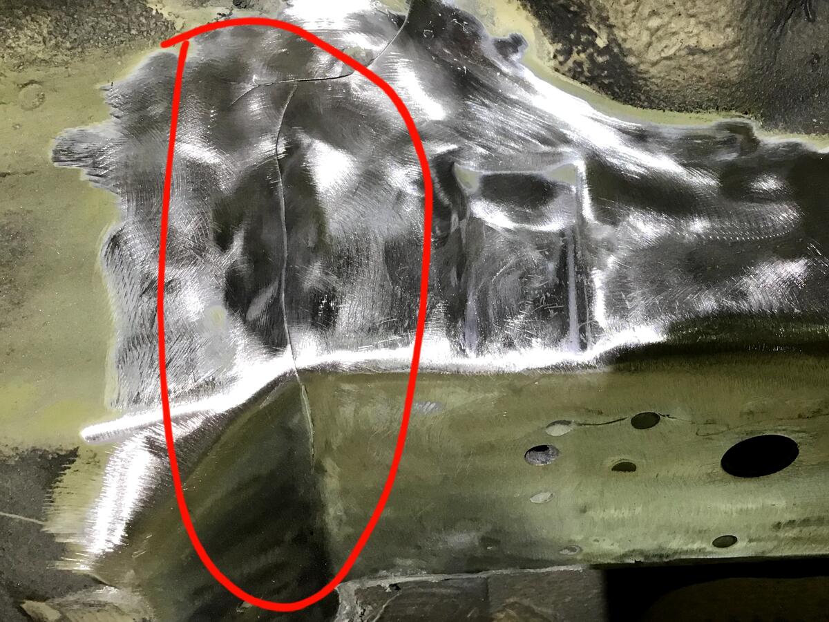

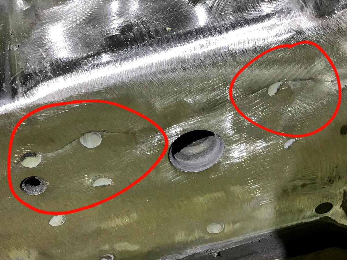

                      I'd heard the same thing but just had my subframe reinforcement completed a couple weeks ago anyway. 164k miles and here's a couple example pics of my floor pan cracks. It doesn't seem to matter vert or not, all E46 have subframe problems.
