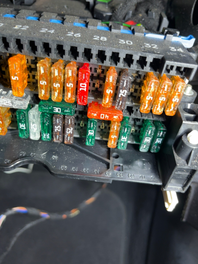

      6. Checking the fuses but the hvac related ones all are ok. Btw the convertible does not have a fuse plugged into slot 28 as most people say to check that first.

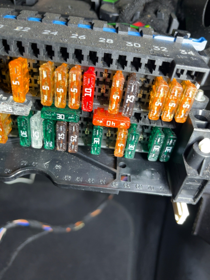

                those are good suggestions, but for some reason, if you look at the photo of my fuses, fuse number 23 and 28 are not there. It’s never been there. I’m assuming that the unit gets power from some other fuse I think but I can’t figure it out.

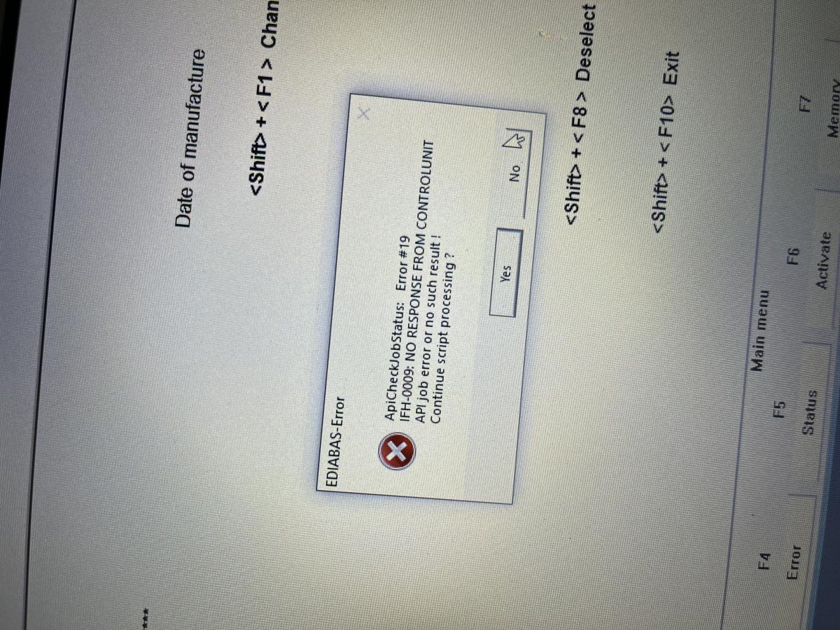

                Also, when I load up info and check for codes for the IHKA unit it says I can’t connect to it because there’s no power to the unit. See the photo of what inpa says.

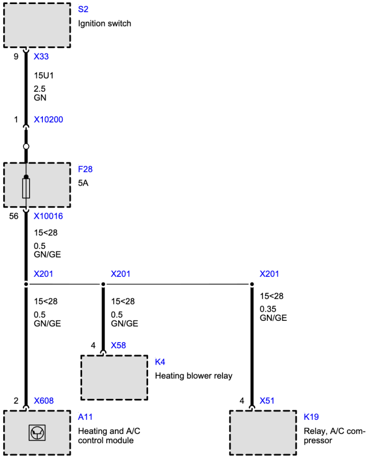

                      Positive you didn't accidentally remove F28 during the install? Wiring diagrams show it as the supply to the HVAC control stuff. All pictures I can find online of E46 fuse boxes also have it populated.

                        so after more trial and error, I was about to give up and take it to the dealer when after consulting some more people, they just told me to throw in a 5 am fuse in space 28 to see what happens. I never touched fuse 28 before so I figured it was worth a try. After installing the fuse, it worked. I never removed this fuse before and It was empty as that was the first thing I checked when all this started, but since it works now, I'm ok with it. Car ran fine for 3 years without it, unless it was always there and it mysteriously popped out and dropped somewhere, but I looked everywhere and couldn't find a missing fuse.
