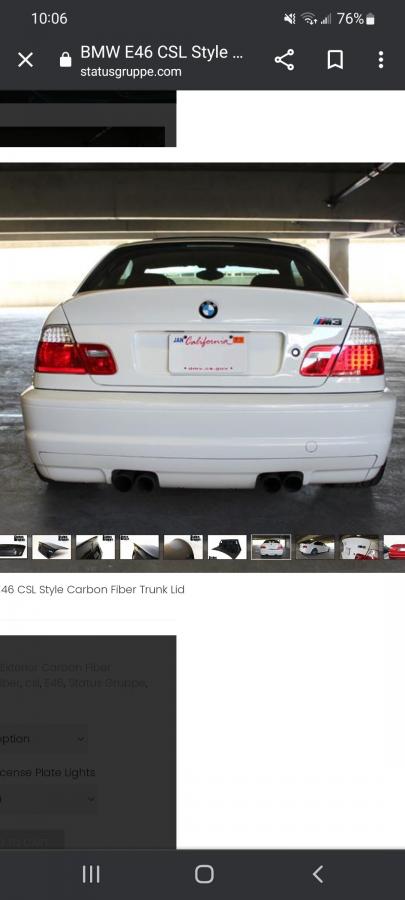

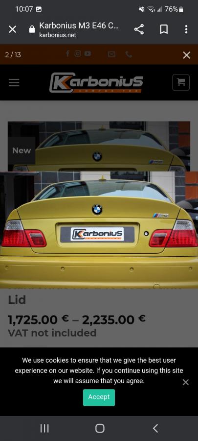

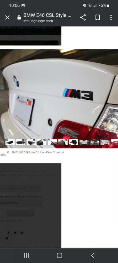

              For those that installed the "M3 emblem", where did you feel like the emblem should go? I know it's subjective because the csl emblem is longer, but I'm trying to figure out where to tell the paint shop to install it. Included pictures for reference...
                A good, balanced spot to place it is lined up with the top left side of the reverse light and the bottom of the BMW badge. It seems like they would have done this from the factory.

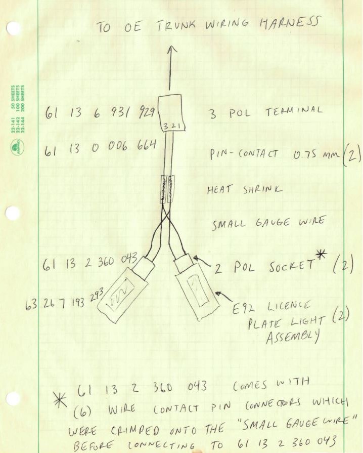

                              This DIY was super helpful, thanks Titaniu//M for the thread. Just wanted to add or mention for others that pin2 is going to be your + and pin3 is going to be your - when you're connecting to the 3 pol terminal. I just had to flip my pins since for some reason I had it reversed. Thanks again.
