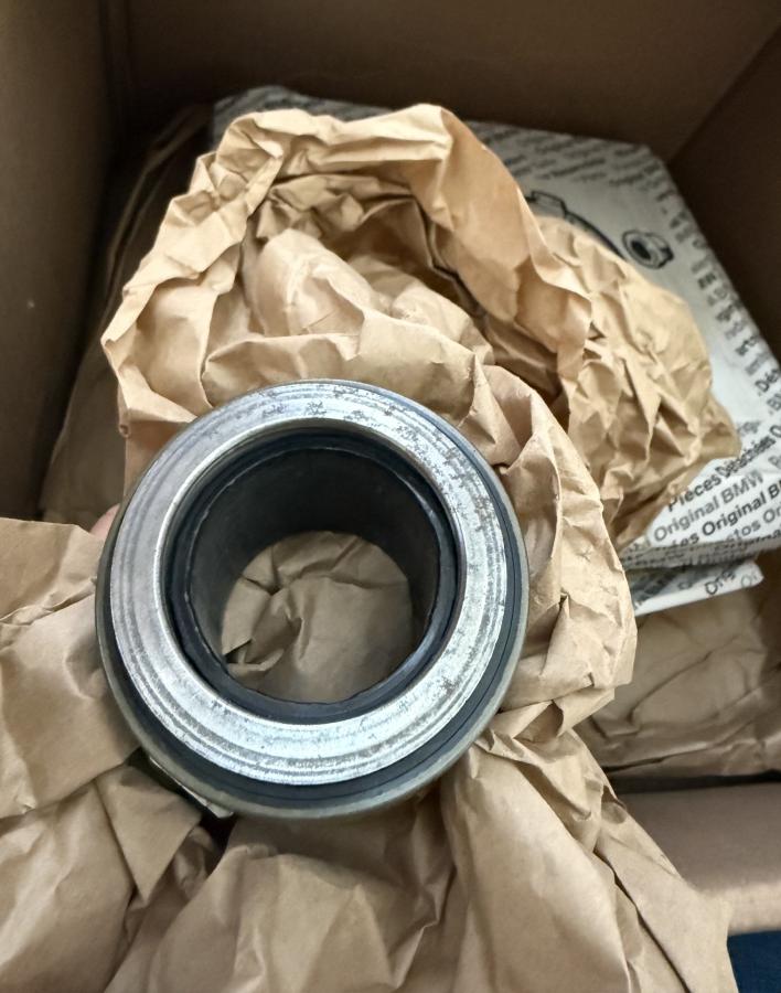

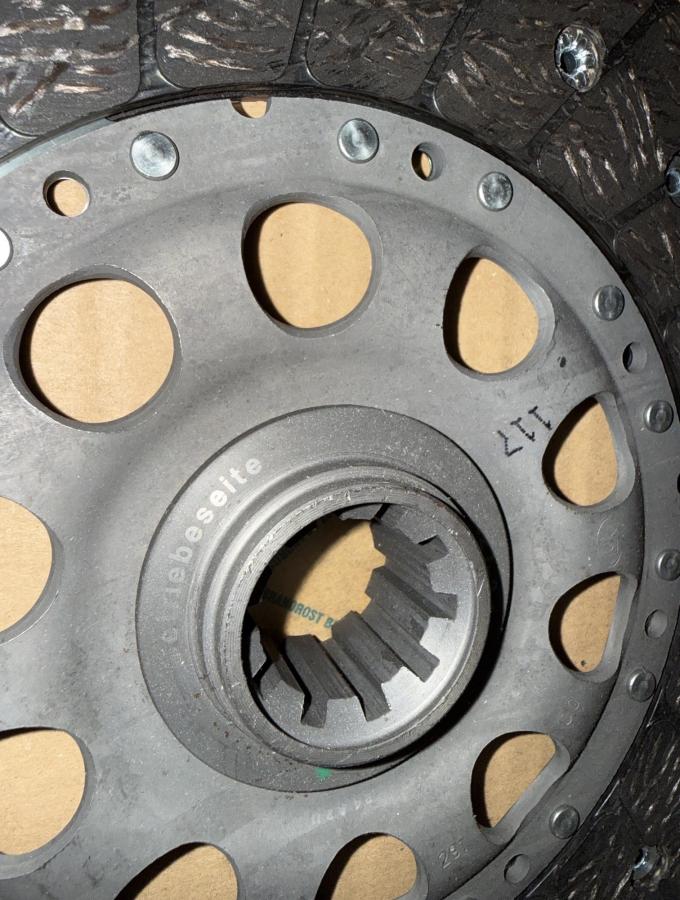

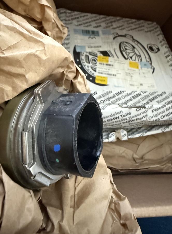

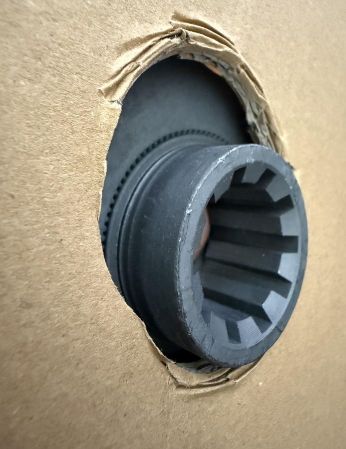

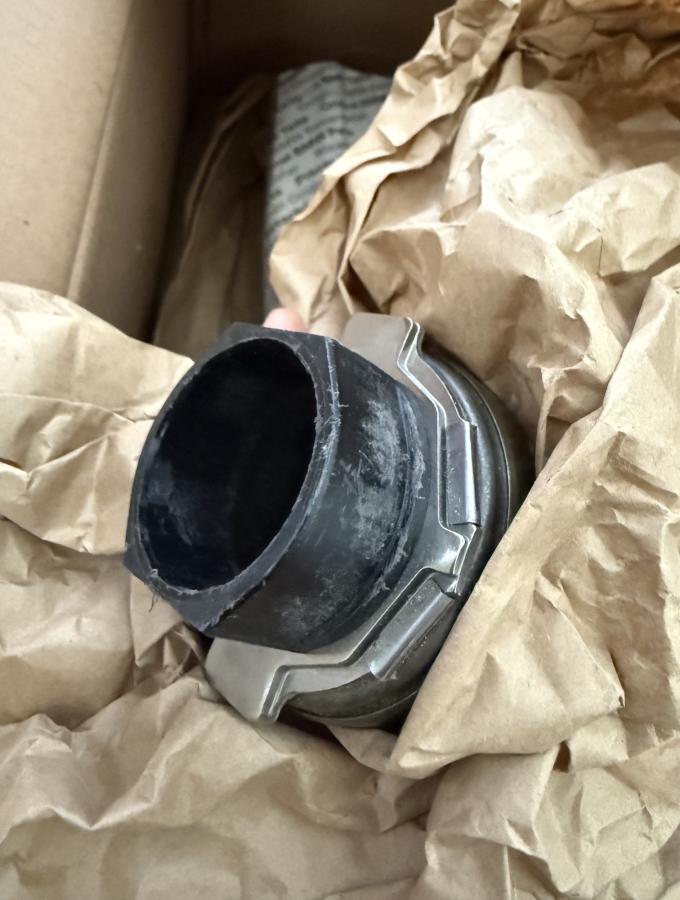

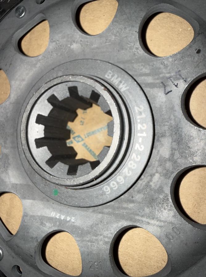

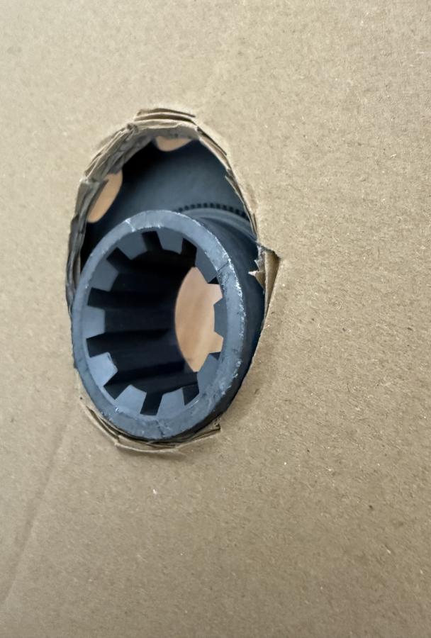

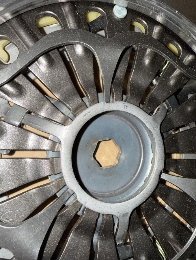

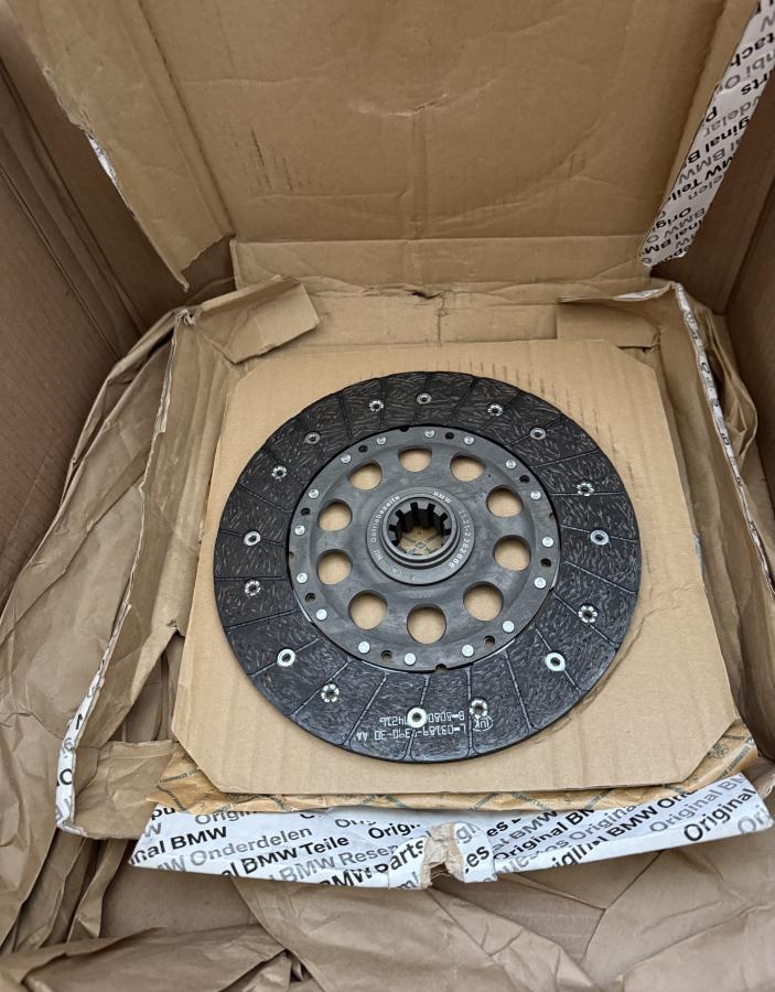

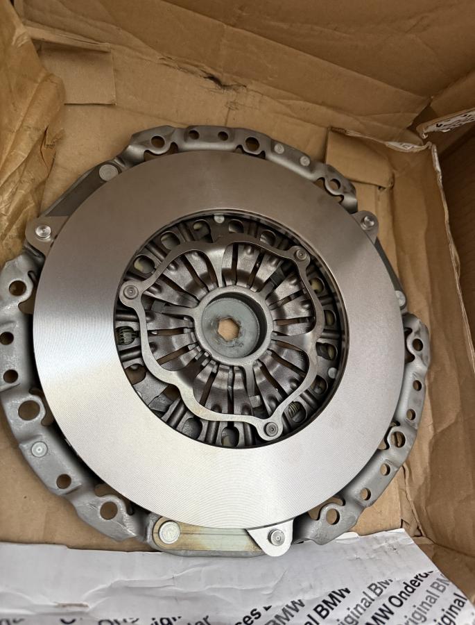

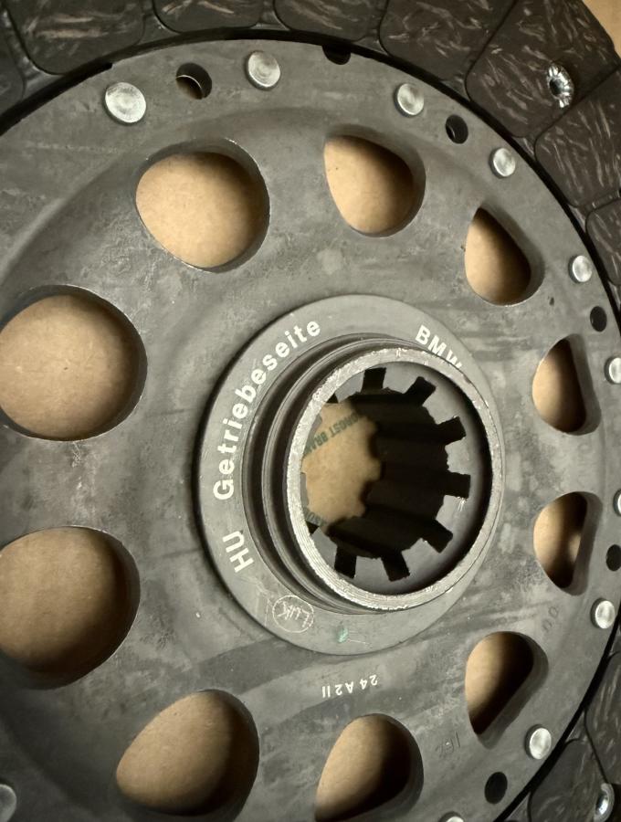

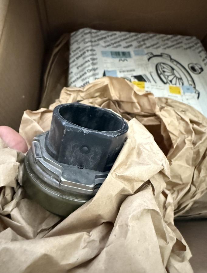

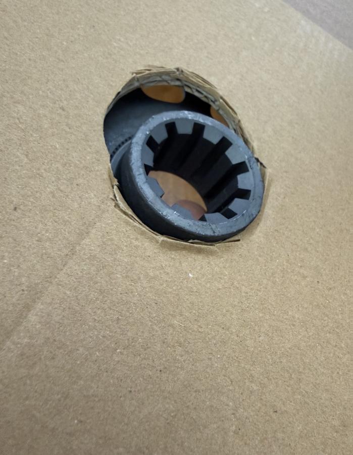

    FCP Euro has the genuine BMW clutch kit on sale/clearance for $540 before taxes so I thought I'd buy it to store away since it was listed at $1k for a while now. Need a second or third opinion from you guys, how does this look to you? TOB looks a little chewed up, and so do the inner rings on both the clutch disc and pressure plate. Is this normal or would you guys send this back? Curious to hear some of your opinions, especially those who have done a few of these installs.

    Looks like "handling" to me. I'd probably keep it. The friction surfaces look good to me.
      Same
        The TOB in my LuK kit had the same rough finish to it. It's just how they are.
        BTW LuK are supposed to be the OE supplier.
          I'm not even so sure that the input shaft of the transmission mates with the surface in question due to the taper of the shaft.
            Is this only for the SMG?
              No, E46 M3's all have the same gearbox, clutch and flywheel.
                Looks fine and normal to me
                  Is the throw out bearing decent with the Genuine BMW kit? The last Luk kit I installed on a customer car came with such a crappy and loose-feeling bearing that I threw it in the trash and got a Sachs bearing which felt quite a bit smoother and tighter.
                    I had a lot of problems with gear changing when i used a Sachs TOB with my mew LuK clutch kit.
                    I cannot remember why a Sachs TOB is recommended over the LuK.
                    I had the LuK TOB fitted and all is well.
                    I don't think mixing clutch components is a good idea.

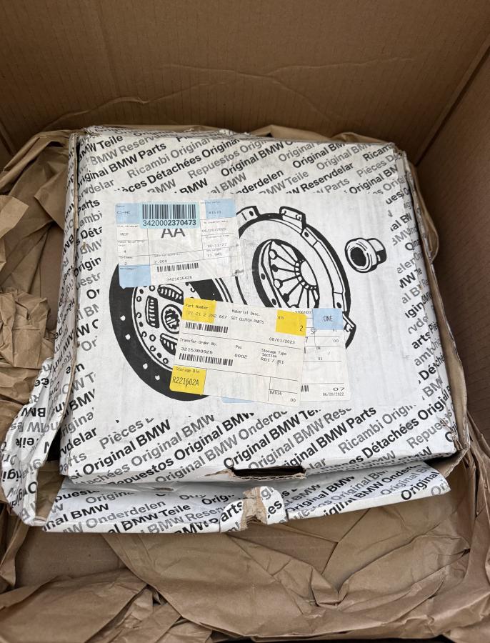

                      That box looks beat to shit.
                      The OE bearings are crap. I pull the race and then clean and grease the bearing which I would like to believe helps it last longer and feel smoother.
                        Yeah, that box looks like it went 9 rounds with 90's Mike Tyson. sucks too because I know FCP are sticklers when it comes to original packaging when returning for lifetime replacement. How does everything else look to you though?
                        /// 2004 SG/IR - Build Thread
                          It looks as expected coming from box that's beat to shit. As long as nothing is cracked and the friction surfaces look good, woundn't worry about it.
