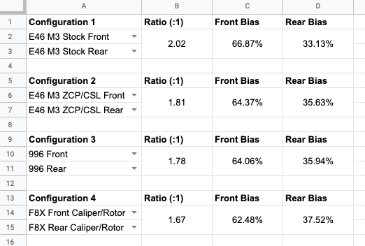

                  What are the piston sizes and pad dimensions? I'll update the brake bias calculator for us.
                  Weight vs. heat dissipation: I'd take the unsprung weight savings of a monoblock aluminum caliper all day. If you need a 380/370 you're pretty hardcore on the track side of this debate and are not doing an F8X retrofit anyway. Agree the 996 is a lot of work for a 345 and it's a shame, but the 996 retrofit to me is about handling, pedal feel, and bling. The downfall of the 996 retrofit is the non-existing rotor selection...you're stuck with fake 2pc rotors made out of butter. Okay I'll climb down now, sorry. Whoever had bad pedal feel with the 996 needs to keep bleeding lol.
                    Good write-up OP.
                      Good write-up OP.
                      Pistons - 40/40mm front, 44mm rear.

                        I thought the 996 retrofit used OE rotor sizes. Is the issue that there aren't any quality two piece rotors available?
                        Yeah, uses the CSL/ZCP/Z4M 345mm front rotor and stock rear...and there's no aftermarket.

                        Thanks, looked up replacement pistons on Racing Brake and saw the same. Got the pads from Performance Friction. This set up is a little more rear-biased than stock and full 996 but not bad. Updating the configuration part of the calculator so that it's easier to update in the future. Be back soon.
                          Is that based on Mk 60 brake bias?

                            Also thank you for calculating the brake bias! I was starting to do the calca but then got swamped with work. Could you possibly do this for both the mk60 and DSC3?? Thanks!
                              It was later determined that MK60/20 rear pistons didn't matter in the equation...can't remember why. Something to do with proportioning valves and equal pressure, or true north and climate change..something like that. p0lar even said all of his original charts were wrong because they calculated for that and put disclaimers on his original post in *the* brake bias thread. And that one dude in another thread (maybe streamline thread?) hooked a raspberry pi up measuring outputs form both MCs and confirmed this.
                              Also his (p0lar) charts had a pad friction coefficient....we all collectively agreed we could ignore that because we know different compounds have different friction coefficients. If we just want to calculate straight bias based on caliper/piston/rotor sizes (which is what we love to debate on the forums), then we can ignore that as well.
                              Finally, he was also factoring in for leg strength lol. Once again, if we just want to focus on the parts that would be changing for our cars with everything else equal, we can drop that variable (make it a 1?) in the equations and a very different brake bias picture begins to take shape.
                              Enter me during the Streamline DB9 debates, all I did was gather all the latest information and plug the formulas into a Google Sheet calculator. I should have taken better notes but I didn't realize we were going to lose the forum. Let's not lose this one too, my mind is getting old and it isn't what it used to be. Anyway, technically it should be called a Caliper/Rotor Brake Torque Bias Calculator or something.
Name:	Screen Shot 2020-06-30 at 11.34.37 AM.png
                              Last edited by clawhamm3r; 06-30-2020, 08:35 AM. Reason: Updated table image with CSL/ZCP
