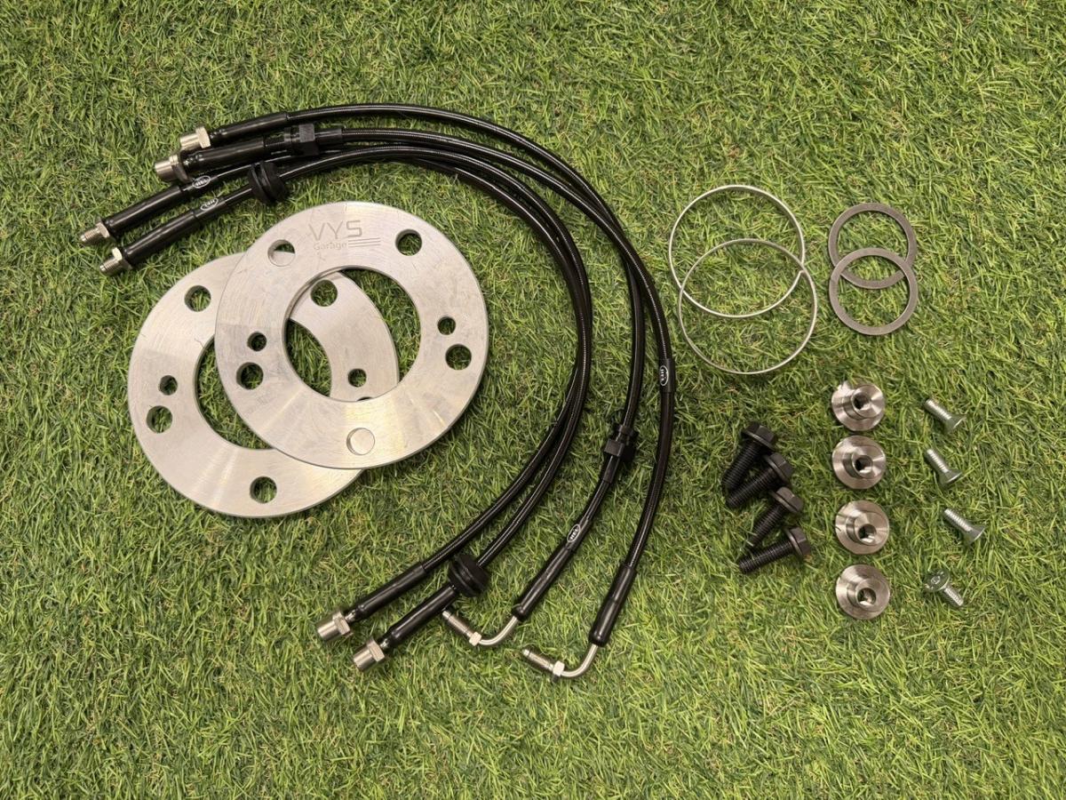

                        I purchased the install kit from VYS Garage. Will update once I get started on the install.

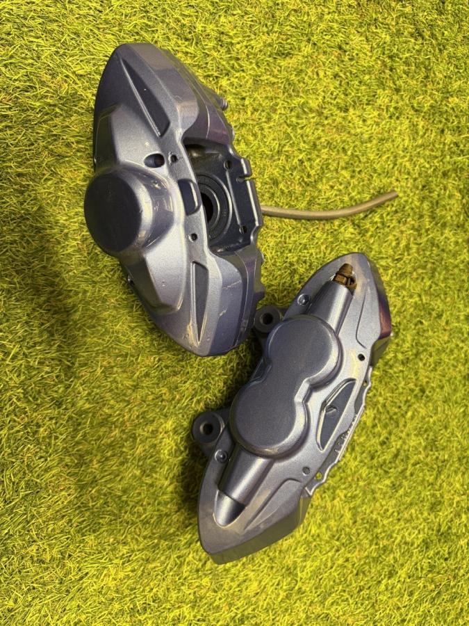

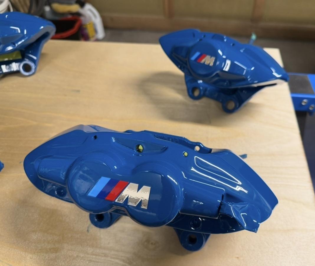

                          Calipers painted Laguna Seca Blue.

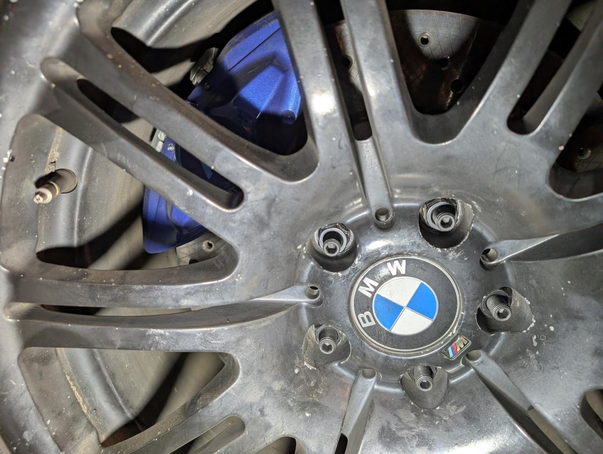

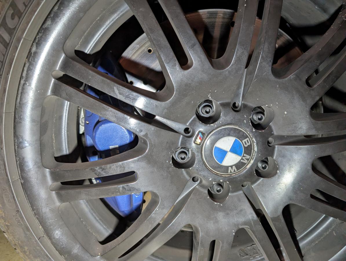

                            I ended up going for the VYS garage kit as well. No cutting or grinding of the F8X calipers at all. Minor bending on the front dust shield and rear one needed bit of cutting on the edges - not a total annihilation. Added a 10mm spacer on the front. Went with studs all around that helps heaps with installation and spacers.
                            With the VYS garage kit, the pads aligns perfectly on the correct portion of the discs. That's why it provides with eccentric bushings for the rear calipers.
                            Have been running the setup for the past month. I like it very much. Could not get to a situation of brake fade yet which I was able to with the OEM E46 M3 brakes without much effort.
