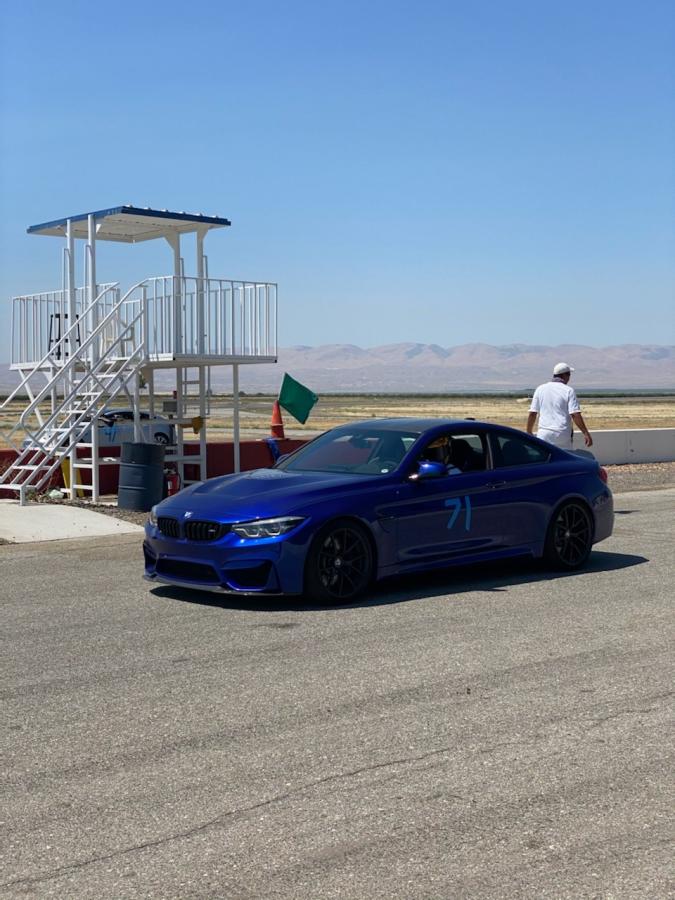

                  I can tell you from experience the factory steel F8x brakes are crap on the F8x chassis. I took my M4 CS out for two track days at Button Willow within a months time of each other. I was running DS2500's, some say its a terrible track pad but they're better than OE. A lot of brake fade once they start getting hot, could feel the pedal slowly sinking after the 3rd/4th lap full out had to definitely do cool down laps. Second track day went pretty bad towards the latter part, brakes were smoking, rotors were red hot and the calipers had a green hue on them. Servicing the car at BMW after the second track day, the outer seals were toasted was told the color of the calipers happens when they experience excessive heat.
                  I was going to upgrade the CS to ceramic and swap the steels onto my E46 M3, but I got wise and said it's time for a big boy brake kit. I did the 355/345 Brembo GT set, I am not a fan of the F8x steelies. The weight vs. performance benefit is what turned me off essentially.
                  Pic for reference.
