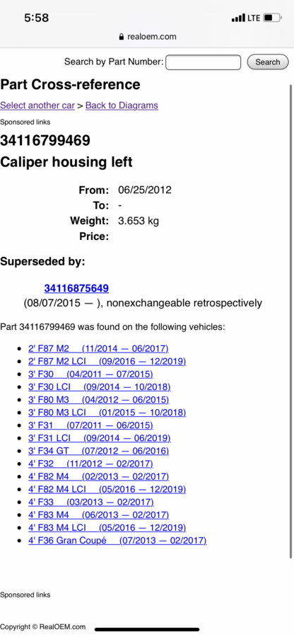

So if i need to source the set, what donor car and year im looking for? I check realoem and partnumber and found these cars with the same caliper/rotors, is the list correct?

All the M cars on that list will have them, but the non-M cars would have to have been optioned to have the same brakes as the M cars. M2 Competition have different brakes -- they came after the M2 LCI cars.
are there any markings on calipers or as long as they blue like the first post and just avoid the m2 competition?
This came off of other cars like the M235i, I want to say they mate with different brackets for different sized rotors? But I'm not 100% on the difference. So blue alone isn't correct.
If they're blue and came off of one of the cars that you listed first (and/or part number matches) then you're good.
