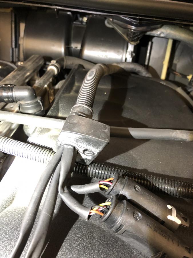

                              Getting my wires ready for the exhaust install and am at a point where I need to cut the beauty cover grommet that holds the four O2 sensor & EGT pigtails, in order to remove the Post Cat/EGT wires. Can anyone advise on the best location to cut this grommet to extract the wires? I'm thinking, cut on the side opposite that of the one that is pre-cut for the single, conduit wrapped pigtail that clips into place. Cutting this way would leave the center of the grommet in tact and maintain separation between the O2 wires and the other little conduit-wrapped wire on the other side. Or, am I just over thinking this?

                                I did it as you’re suggesting and it worked out.
