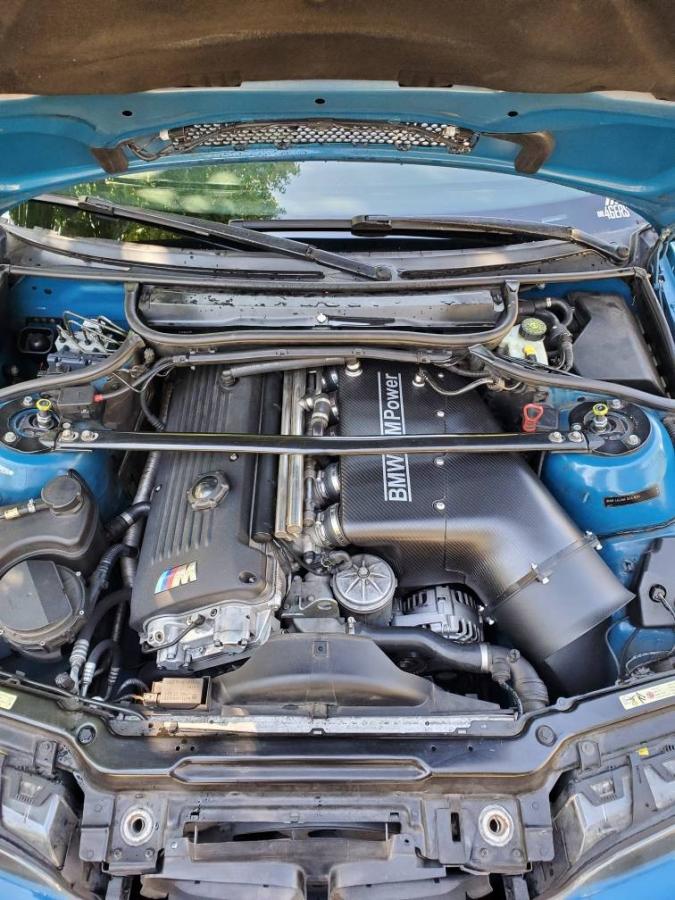

                  I have had my Haimus box installed for couple weeks now. The fitment is great, quality looks great. Sounds phenomenal.
                  Dyno baseline, stock airbox, stock tune, stock cams, CPI stepped headers, resonators but no cats, RE El Diablo section 3 - 281 whp, 238 wtq
                  Haimus box installed, alpha N remote tune from Epic, everything else the same - 312 whp, 249 wtq

                    Looks great, nice gains.
                    Repost in dyno thread.
                      Nice gains indeed. I can't wait to get around to installing my Haimus box and getting it tuned.
                        Thanks guy. I’m happy with it. I love the frozen carbon finish. I’m glad there is another option on the market finally.

                              To be clear, the gains came from tuning the car after catless headers were installed vs. stock tune.
