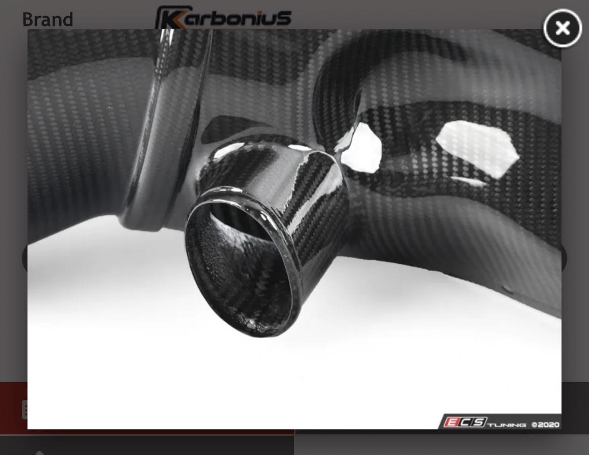

        Yet another question about the Karb race variant. Does it have the hole for the lower secondary ducting? Pictures on the Karb site don’t have it, pictures on vendors like ECS do have it. Would love to eliminate that hole and all the factory ducting provisions altogether.
        I’ll shoot them an email if no one here knows
        If I am interpreting your question and the pictures correctly - no the race variant does not have that ducting hole. I could have a old or newer version though?
          Thanks all. I also put one on order and shot them an email to confirm re: ducting provisions. The hole I’m talking about is the one shown here in ECS photos (on their listing for the Karb race box). The photos on Karbonius’ site have it omitted. Not that it really seems to matter, I’ve had it open on my standard box for years but nice to just get rid of it and stop thinking about that weird ducting.

            I bet the stock RSM dust boot would cap it
              Click image for larger version  Name:	F558C795-8143-43D7-ACC7-0958CCD7035E.jpg Views:	0 Size:	75.3 KB ID:	179954
              That hole is not present on my race version.
