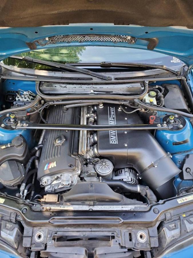

                  I have had my Haimus box installed for couple weeks now. The fitment is great, quality looks great. Sounds phenomenal.
                  Dyno baseline, stock airbox, stock tune, stock cams, CPI stepped headers, resonators but no cats, RE El Diablo section 3 - 281 whp, 238 wtq
                  Haimus box installed, alpha N remote tune from Epic, everything else the same - 312 whp, 249 wtq
                  Click image for larger version Name:	ImageUploadedByTapatalk1653499468.3139.jpg Views:	0 Size:	115.7 KB ID:	169366 Click image for larger version Name:	image_35370.jpg Views:	13 Size:	144.3 KB ID:	169363
                  Click image for larger version Name:	image_35371.jpg Views:	13 Size:	85.1 KB ID:	169364
                  Click image for larger version Name:	image_35372.jpg Views:	13 Size:	78.2 KB ID:	169365
                  That's really good to see! I'm chatting with Hassan to work something out on tuning. I'll start with Alpha N and do MAP conversion afterwards to give some more data to owners.
