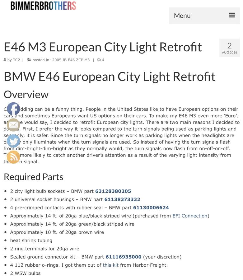

            For anyone interested in retrofitting the Euro city light set up, the following website by “Bimmer Brothers” provides a step by step procedure for accomplishing this. I saved this from a dated thread from the old M3F site.😁
            BMW E46 European City Light Retrofit Overview Car modding can be a funny thing. People in the United States like to have European options on their cars and sometimes Europeans want US options on their cars. To make my E46 … Continued
            Here is a screen shot:
