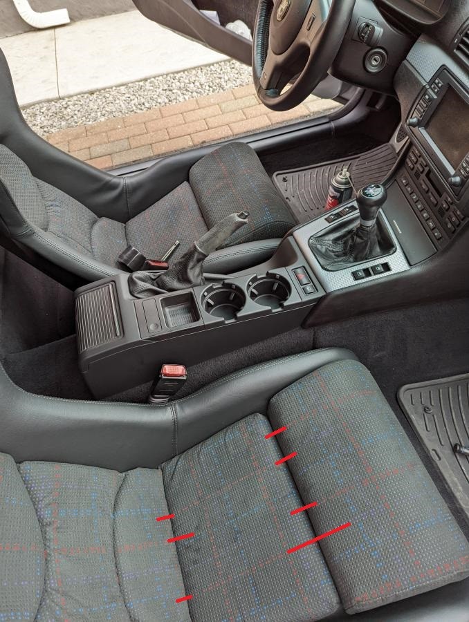

    Those bottom inserts not lining up would bug me to no end.
    I looked at the oem ones they dont line up either, honestly never even thought about it until you guys mentioned it lol.

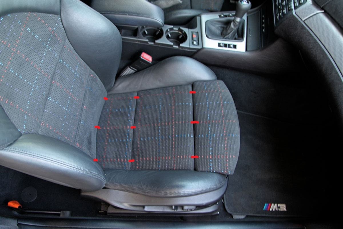

      They 100% do. I have never seen an OEM set of seats that don't line up. Sometimes there is slight offset on the rear seats between the upright and base section just because of the way the back seat is constructed but its normally not more than an inch out. Surprised your upholsterer didn't line them up by default, that's normally a given when working with a tartan style pattern like mtex. Most important thing is that you're happy with them though but that's the kind of thing the upholsterer should have known to get right and you could probably get fixed for free if you have material left. The OEM seats are trimmed such that they line up when the thigh support is fully extended but it's easiest to see with the spacing of the red lines.
