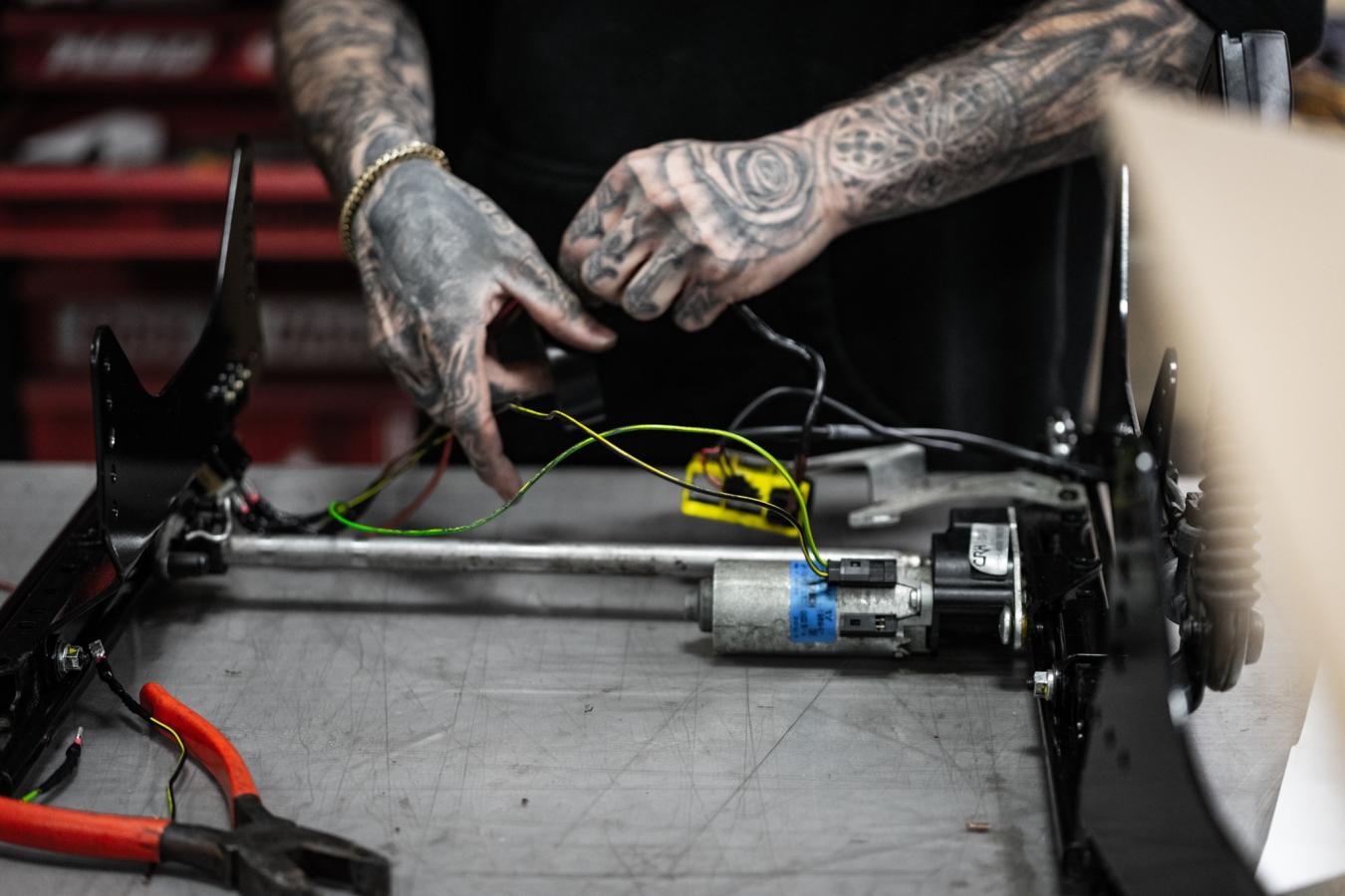

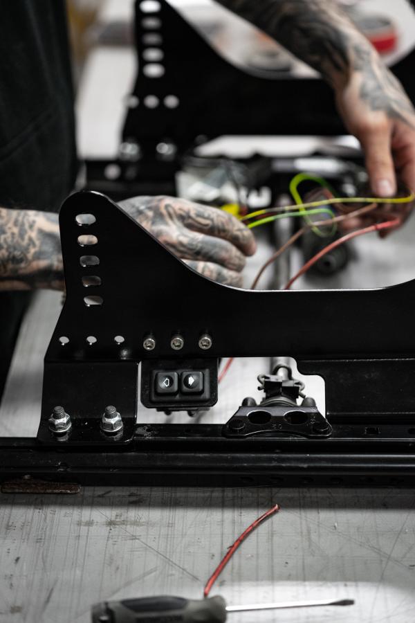

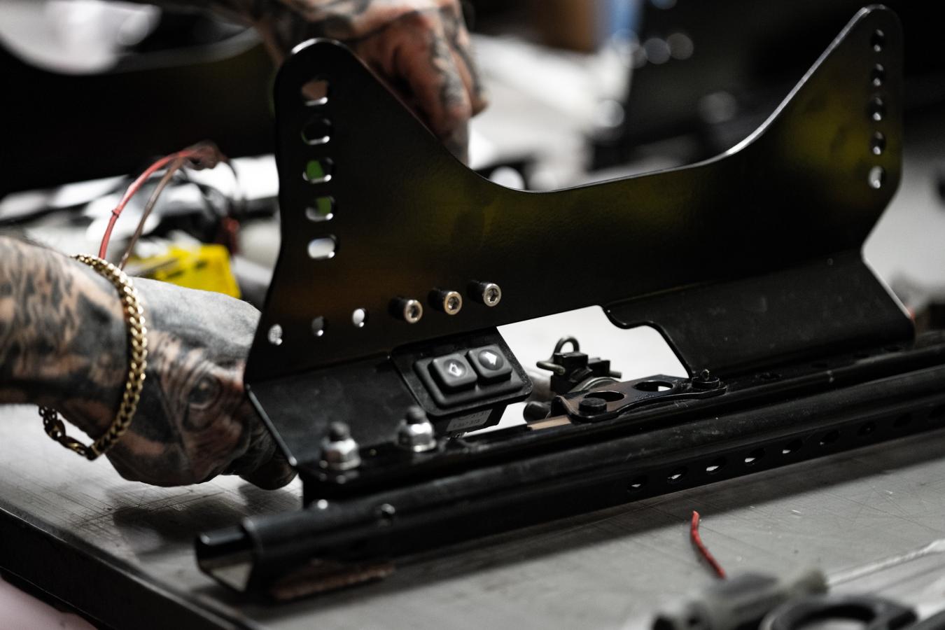

      Follow up question- how did you do the wiring? The sliders I got have everything, but no wiring, so I need plugs and pigtails at the very least.
      The B-K brackets have the wiring pinout for the E30 switch, but the instructions are completely unclear about the actual seat motors- labeled I, II, III and IV.
      Looks like I need to get an E30 pigtail for the window switch and pigtails for the two connectors on the power seat motor in order to make this work. Any advice on sources? I'll be searching on Google, Ebay, etc.

          IIRC the motors only have two wires that matter (the thick ones), and which way you run the current determines which way the motor moves.
          That said, I don't remember how I did the wiring anymore, and my car is on 2x manual sliders at this point.

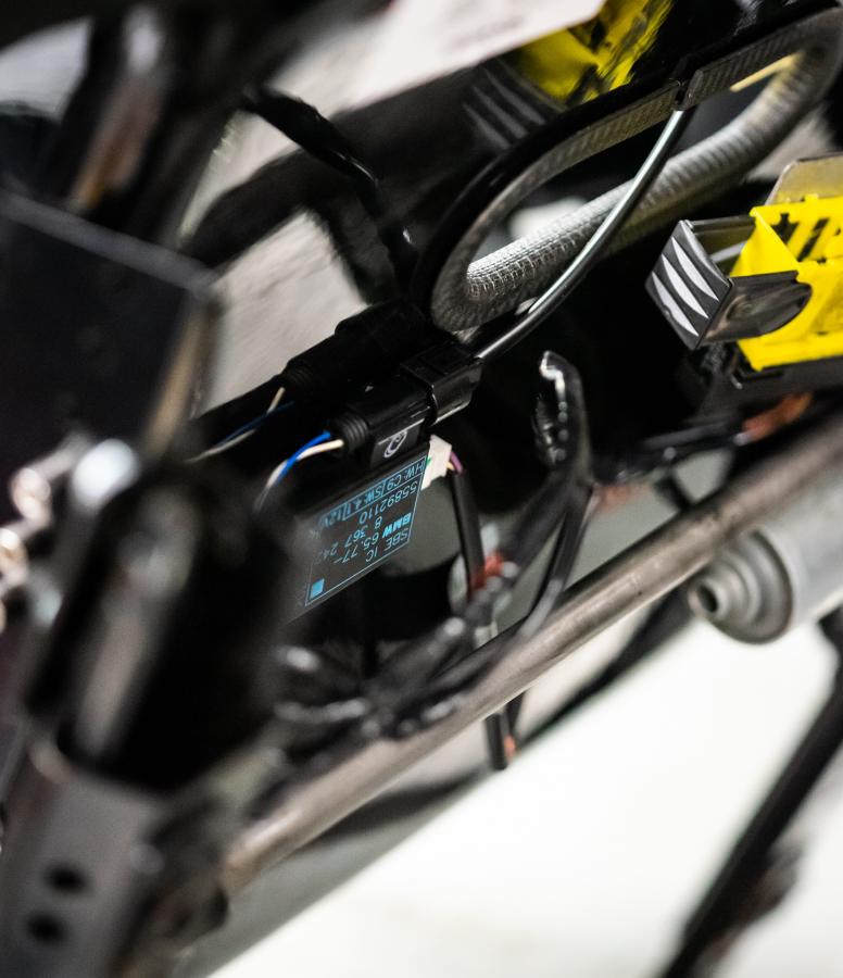

            I just finished wiring my Pole Positions with BK mounts for OE electric sliders. I also fitted a new Airbag Occupancy Sensor.

              Do you have the part numbers for the connectors at the seat motors and for the connector that clips into that big yellow plug?
              Would you know the part numbers for the pins as well?

                I do not. BK provides these with their kit.
