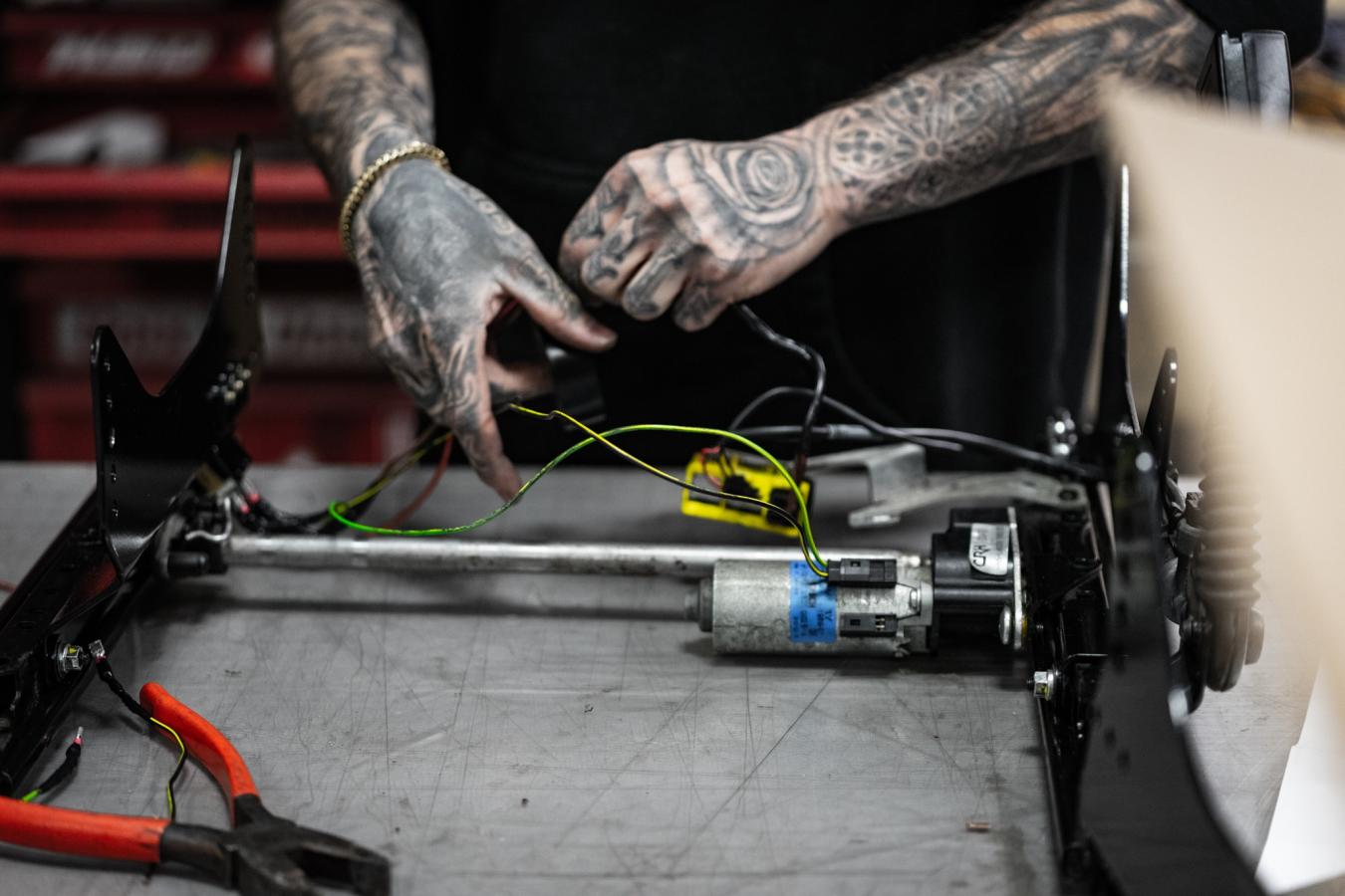

                                I just finished wiring my Pole Positions with BK mounts for OE electric sliders. I also fitted a new Airbag Occupancy Sensor.
                                Do you have the B-K part number for the brackets?
                                I have some Pole Position and a set of manual sliders that I want to put together. Right now I am using fixed Recaro brackets.
                                Thanks!
