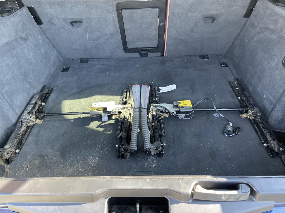

            Found a set of sedan manual sliders at the junkyard today, some motivation to actually do this project (getting Imola Nogaros made by Cobra) over the winter.
                Just FYI. I recently spoke to HMS and they currently have a shipment of Cobra seats on the way. This means you will either have to pay for shipping (which was like $400 per seat) or wait ~6 months to see if they can stuff them in with their next shipment. I would reach out sooner rather than later if you want custom seats made.
