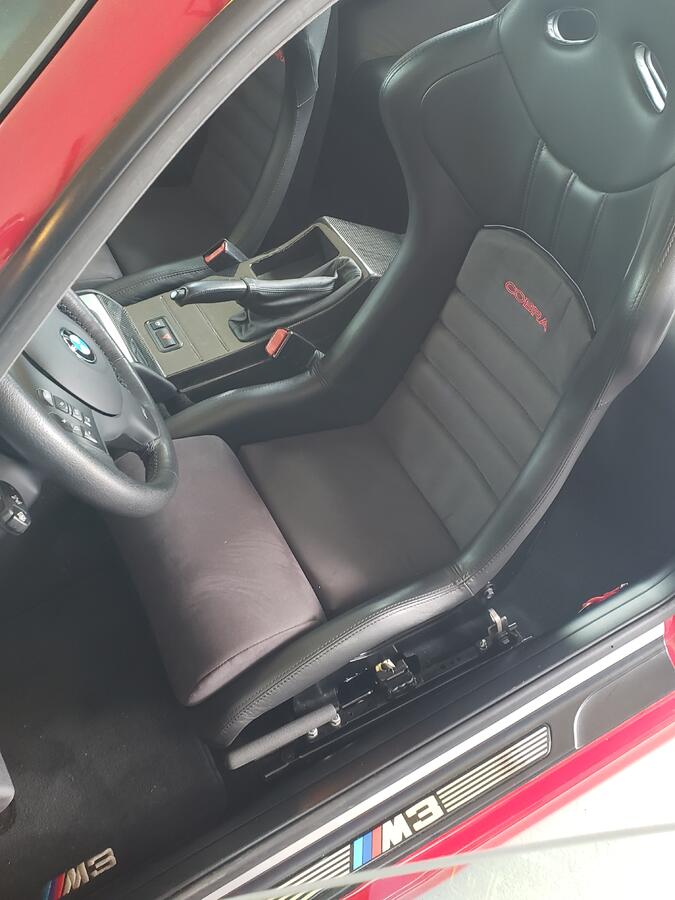

          Above ---- I JUST got around to putting in my Alcantara (fake) Cobra inserts in my seats. Love em ….. also had them do black stitching custom

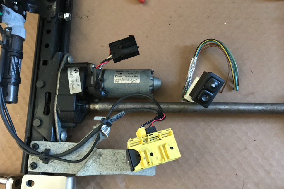

                          Hey obioban - I'm in the process of installing essentially the same Brey Krause setup in my E46 M3, do you have any additional details and/or pictures of the final wiring for your drivers side utilizing the stock power sliders? Surprised more people aren't running this setup and how difficult it seems to be to find info on it.

                            #43
                            The Brey Krause mounts come with instructions, which includes wiring instructions. The only thing I did differently was use the e30 plug instead of the clips they include, but the wiring was the same.
                              #44
                              Yeah I’ll be using the E30 switch setup as well, instructions are alright, figured I’d ask in case you had photos since that always helps 👍🏼
                                #45
                                I can take a picture tomorrow. Need to take it apart again to add the sub strap mount.
