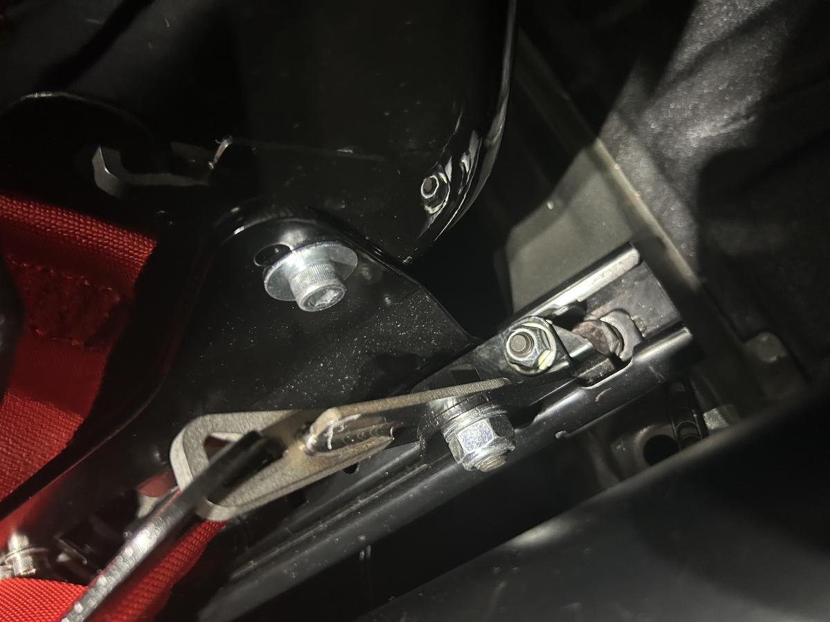

Figured out one major problem that was resulting in a good amount of the “stickiness” — the sub strap bar rubs pretty heavily on the carpet where the chassis bumps out toward the front third of seat travel. It feels a good bit better now after removing the bar and reinstalling the seat with loose fasteners as suggested.

Has your carpet ever been out? I wonder if it’s not seated fully— my BK sub strap has no friction with the carpet.Originally posted by repoman89 View PostFigured out one major problem that was resulting in a good amount of the “stickiness” — the sub strap bar rubs pretty heavily on the carpet where the chassis bumps out toward the front third of seat travel. It feels a good bit better now after removing the bar and reinstalling the seat with loose fasteners as suggested.

I did have it out last year when I removed my nav wiring harness. It seemed seated to me and certainly looks like it’s back in place, but I have the passenger seat out right now and can easily check that side at least next time I work on the car. How much clearance do you have?Originally posted by Obioban View Post

I’ll try to remember to take a picture tomorrow.Originally posted by repoman89 View Post
