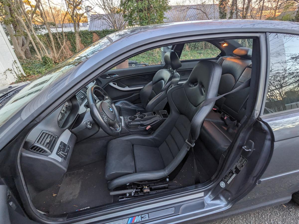

Just installed one of these today and wanted to share the differences featured by a Nogaro ordered from HMS as of late 2024, and my impressions.
Stitching is all-black now, cushion pattern is parallel instead of the previous curves, and the logo has shrunk dramatically. I was told by HMS this was their doing, which is great because it means an off-the-shelf Nogaro now looks a lot better imo, while not needing the cost of a custom seat.
Sitting in the seat in the car, I'm finding that there's what I would describe as "negative" lumbar support. Playing with the seat in my house, I could mitigate this greatly by increasing the amount the seat is reclined. I know heinzboehmer has also tackled this with custom cushions. I'm still pondering my angle of attack here, but would it be ill-advised to potentially add another rear hole to the BK mounts, allowing for more lean-back?Last edited by Pklauser; 01-02-2025, 04:33 PM.

Stock black stitching seems like a good update.
If you look, I suspect there isn’t space under the seat to lower the rear hole. That said, most people recline WAY too much— I bet if you give it a week, you won’t even want to recline it more anymore.

Forgot to mention the cushion pattern/shape changed to be less "curvy" than it was, another welcome change imo.Originally posted by Obioban View PostStock black stitching seems like a good update.
Cobra has an adjustable lumbar pad.
Yea I'll give it some time. Ordered an ebay lumbar pad to experiment. Not ruling out the "official" Cobra lumbar option, but want to try something cheaper first.

Dang it-- any idea if the 'pre-facelift' Nogaro is still available? Was thinking I'd get a matching one for passenger at some point ...Originally posted by Pklauser View PostJust installed one of these today and wanted to share the differences featured by a Nogaro ordered from HMS as of late 2024, and my impressions.
FWIW I like the white/gray stitching though the black is looking good too

Just went for a drive with seats installed as-is. Unfortunately these are putting up a fight with my body. I don't know if I've sat in a less comfortable seat 😂
I'm going to try and describe what I'm feeling in case it helps anyone considering these seats:
It's not that the angle between the seat base and back is too upright, it's that the seat back has a curve to it. If you looked at the seat from the side you'd see a profile like: _). I find my lower back is collapsing into that curve, and my upper back is being pushed forward. I'm basically being forced to slouch. I think the lumbar support will help part of this problem, but then it will net out that I'm still too far forward.
It looks like there is room underneath the seat to recline it further, granted that will move my head down vertically. I may give this a shot as an attempt to better support my thighs, while also mitigating it feeling like my upper back is being pushed so far forward. Ideally I would add a mounting hole to the front of the mounts to raise the front instead of lowering the rear, as my substrap is also interfering some with my carpet like repoman89 , but alas there is not enough material left in the mounts to add a hole there.
To credential myself slightly: I race in Champcar in a Racetech seat of some form mounted in an E36 without sliders. I drive 2 hour stints with less discomfort in that seat than I had in the Nogaro after 20 minutes driving around town. This isn't me bashing the seat, as they're so subjective, but pointing out that I do have some understanding of fixed-back seats and my body.Last edited by Pklauser; 01-03-2025, 08:00 AM.
I think most bucket seats are shaped like that, even the OE Porsche LWBS. FWIW I’ve found every fixed back seat I’ve run uncomfortable until I added lumbar support. With lumbar support I can drive for hours without any problems, while I struggled with OE seats even with lumbar. Wing supports pushing shoulder forward is just something you have to get used to, and if you have your seat positioned right, your shoulders should curve anyways when holding the wheel at 3 and 9 o’clock. These are features of a fixed back racing seat, and the Nogaros are essentially racing seats designed to be more street car friendly.
Body shape and size is also important obviously, hence why it’s a good idea to try and sit in a seat before buying. Sparco, Cobra, Racetech, and Recaro FIA seats fit me well, while Sabelt seats are meh and OMP seats are terrible. I was worried about Nogaros working for me, and thankfully BTB let me sit in his. I’m a midget at 5’7 160-170ish lbs with wide shoulders and a natty bodybuilder shape (cuz that’s another overpriced hobby of mine).
Cobra and HMS are very flexible, so I’m sure you can order the old style center cushions.Originally posted by BTB View PostDang it-- any idea if the 'pre-facelift' Nogaro is still available? Was thinking I'd get a matching one for passenger at some point ...
FWIW I like the white/gray stitching though the black is looking good tooLast edited by SQ13; 01-03-2025, 08:50 AM.
- Likes 1
Lol our Champcar cars also have a Racetech halo seats, and we go for two hour stints as well. They make the most comfortable seats out of the box imo. I think before you do anything else, add something in the lumbar are behind the cushion to see if that helps. Foam, bubble wrap, paper box stuffers, whatever you have on hand.Originally posted by Pklauser View PostTo credential myself slightly: I race in Champcar in a Racetech seat of some form mounted in an E36 without sliders. I drive 2 hour stints with less discomfort in that seat than I had in the Nogaro after 20 minutes driving around town. This isn't me bashing the seat, as they're so subjective, but pointing out that I do have some understanding of fixed-back seats and my body.
