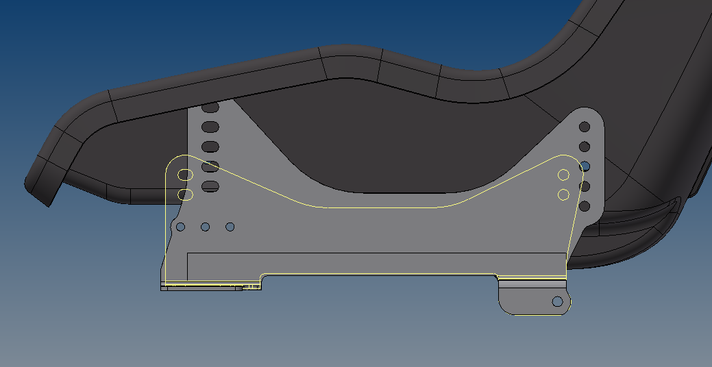

            Update on the nogaros: I reached out to Brey Krause to see if there was any reason I couldn't run their non-cobra-specific seat mounts: R-9222 with the nogaros to get some height. Huge credit to them, I got a prompt email back from an engineer:
            The R-9223 will indeed work with the Nogaros. These can raise it up to 1.25” above the Nogaro specific brackets although, it does lose most of the rake at max height. Attached is a screenshot comparing the two with the Nogaro specific brackets being transparent and outlined in yellow. The way the brackets are arranged, that third rear mounting hole from the top is the lowest it will go, without some possibly excessive rake, before the forward mounting pattern interferes with the seat.​
            I've since put these mounts in on the driver's side, and been playing with the different hole options. Starting with the highest hole in the front, and two holes down in the rear was actually too much recline, and too high up in the front for me. Now I've settled on second from the top on the front, and third from the top in the rear and am much happier than I was with the nogaro-specific mounts. I also sit at imo a much more reasonable height.

              Fucking A, I'm grabbing a set of these ASAP, tired of sitting on a folded up towel.
                Ha. Being 6'4, at least in the morning, actually fitting in a car for the first time in my life is one of my favorite things about these seats.
                  At 5'9 I can barely see the power bulge at this point even with extra foam stuffed into the cushion and a towel on top of the cushion. I am excited to try these different mounts ASAP.

                    I think you'll be real happy with them then!
                    Having mine slightly more reclined is way more comfortable for me. Downside is that backseat access is even worse, and it was already bad.
