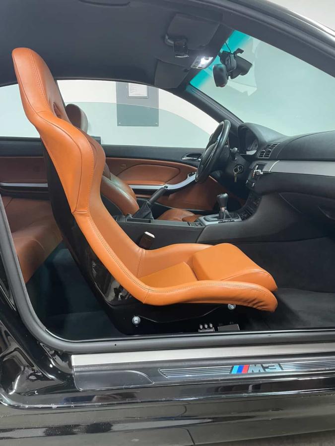

    '01 M3, Imola/black
      I got a power bulge you can see right here
      I can see that power bulge from a mile away
        I drove the car today and turns out I was tripping, I can totally see the hood from my seating position after all
          Cobra Nogaro paired with this steering wheel spacer have made a world of difference for me at 6'5.5". Headroom was never much of an issue (car is a slicktop), but there's tons of room now, even with helmet. It feels very 'rally car' being low down with steering wheel ~2" closer to chest. Also gives more room for knees

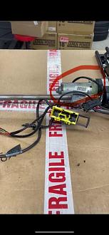

                      Finally got around to installing the passenger side. The BK R-9224 mounts now come with 2holes (2 in the front and 2 in the rear). The rear bottom hole wasn’t an option, as it causes the bottom of the seat to hit the motor.
                      The top 2 holes are my only choice. Seat feels great otherwise - just wish it could be lower…barely feels lower than stock.​

                        Did you try the upper hole in the front and lower in the rear? Lowers the seating position while slightly reclining the seat into a more comfortable position, in my opinion.
                          That was the original plan (edited my original comment to add that in). Using the lower rear hole, the seat bottom would hit the motor regardless of which front hole I choose.
                          Surprisingly, even with only using the top holes there’s a noticeable recline. My only complaint is that it’s not as low as I thought it would be.
                            Originally posted by Toby22 View Post
                            That was the original plan. Using the lower rear hole, the seat bottom would hit the motor regardless of which front hole I choose.
                            Interesting, I am using sedan manual seat rails, looking closer at your photo do have have the power rails? They sit lower I do believe.
                            You could try the R-9220 mounts as well, they work and may give you more options. I would contact Brey Krause about that to be sure.
                              Correct, it’s powered. I’ll definitely reach out to BK.
                              I just don’t see how I can get the seats lower. As long as the motor is there, the seat bottom will come in contact with it if I go any lower - regardless of which mount I go with.

                                The farther rearward (like the factory is) that the seat is mounted on the brackets, the more clearance you get underneath because of the rake angle of the seat. I found the same issue when I purchased BK mounts for Recaros - they mount them too far forward so that there’s no motor clearance. The solution is custom brackets.
