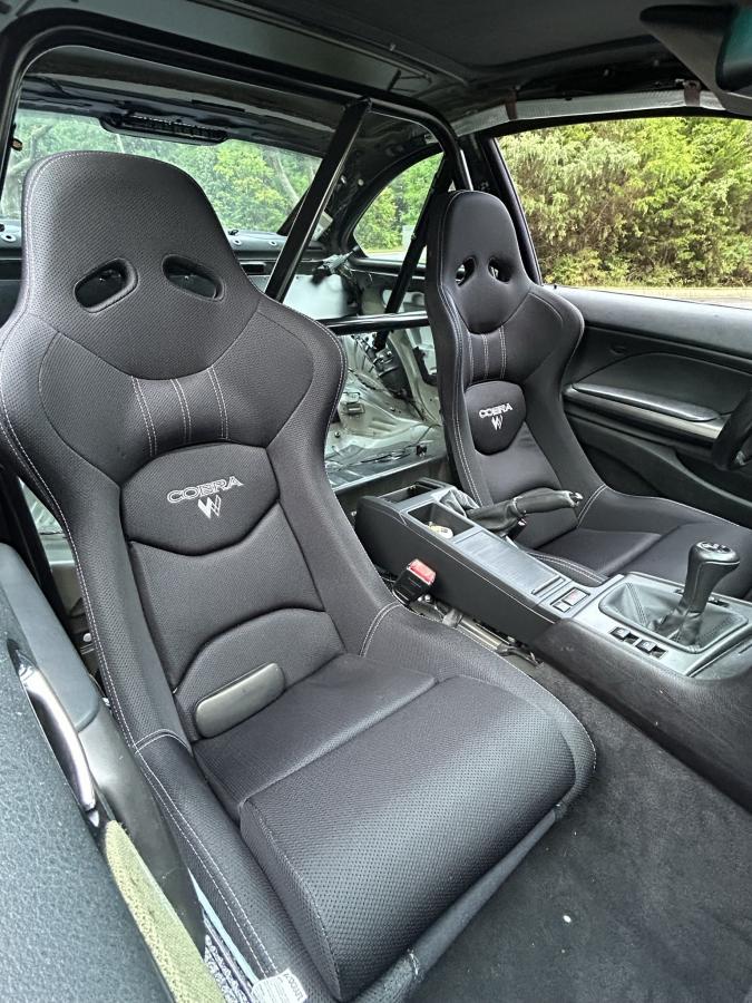

              The project to setup and install Cobra Nogaros with BK mounts on OE power sliders urned out fairly well. There were some surprises during install, especially learning the seat is not precisely centered on the steering wheel. I've already grown accostomed to it. I think I will start up a new thread with only information on the install. This one was so long to review I lost track of the details.

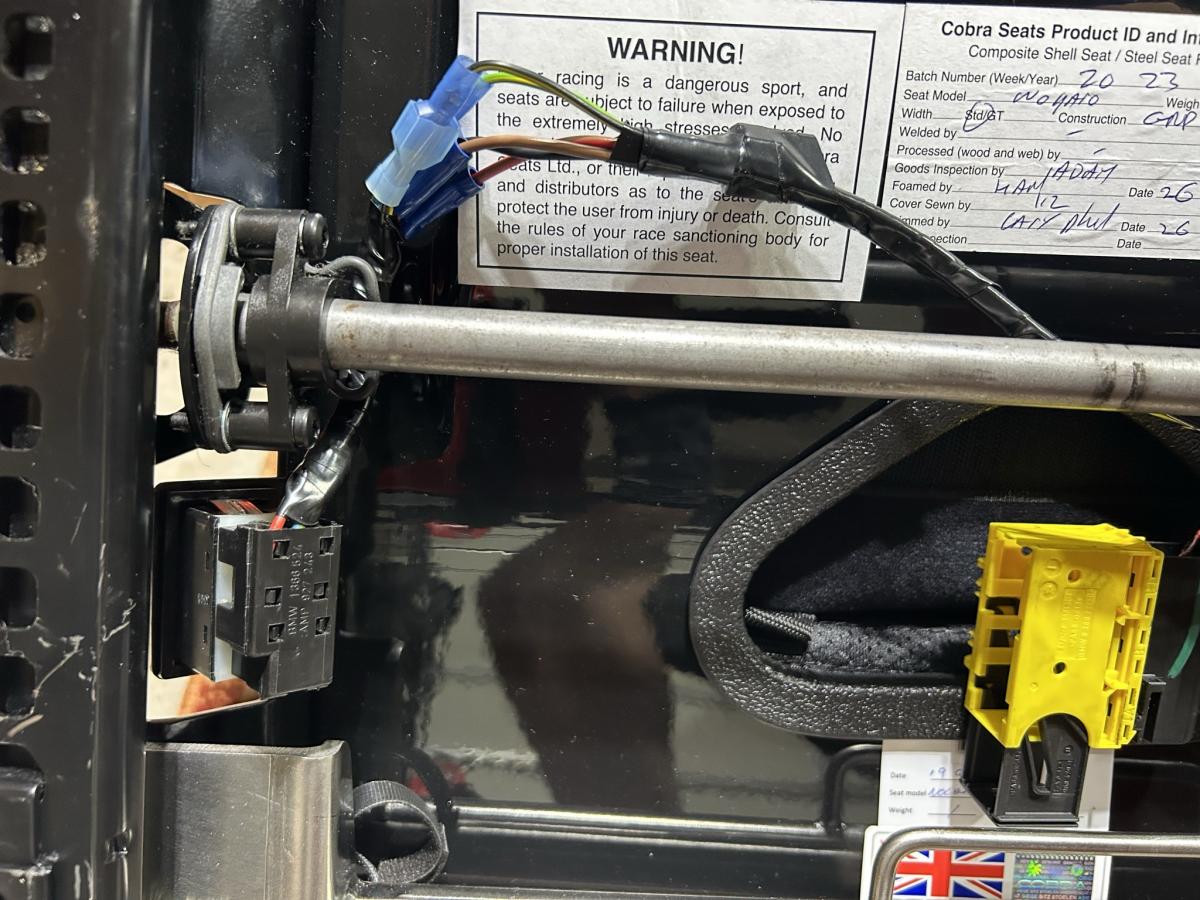

                    At least this time around I figured out how to keep the little yellow plug holder, always bothered me that the plug was just floating around under there.
