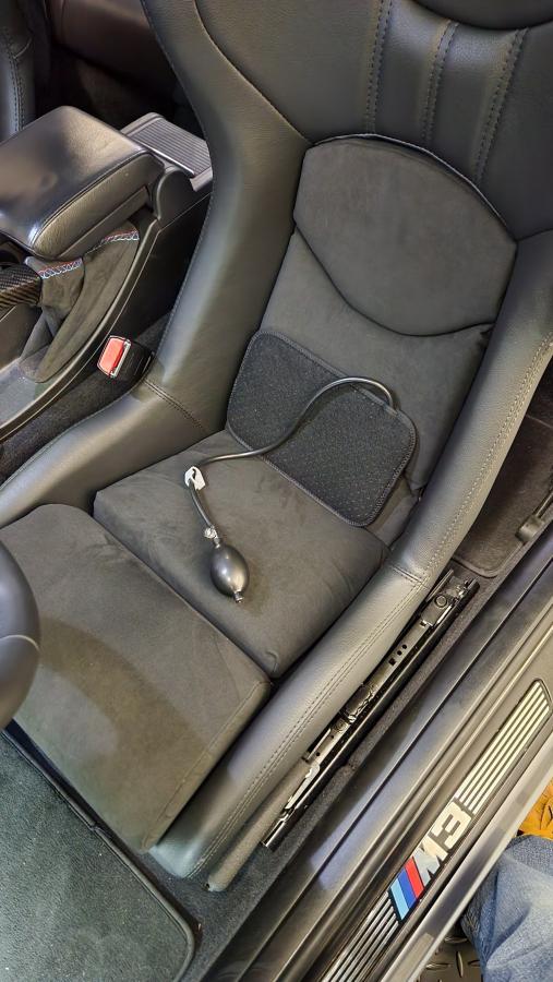

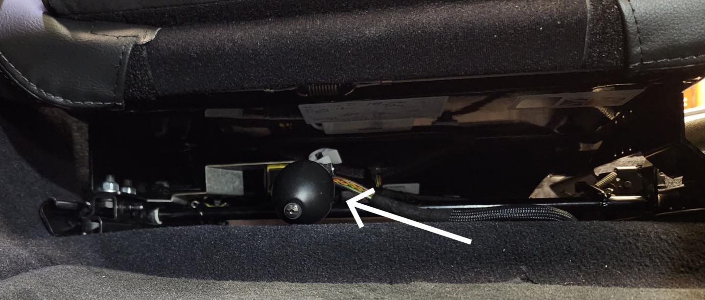

          Using a $25 eBay lumber bag worked out well, unfortunately the line isn't long enough so the pump (or "nutsack") is under the seat and cannot be pumped up while driving, oh well.
          Well worth it, and well worth the $125 savings vs. the Brey Krause lumbar bag even if the BK bag had a longer line or lasts longer the price difference is massive.
            Click image for larger version Name:	20230210_220453.jpg Views:	0 Size:	75.4 KB ID:	205011 Click image for larger version Name:	20230210_221652.jpg Views:	0 Size:	60.9 KB ID:	205009 Click image for larger version Name:	20230210_221544.jpg Views:	0 Size:	108.6 KB ID:	205008
            I bet you could extend the tubing. I was looking at the Corbeau lumbar support. $55 and the line should be long enough to reach the front.

              That would likely work, one could just coupler a longer piece in, not like it's some crazy amount of air pressure.
              I'll try that and report back, if the $25 bag could be made better with another $5-10 in tubing/coupler and it lasts a decent amount of time seems like a no brainer to me
                  Ha, awesome. Pretty sure I bought the same exact thing as you: https://nam3forum.com/forums/forum/m...244#post204244 Has worked well for me.

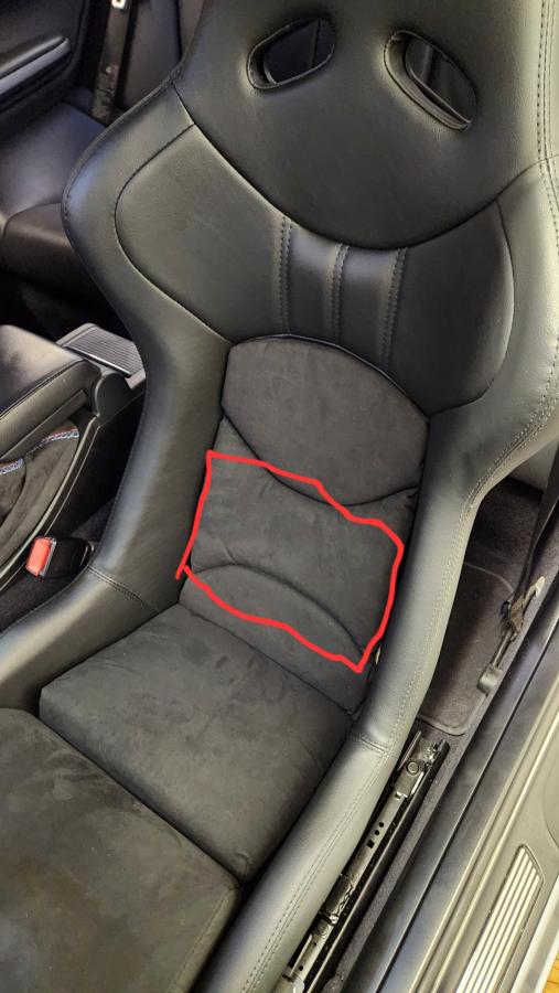

                  I've got my nuts stashed under the seat as well. Don't really find the need to mess with it too much while driving. If I feel like I need more/less support, I can always pull over and mess with it.
                    On my, you really did an awesome job there, I just threw my bag behind the seat back padding as it came out of the box. I gotta sit down and read your journal, very neat stuff going on.

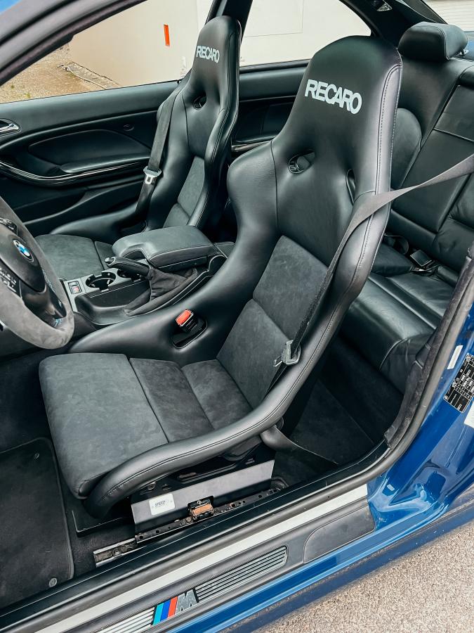

                          Hello,
                          i have the same exact setup, PP ABE with speed engineering side mounts and OEM manual rails.
                          Yes it is true that sedan(not sure about touring) sliders have longer travel than coupe sliders, so for rear seat accessibility sedan sliders are your choice.
                          As for the seating height. I am 178cm and with middle seat height setting, I sit way lower than OEM seat with one spare height setting I can go further down(another 2cm). Even I have sunroof car, there is still exactly 10cm above my head(I measured that).
                          There is like 5cm of space under the bottom of the seat and floor.
                          see picture of setup below
                          hope this helps a little bit
                            I need to get a set of the speed engineering mounts to replace my BK ones. They look much higher quality.
                              i agree they are very well built, they are made of thick 4-5mm steel so not particularly light, but I guess it’s for the safety… the whole assembly with seat and sedan rail weights 14,7kg/32,5lbs. They sell them on burkhart so I guess they could ship anywhere
