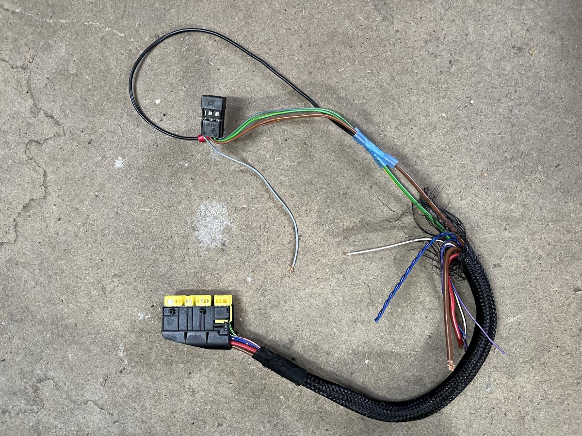

                      e39 elements are electrically compatible but use different pins and plugs from the e46. You’ll need to splice or re-crimp and re-pin the connectors from an e46 donor harness. I’m deep in the aftermarket seat heating wormhole right now and have both a breakout harness and the e39 elements on the bench for diagnostics. Make sure you get positive-negative wiring correct or the buttons won’t work correctly.

                          I'll probably just get the part # on my factory seats, order that (used), thin down the harness/splice and re-tape.

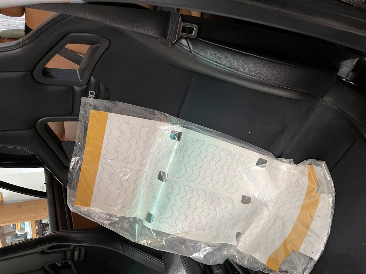

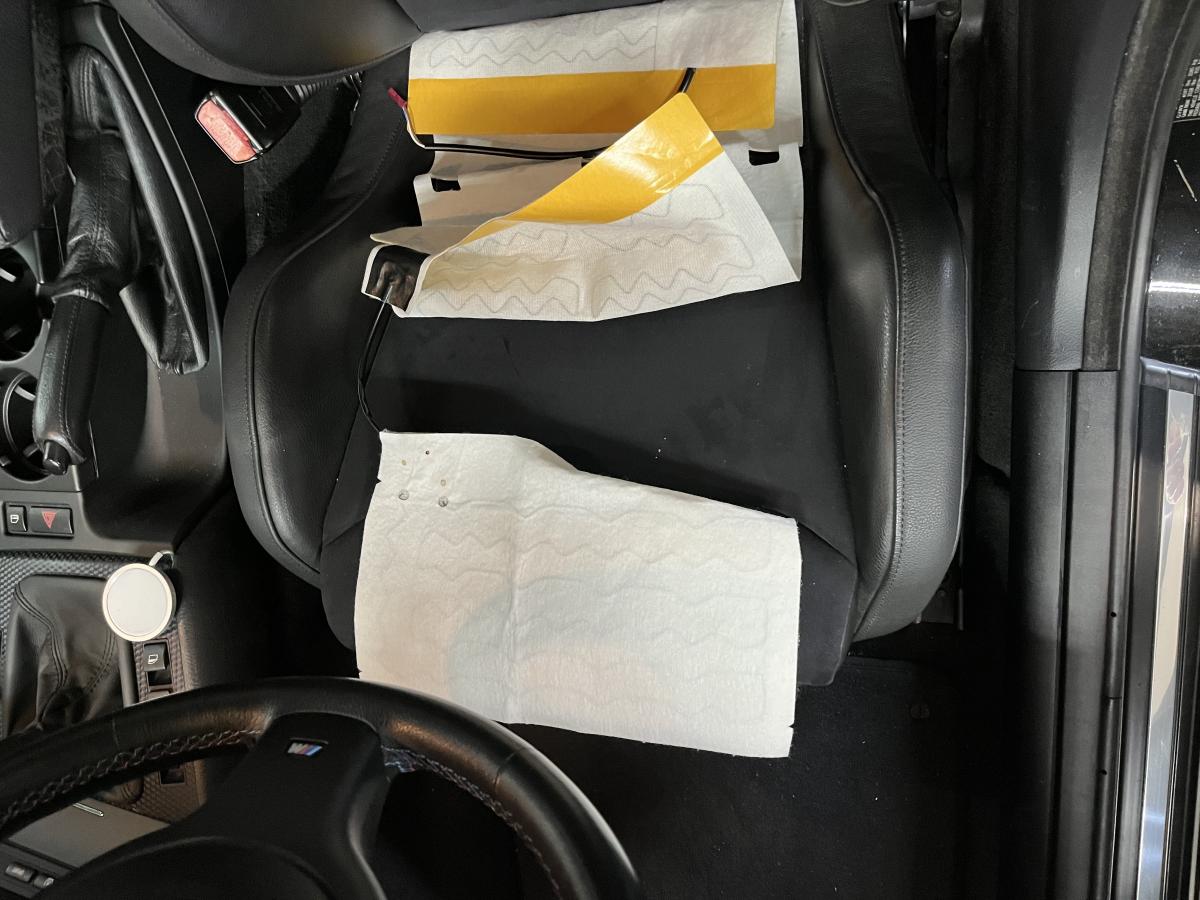

                              I just bought some used manual heated seats and extracted the sliders, wiring harness, and heat pads.

                                Splicing a couple wires is (personal judgement) about 100 times simpler than stitching in elements (and I’d argue safer). With the orderable e39 elements, you don’t get hip or waist heating like with the e46 seats, but it’s about the simplest integration you can make. But the hip and waist heat hug is nice..
