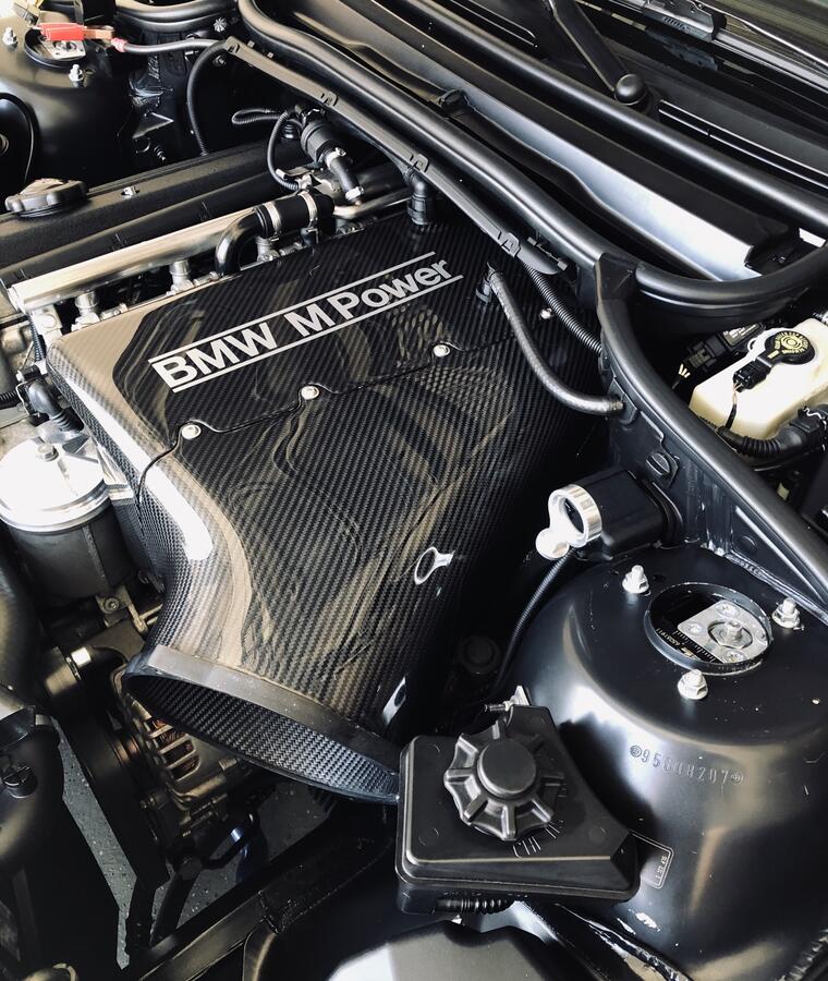

        +1 on the shutoff valve. Cut it after it goes through the grommet and it makes the curve. Remove the hard line from the male connector that goes to the airbox. Then install soft line in between. On the breather hose that has the solenoid to the top of the valve cover I just did the same but like he mentioned above you can just get the CSL and remove the solenoid and cap the air rail.
