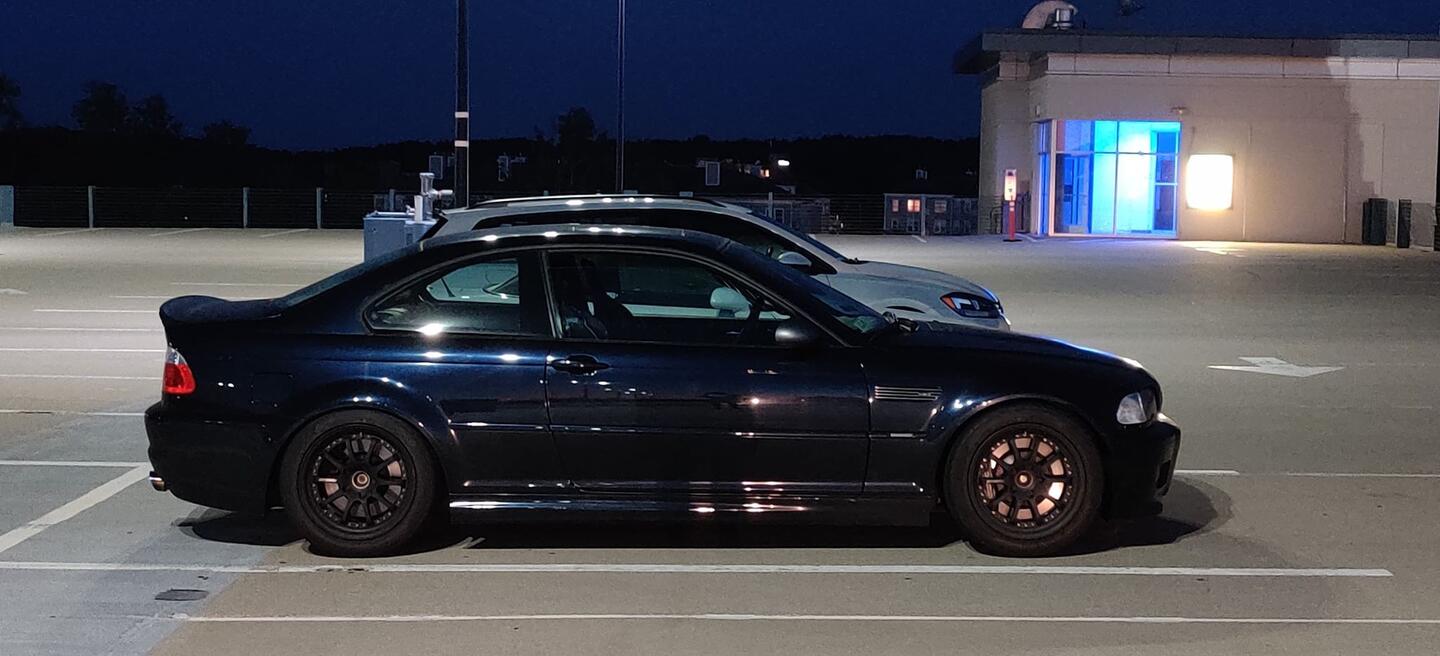

    If you have them handy be sure to post your alignment specs.
    How/Where I Drive: spirited driving on the streets
    Ground Control Street Coilovers (koni/eibach)
    Front:
    Apex ARC-8 19x9 et 28
    Michelin A/S 3+ at 245/35/19
    Camber: 2.0 degrees
    Rubs: No
    Spacers: None
    Springs: 6" 500 lbs Eibach (I wish I had known about flat ride, will adjust at some point)
    Camber Plates: Ground Control
    Ride Height: 13.35 inches (from center of wheel to fender arch)
    End Links: Ground Control
    Control Arm: OE
    Sway Bar: OE
    Tie Rods: OE
    FCAB: OE
    Brakes: OE
    Rear:
    Apex ARC-8 19X10 et 25
    Michelin A/S 3+ 275/30/19
    Camber: 1.8 degrees
    Rubs: No
    Spacers: None
    Springs: 6" 600 lbs Eibach
    Ride Height: 13.25 inches (from center of wheel to quarter panel arch)
    End Links: OE
    Ball Joints: OE
    Bushings (except RTAB): OE
    Sway Bar: OE
    ARCAs: Ground Control Monoball
    RTABS: CMP Monoball
    Subframe: CMP Solid
    Brakes: OE
    Add a picture if you can!

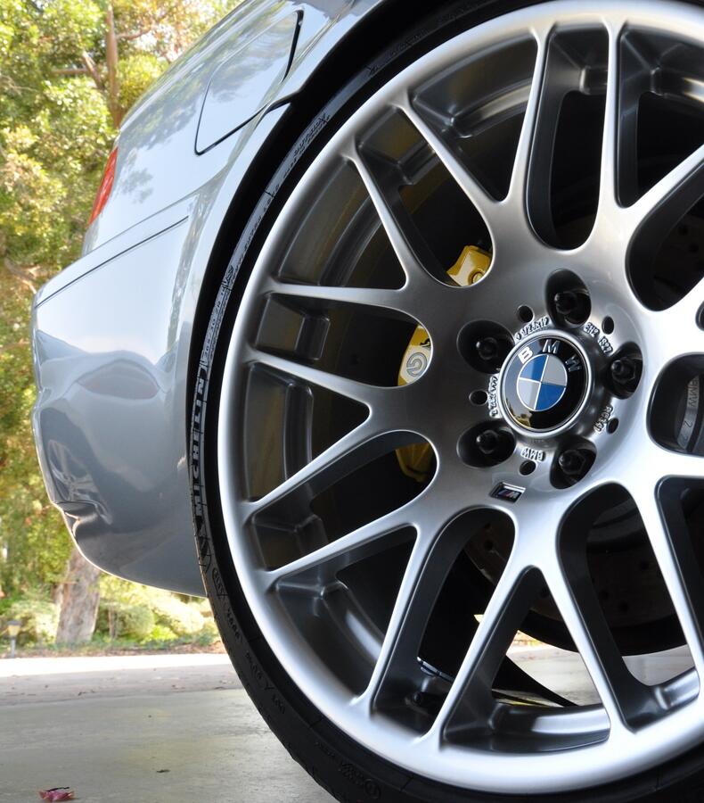

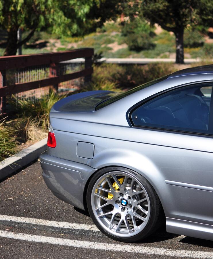

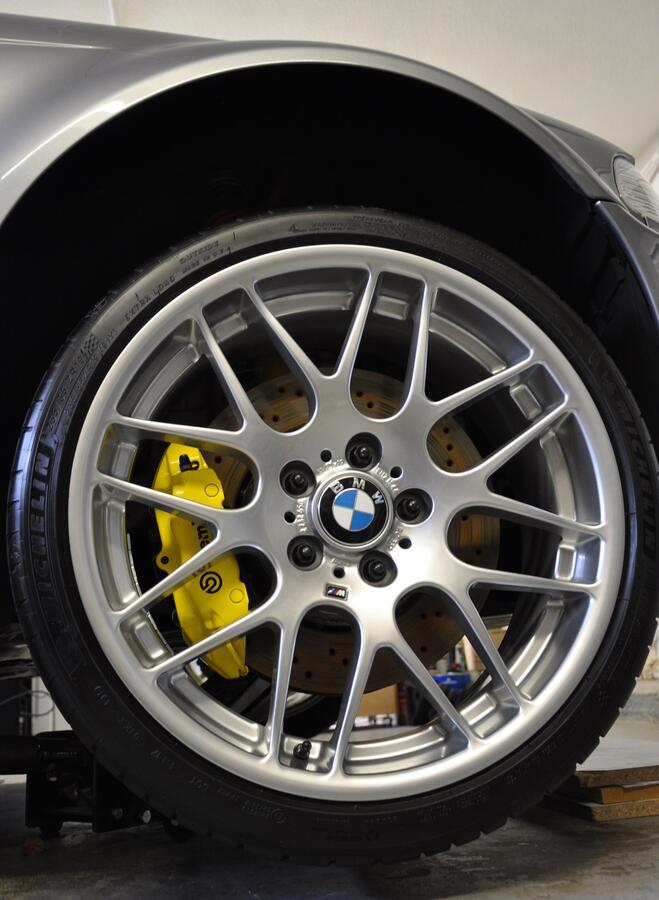

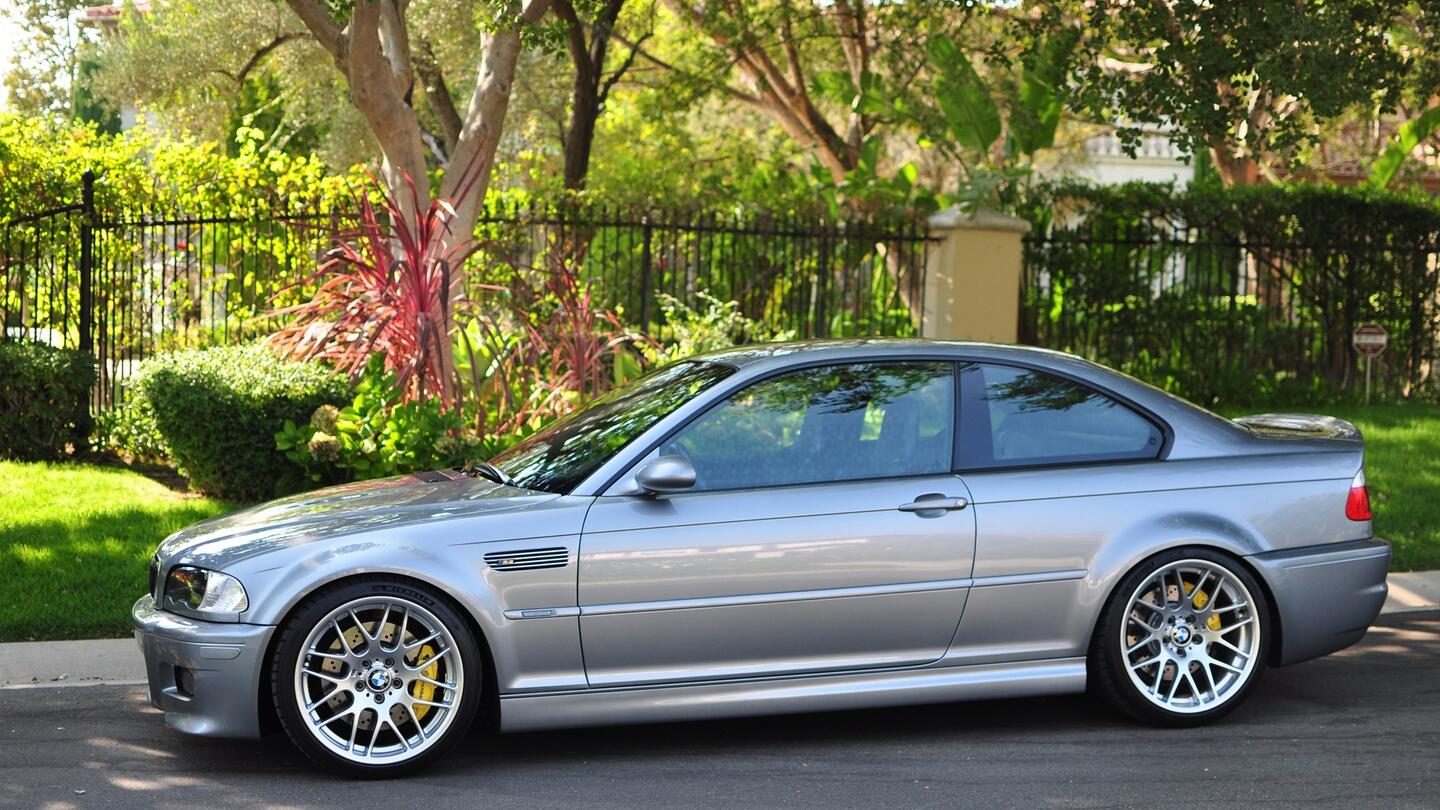

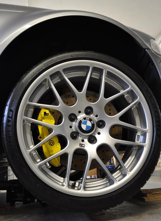

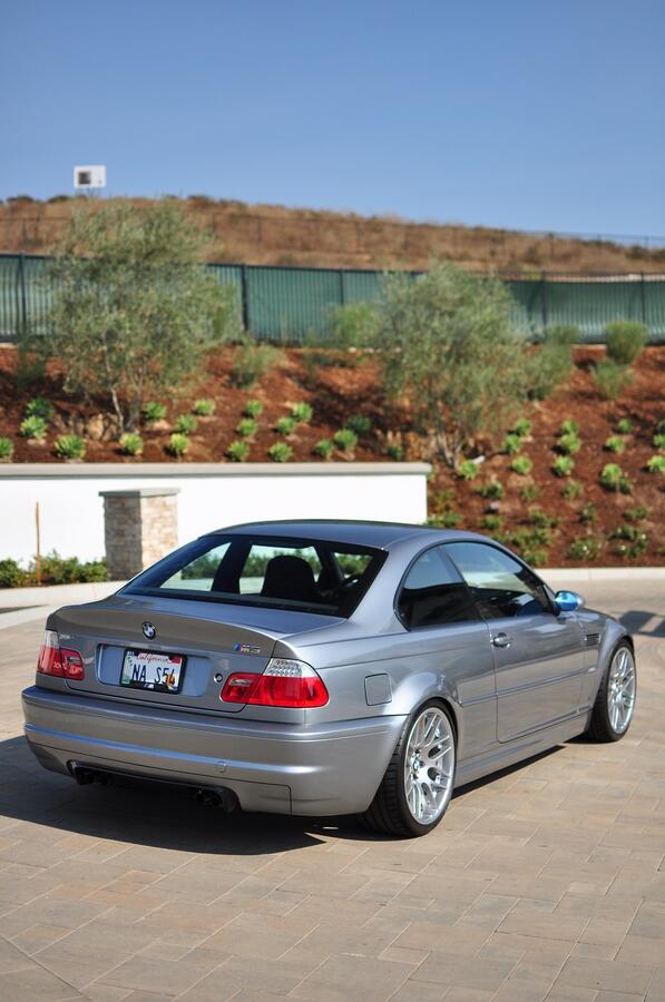

          Street/Cyn
          Front:
          OE CSL 19" x 8.5 et44
          Michelin PS4S 235
          Camber: -3 degrees
          Rubs: No
          Spacers: 15mm
          Dampers: Bilstein B6 w/ GC 2.5" perches & cut off 7/8" of bump stop
          Springs: 7" 325lbs 2.5" Eibach ERS
          Camber Plates: TMS street - gives me extra 7/8" of travel
          DMG strutbar
          Ride Height: 13.375 inches (from center of wheel to fender arch)
          End Links: OE
          Control Arm: OE
          Sway Bar: Hotchkis (Med)
          Tie Rods: OE
          FCAB: OE
          Brakes: Porsche Brembo 996, Textar pads
          Rear:
          OE CSL 19 x 9.5 et27
          Michelin PS4S 265
          Camber: -2.5 degrees
          Rubs: No
          Spacers: 5mm
          Dampers: Bilstein B6 w/ GC shortened bumpstops & GC "tall" RSMs - raises droop more than an inch
          Springs: 6.5" 550lbs GC Eibachs, GC top cones, oe rubber bottom pads
          Ride Height: 12.875 inches (from center of wheel to quarter panel arch)
          End Links: OE
          Ball Joints: OE
          Sway Bar: OE
          Added rear strut bar
          ARCAs: Eibach aluminum
          RTABS: Syncro Design Works
          Brakes: Porsche Brembo 996, ATE pads/fluid
          Toe out up front, toe in rear
          Pics:

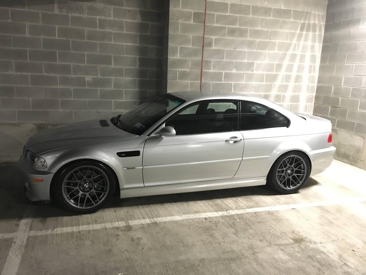

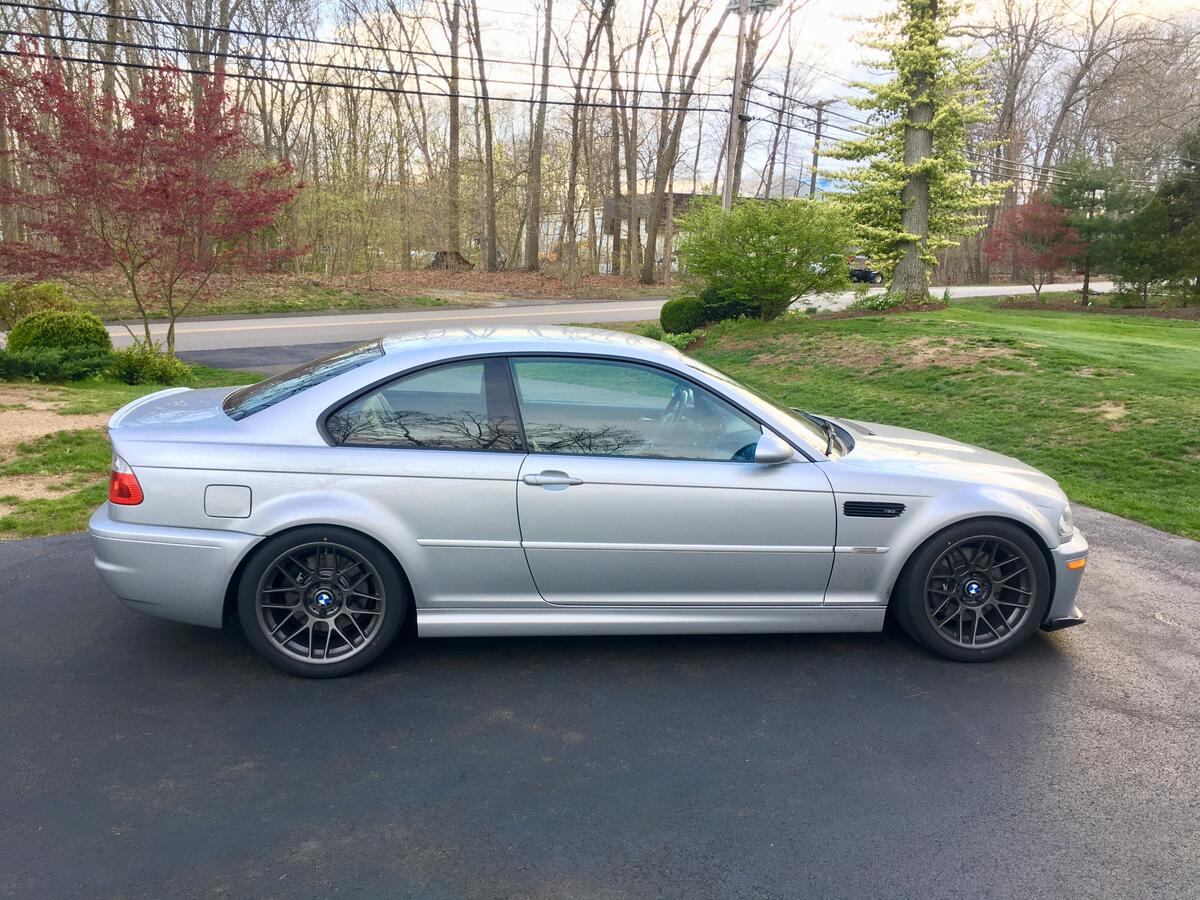

            Driving spans baby hauling to track days
            Front:
            ARC8 18x9.5 et35
            Michelin PS4S 265
            Camber: -2.8 degrees
            Rubs: No
            Spacers: used to run Apex 3mm when had worn wheel bearings to clear tire to Ohlins strut clearance
            Dampers: Ohlins DFV, Ohlins bottom spacer (3dmmotorsport)
            Springs: 7" 375lbs Hyperco
            Camber Plates: GC street, OE strut tower reinforcement plate
            Stock front strut bar
            Ride Height: 13.5 inches (from center of wheel to quarter panel arch)
            End Links: OE
            Control Arm: OE
            Sway Bar: TMS (Soft)
            Tie Rods: OE
            FCAB: OE
            Brakes: ST40 355x32, PFC08 pads, RBF600 fluid
            0 toe
            ZHP steering rack
            Apex 75mm stud conversion
            Rear:
            ARC8 18x9.5 et35
            Michelin PS4S 265
            Camber: -1.8 degrees
            Rubs: No
            Spacers: Apex 12mm
            Dampers: Ohlins DFV, Garagistic shock tower mount reinforcement plate
            RSM: GC street
            Springs: 5" 672lbs Swift, Rogue Engineering upper control arm reinforcement plate
            Ride Height: 13 inches (from center of wheel to quarter panel arch)
            End Links: OE
            Ball Joints: OE
            Sway Bar: OE
            ARCAs: stock salad tongs, eccentric bolt maxed out for camber
            RTABS: Rogue Engineering
            Brakes: stock calipers/rotors, PFC08 pads, RBF600 fluid, brass bushings
            1/8 total toe in
            CMP topside beam with front extension welded in (no shock tower bar)
            Car in pic loaded for a road trip, so sits a bit lower.

                              How/Where I Drive: daily driver. mostly highways and around town with occasional mountain cruises
                              JRZ RS1 single adjustable
                              Front:
                              Volk Racing G2 18x9.5 +35
                              Continental ExtremeContact Sport 265/35-18
                              Camber: 2.5 degrees
                              Rubs: No
                              Spacers: 5mm
                              Springs: 6" 450 lbs Hyperco + Hyperco helper Spring
                              Camber Plates: Ground Control Street
                              Ride Height: 13.5 inches (from center of wheel to fender arch) (need to reconfirm this)
                              Control Arm: OE
                              Sway Bar: OE
                              Tie Rods: OE
                              FCAB: OE
                              Brakes: OE (StopTech BBK soon)
                              Steering rack: Z3 linear rack
                              Rear:
                              Camber: 1.8 degrees
                              Rubs: No
                              Spacers: 12mm
                              Springs: 5" 550 lbs Hyperco + Hyperco helper spring
                              Ride Height: 13.25 inches (from center of wheel to quarter panel arch) (need to reconfirm this)
                              End Links: OE
                              Ball Joints: OE
                              Bushings (except RTAB): Turner Motorsport spherical upper inner
                              Sway Bar: OE
                              ARCAs: Turner Motorsport Street
                              Brakes: OE
                              pardon the peeling clearcoat 😥
