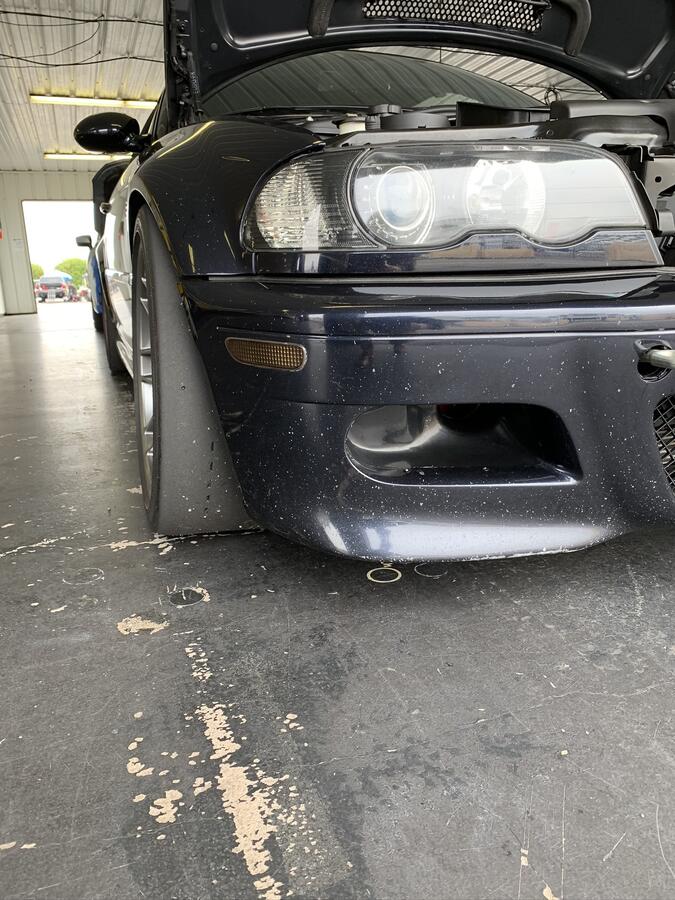

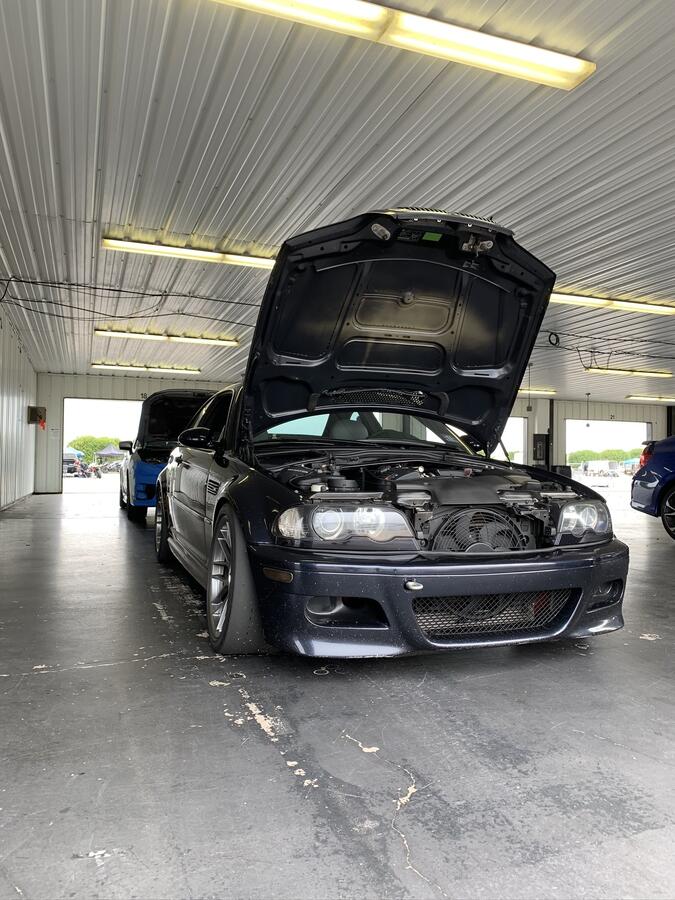

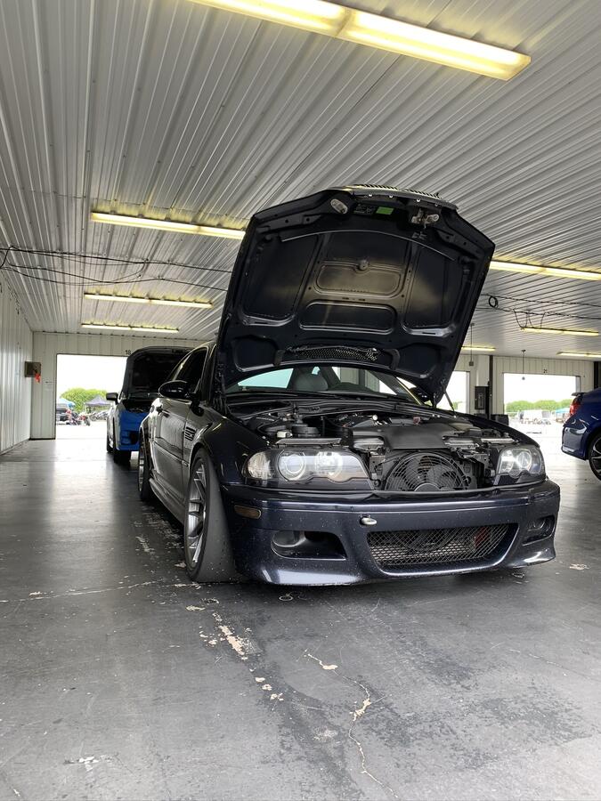

                    I added a pic to the original post and a request for people to add their pics.
ID:	88587 Click image for larger version
ID:	88588 Click image for larger version

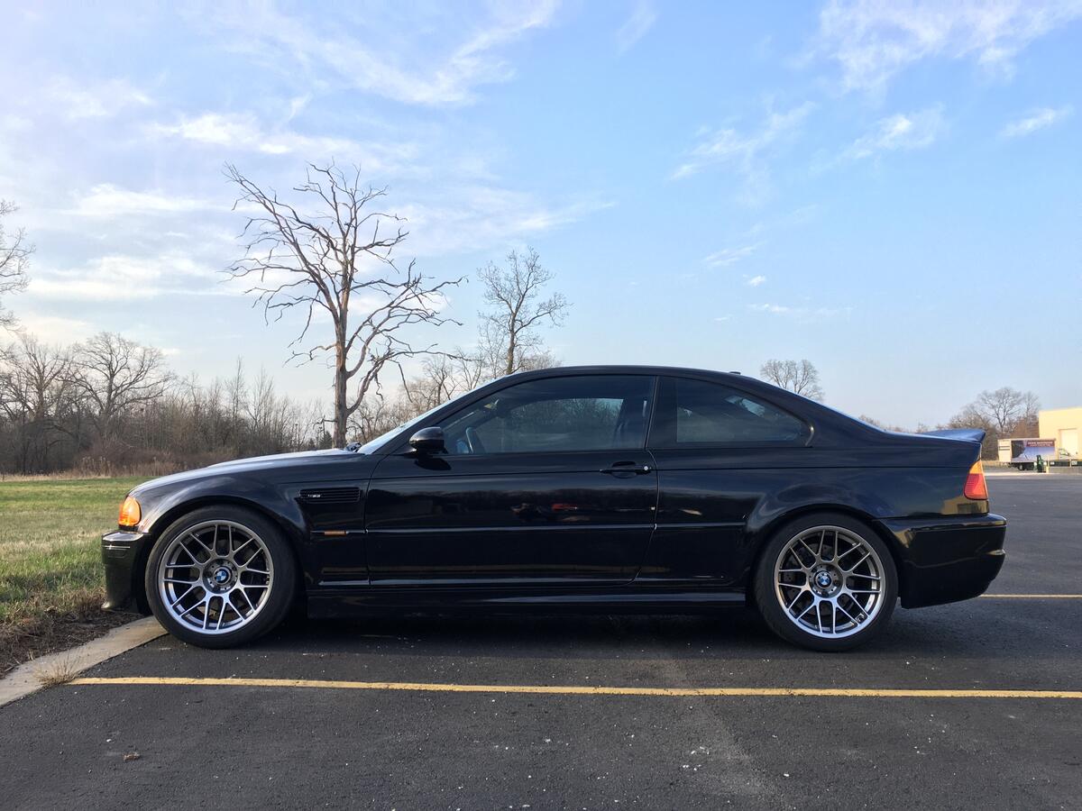

                              Notes: Car is stupid flat in the corners and absolute Nirvana on track (epic track bros: take a seat, this is relative to my humble vehicular experiences). Driving on bumpy midwest roads is tolerable sometimes and makes me want to sell the car at other times. I will be running much softer spring rates in the next week or two since I value getting out and enjoying the car as much as possible and a softer ride should help with that. If I lived in a place with excellent roads I might only change the rear dampers to a Koni DA as I feel the SAs are slightly underdamped.
                              How/Where I Drive: Commute like an a-hole, 1 track day/year
                              How long have you ran this setup: 3 years, 12,000 miles, 5 track days between myself and the PO
                              Ground Control Coilovers (Koni SA/Eibach)
                              Front:
                              Apex ARC-8 18x9.5 ET22 Hyper Black
                              Hankook RS-4 265/35-18
                              Camber: 3.1 degrees
                              Rubs: Very minimal on fender plastics when there is a lot of steering angle. Eventually it will work itself out.
                              Spacers: None
                              Springs: 6" 525 lb/in Eibach. I will soon be changing to 375 lb/in because I believe I will enjoy commuting more on these horrendous midwest roads.
                              Camber Plates: Ground Control
                              Ride Height: 13.75 inches (from center of wheel to fender arch)
                              End Links: Ground Control adjustable
                              Control Arm: OE
                              Sway Bar: Ground Control adjustable
                              Tie Rods: OE
                              FCAB: Bimmerworld TrackCAB
                              Brakes: PFC Direct Drive rotors, PFC Z-rated pads (street) PFC 08 pads (track)
                              Rear:
                              Camber: 2.4 degrees
                              Rubs: No
                              Spacers: None
                              Springs: 7" 650 lb/in Eibach (switching to 430 lb/in)
                              Ride Height: 13.38 inches (from center of wheel to quarter panel arch)
                              Ball Joints: OE
                              Bushings (except RTAB): Bimmerworld Spherical
                              ARCAs: Ground Control Monoball
                              RTABS: Bimmerworld
                              Subframe: Bimmerworld Solid alum.
                              Brakes: PFC Z-rated (street) PFC 332 pads (track)
                              Click image for larger version  Name:	16FE2B3C-FADA-47DD-9332-796D5455EE1C.jpeg Views:	0 Size:	131.6 KB ID:	97131 Click image for larger version  Name:	7AC53739-C673-4C1D-8F13-952412AE6770.jpeg Views:	0 Size:	194.0 KB ID:	97130
