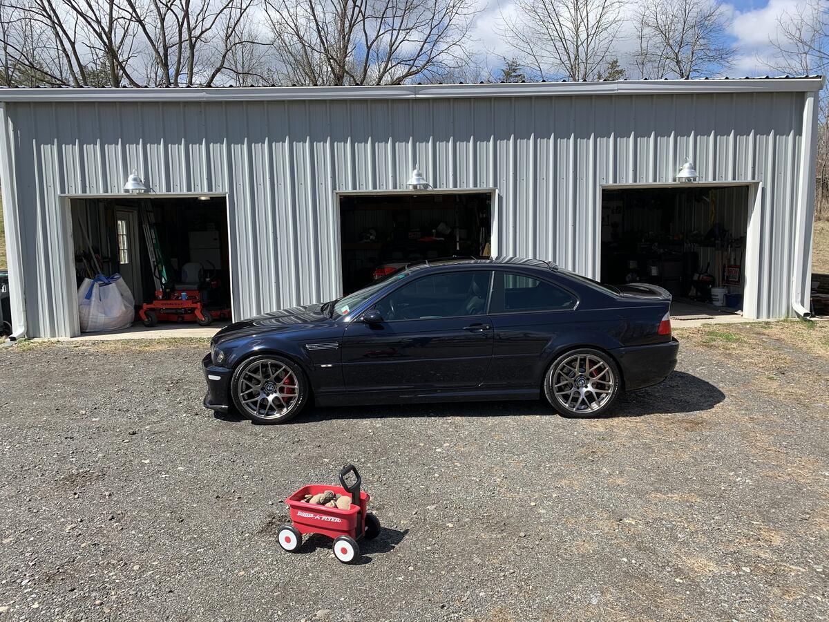

                Ok I’ll play
                Front
                VMR 710 19x8.5 et35 (gunmetal)
                Firestone firehawk 500 255/35/19
                dinan strut bar
                hotchkis sway bars (middle setting)
                koni shocks (softest setting)
                eibach springs
                135i 6pot calipers
                ecs tuning 2 piece comp. rotors
                Rear
                VMR 710 19x9.5 et22
                firehawk 500 285/30/19
                dinan rear strut bar
                hotchkis sway bar (softest setting)
                koni (soft)
                eibach springs
                Porsche 996 4pot calipers
                oe comp. 2 piece rotorsClick image for larger version Name:	8CD2C97C-2479-4B6D-BDD6-D4DF6F8D4D26.jpeg Views:	0 Size:	286.5 KB ID:	46630
                Did you have to roll fenders to tuck a 285 in the back?
                Just some old shitty cars.

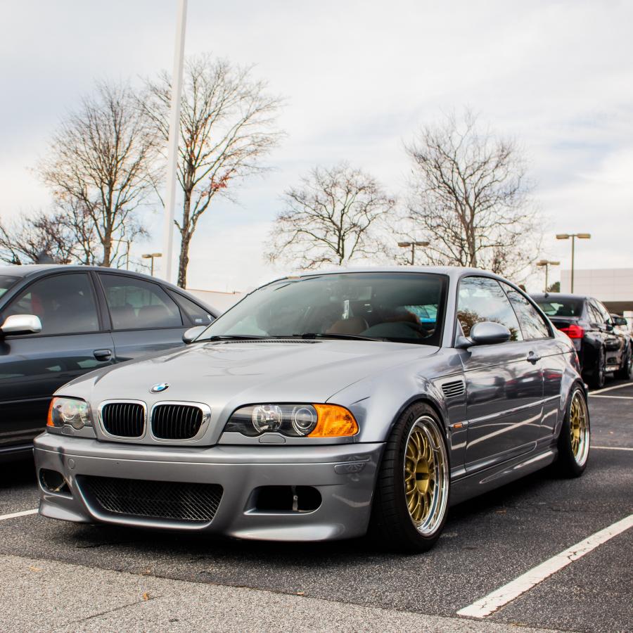

                              Front:
                              BBS E88 18x10 et21.5
                              Michelin PS4s 265/35/18
                              Camber: -3.6 degrees
                              Rubs: On full lock
                              Spacers: None
                              Springs: 5" 9k Swift
                              Shock: TCK DA
                              Camber Plates: Vorshlag
                              Ride Height: 13.25 inches
                              End Links: E36 M3
                              Control Arm: OE
                              Sway Bar: OE (powerflex bushings)
                              Tie Rods: OE
                              FCAB: OE
                              Brakes: 996 Brembo
                              Rear:
                              Camber: -2.4 degrees
                              Rubs: None (shaved fenders)
                              Spacers: 5mm
                              Springs: 4" hyperco 550lbs on gc weight jacks
                              Shock: TCK DA
                              Ride Height: 12.75 inches
                              End Links: Swaybar deleted
                              Camber Arms: Eibach
                              Sway Bar: Deleted
                              RTAB: Synchro Design
                              Subframe: Solid PSM / Vince bar
                              Brakes: 996 Brembo
                              ​ Click image for larger version  Name:	m3cca-6~3.jpg Views:	0 Size:	135.5 KB ID:	220428 ​
