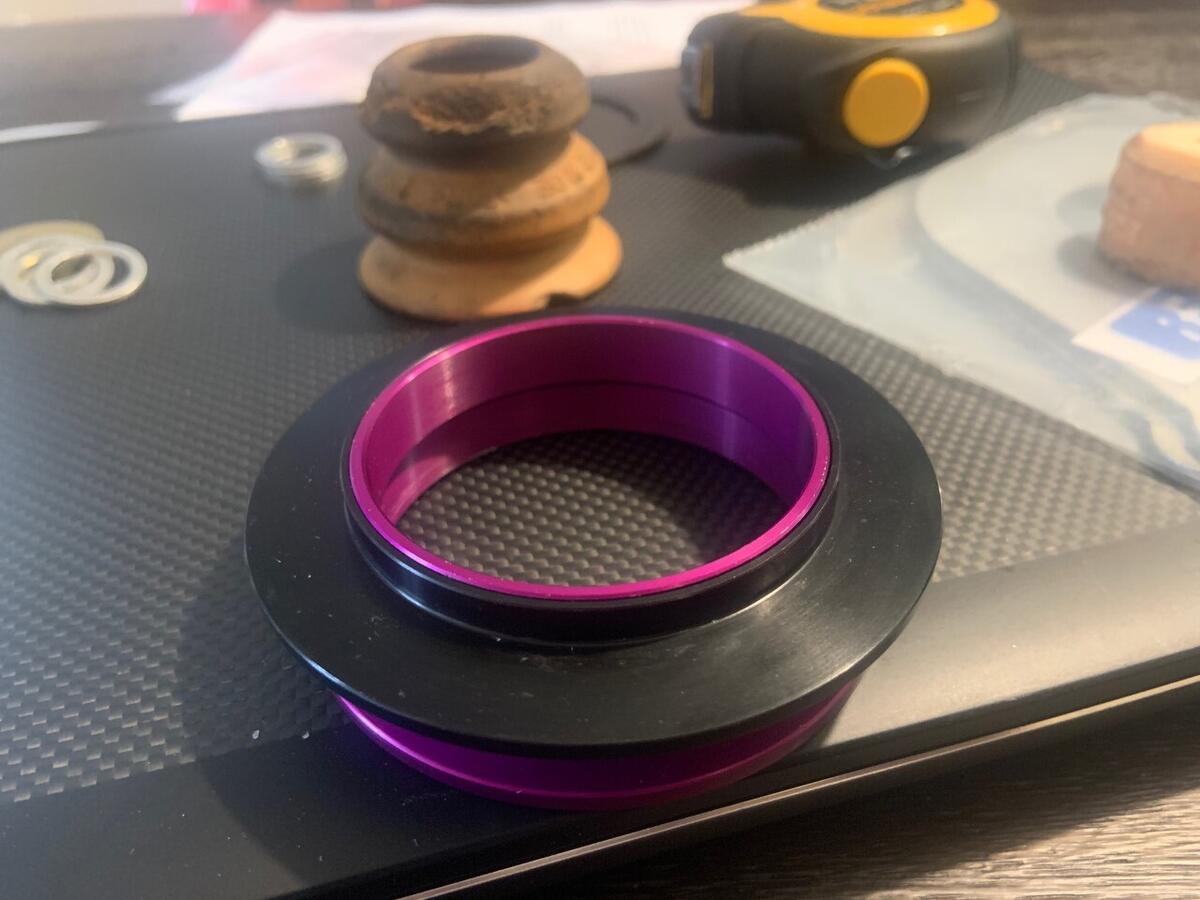

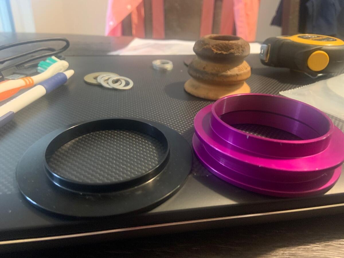

      Hi, here are some images for future reference for anyone investigating cross-compatibility of springs and adapters
      The black part is the Eibach adapter to fit a 2.5in spring to the 60mm perch (or 61mm KW perch as explained below)
      The purple part is a KW spacer made to work with 61mm KW stock springs, however, the lip diameter for the KW spring perch is 60.9mm and the inner diameter of the Eibach adapter is 61.1mm, so the fit is perfect
      Click image for larger version  Name:	KW-Eibach Adapters1.jpg Views:	0 Size:	89.5 KB ID:	62124
      Click image for larger version  Name:	KW-Eibach Adapters2.jpg Views:	0 Size:	85.2 KB ID:	62125
      The punch line here is that the Eibach adapter would work with H&R, Bilstein (60mm) and KW (61mm) coilovers saving you from changing the spring perch. the caveat is that you add 2.7mm to the spring stack, this is not much unless you are fighting the last mm to achieve the height you want. in my case I am, so I bought Ohlins 65mm threaded perch as I need those 2.7mm back 😋

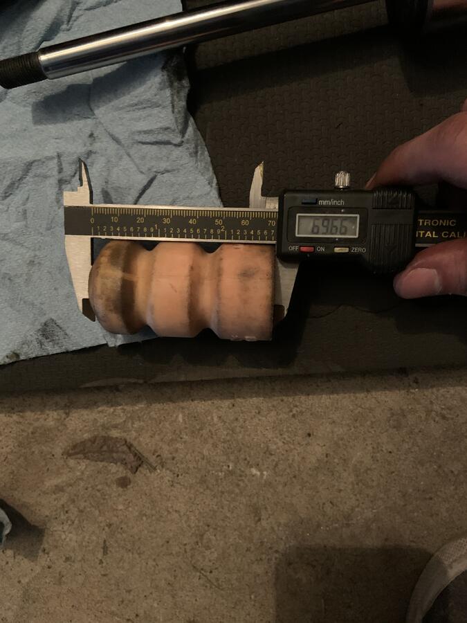

          Are you doing anything with the bumpstops? Your H&R coils are essentially Bilsteins so I imagine they've got internal bumpstops. Any idea about their rates and if you can tune them?
            See some posts before, I took pictures of the bump stops. I cut them down by 1in. Yes, they are internal.

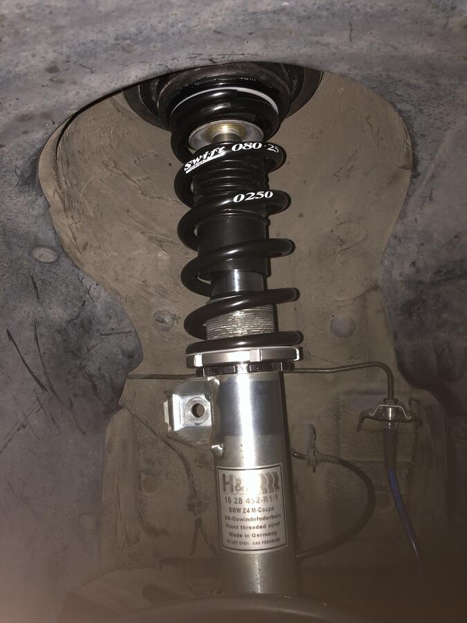

              Just to close the loop on some of the work suspension I did to my car recently so it is useful for others trying something alternative.
              Below is a photo of my final setup
              What you see is an H&R Coilover front strut with swift "Standard" spring, which is mildly "soft", I say soft as most kits go crazy with rates for street applications LOL.
              This is what I went with
              1. H&R Street CO Front Strut
              2. Swift 8" spring in 250# rate
              3. Swift spring thurst sheet kit
              4. OE Mounting hardware with some changes in the Mix (I used two of the smaller washers from the OE setup, as opposed to a big and a small one), the washer is there so it provides some coverage from road grime to the radial bearing, you can see it in the image below, the OE uses a similar washer, but bigger in diameter (with the 2.5in spring it just does not fit).
              5. A few washers to space out the top hat and reduce preload, I got 0.8" of preload which is appropriate for the strut assembly (you don't want crazy preload as it affects roll)
              6. I cut my upper spring pad so it "dresses" the turner upper spring seat and aluminum hat, it looks factory (if I could of cutting it perfect LOL)
              7. Upper TMS 2.5in spring perch
              8. Lower 65mm Ohlins spring perch (It is M52x1,5 thread, thus fits perfect H&R and so would Bilstein and KW)
              9. Modified H&R internal bump stop (shortened about a 1in)
              The final assembly
              Click image for larger version  Name:	IMG_0099.JPG Views:	0 Size:	63.2 KB ID:	63029
              Assembly Notes: The above yielded me a strut assembly where the 8" spring is preloaded to 0.8in or about 200# of force, with these the car would theoretically lower 2.7in, however, in reality, it lowered 2.8in, so I was not far off.
              Please consider that to the 2.8in displacement you have to reduce the preload distance, in this case, 0.8, so the car just lower 2.0in when sat on the floor.
              The spring has a total of 4.9in of usable travel, so at this ride height I still have 2.1in of usable travel, and according to Swift, these bind at 5.6in, so I am good as I won't ever bind the spring (even if I go max suspension travel including compression of the stops), the strut will compress the bump stop fully before that. This was a key balance for me during my part selection

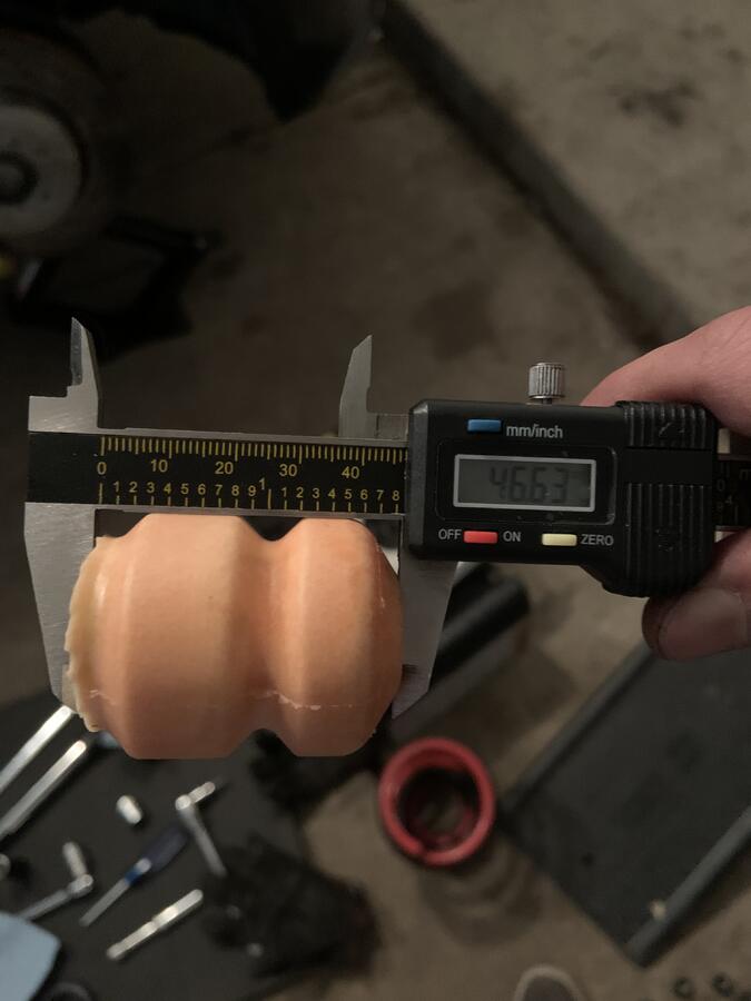

              Here you can see the modified bump stop
              Before
              Click image for larger version  Name:	IMG_0306.JPG Views:	0 Size:	71.5 KB ID:	63031
              After
              Click image for larger version  Name:	IMG_0320.JPG Views:	0 Size:	40.7 KB ID:	63030
              This all means I now have (at ride height) 1.5in of travel before engaging the stop, and I assume another 1in before fully compressing it to a solid block state.

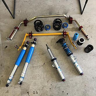

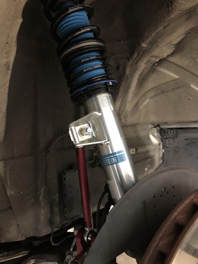

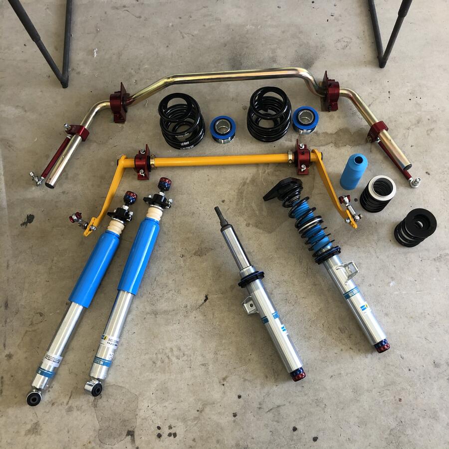

ID:	63442 This makes me happy. Bilstein club sport setup with Ground Control sways. Has that familiar Billy feel. On full soft it’s a perfect aggressive street setup. I’m still messing with compression rebound and sway bar settings.
