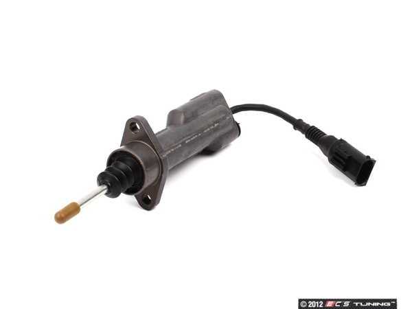

This is most commonly the clutch slave cylinder due to the PLCD sensor which is not replaceable on its own (it is embedded into the clutch slave). Fortunately it is an easy job but it will require bleeding the system after replacement plus running adaptations. There is a difference between the SMG clutch slave and manual clutch slave. The SMG is more expensive of course.Originally posted by robgill View PostHey @Irhase46m3, this thread has been super helpful for me getting my SMG build sorted. Right now the SMG is running great with one lingering annoying issue. I get a cog light only on cold start that goes away after a warm start. The code I get from PA Soft is "3B [059] Clutch Control" and the code from Carley is "00003B Driving Clutch / Stall Speed". After some googling the first thing I did was replaced the speed sensor which had no impact. Next I reran the INPA Adaptation. This failed while cold, and worked while warm. Thoughts on anything else I should be trying? In the meantime the code seems to have no impact at all on the SMG performance.
- Likes 2
Thanks for the quick reply, I'll give the the slave cylinder a look. Thus continues the trend that if I didn't replace it during the full restoration it's now likely to break 😆.Originally posted by oceansize View Post
https://www.ecstuning.com/b-genuine-...r/21522229841/

I am getting the same code you are, to truly know if your slave cylinder is bad, you need to check the values in INPA for the clutch operation (i do t remember the actual value name atm) if this value is fluctuating it means the sensor within the slave cylinder is bad. If i recall correctly this value represents the distance it needs to travel, this is the clutch bite point during adaptation. In my case its a new cylinder and i still get the code.
You can also repair the unit, they do sell the compression metal bracket/ring that retains the rod to the cylinder, its the same repair kit as the non smg cylinder. Only difference is the sensor, if it goes bad the unit is done.
