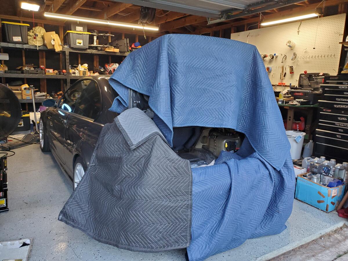

                              I did it myself in my garage. I used a bunch of images from Vince's facebook and other's that have done this to guide me through the process. As timmo said above, make sure you cover the interior of the car before grinding and whatnot.
                              I used some moving blankets from Harbor freight to make sure everything was properly covered while doing the grinding. The last thing I wanted was ruined interior. Here are some images throughout the process:

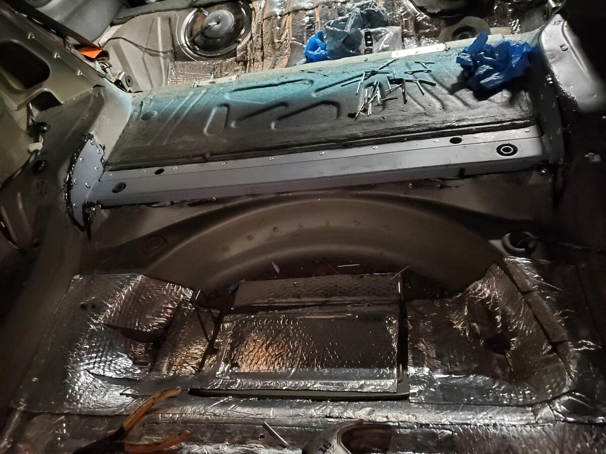

                              Bar Epoxied and Riveted in place. **One huge suggestion is to get a pneumatic or assisted rivet gun. I almost crapped my pants getting those larger side rivets in place lol.
                              Click image for larger version  Name:	20190829_034803.jpg Views:	0 Size:	169.2 KB ID:	47331
                              This was when I was spraying all of the exposed areas with the Steel Grey matching paint. However, I used these types of moving blankets to cover my interior during grinding as well.
                              Click image for larger version  Name:	20191005_073846.jpg Views:	0 Size:	218.1 KB ID:	47332

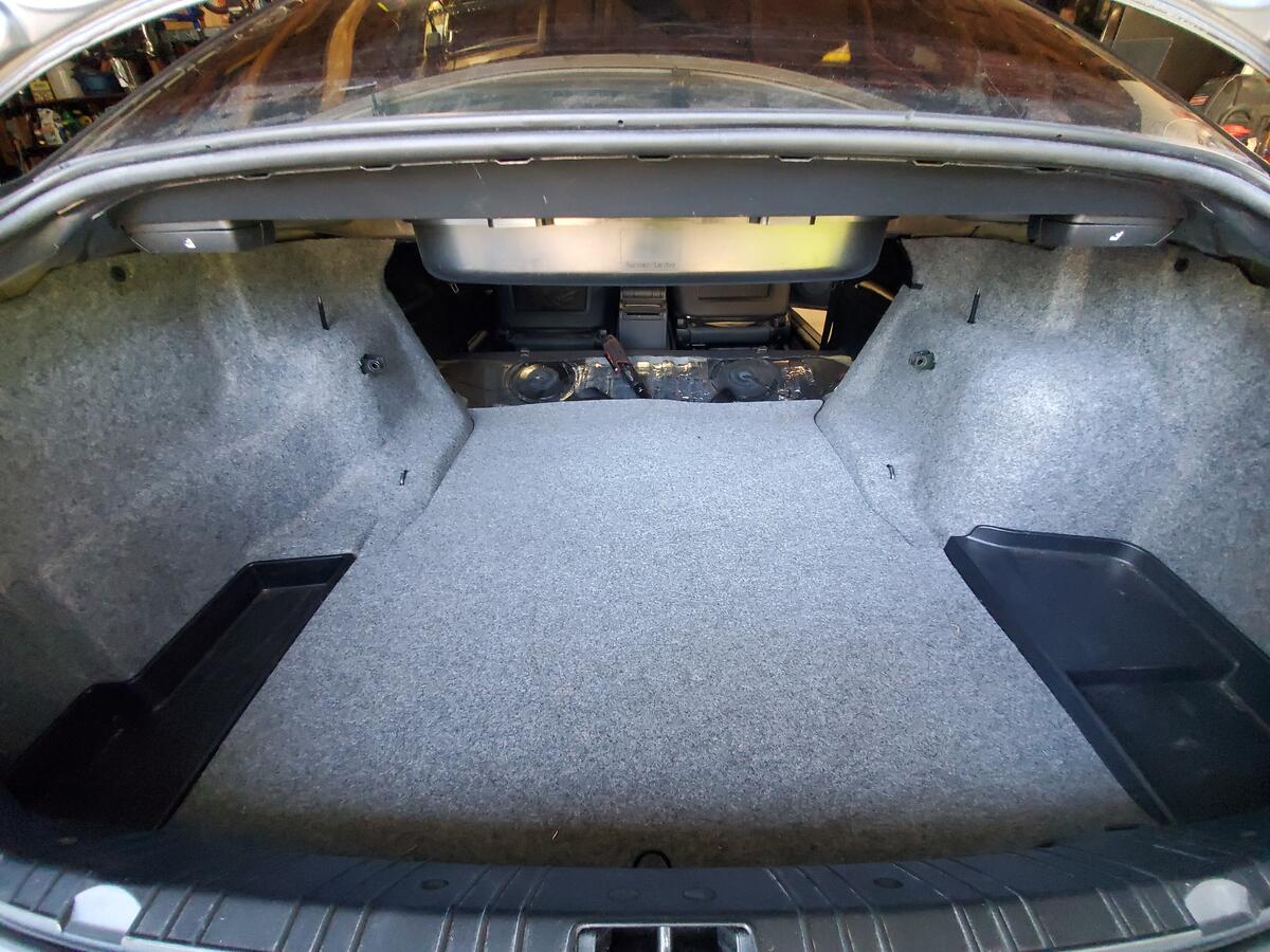

                              What it looked like after reinstalling the interior pieces. I love that it is back to stock and not noticeable!
                              Click image for larger version  Name:	20191005_092436.jpg Views:	0 Size:	161.4 KB ID:	47333
