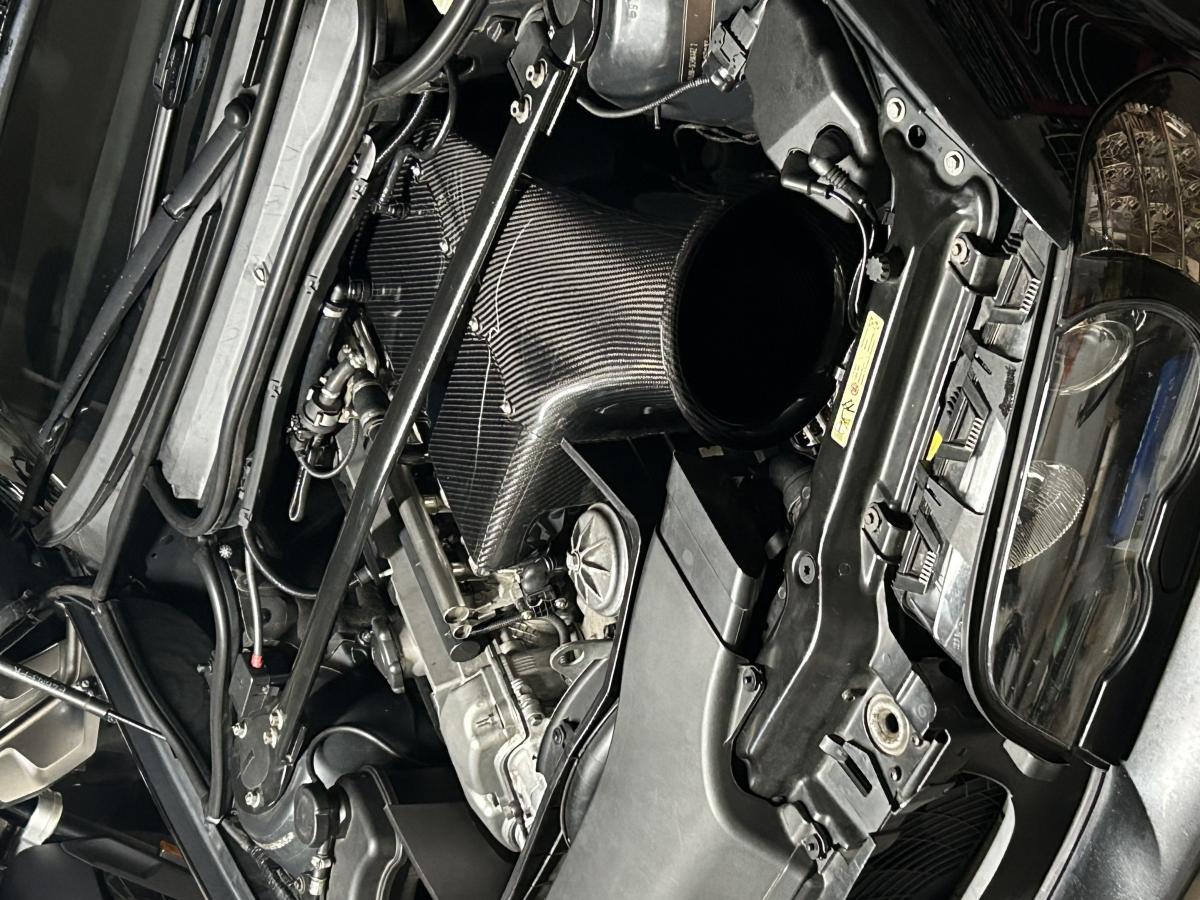

                        I just put a set of these Megan Racing headers on as part of a CSL-style intake project on a track car (2005 manual). I purchased from Prestige Auto Lab for $328. Shipping was timely and the product fitment is spot on. Here’s what I’ll add:
                        1) Studs: one of mine backed out on cylinder 1. I replaced it with one the N54 ones recommended in this thread. It went in to the shoulder easily with a small ratchet. Pro: easy to install nut. Con: it’s longer, so more wrenching and the new threads and nut make that a challenge. I’m glad I didn’t replace them all based on that consideration; I had 18 to use if needed.
                        2) Tool: the $30 Gear Wrench 35 Piece 1/4" Drive MicroDriver Set, combined with a short extension can get all the nuts while working from the top. Ergonomically, this was a good position for tightening on install. I did not use the battery powered 1/4 drive ratchet I intentionally bought for this job.
                        3) O2 sensors: the Pre Cat, Bank 2 wire is not long enough to be routed on the original ‘path’, I had to route it directly over the back of the valve cover to avoid the header. It is also in a position that seems to compromise the wires, with a tight fit against the firewall heat shield. (Maybe I’ve done something wrong?)
                        4) EGT probe needs a u-turn bend instead of the original 90 degree bend to provide an optimal routing and a bit more slack in the wire. I will find out from Epic Motorsports if it’s even required for his tune.
                        5) The Megan ‘gasket’ for headers to section 1 joint is preferred over OEM because it’s dimensions allow the bolts to be used to compress the material, whereas the OEM dimensions prevent threading the nut on original bolts.
                        6) Process: contrary to some DIY videos and instructions, the original headers can be removed, with the O2 sensors still installed without removing any engine mounts or front control arm components.
                        7) Optional ‘while I’m in there’: this is a good time to replace the coolant hose BMW-11537830713
                        Now, once I get through some issues I’m having with the OBD connection and the Epic software (that I didn’t have on a previous tune a few months ago) I’ll get the car running and head to the dyno.
