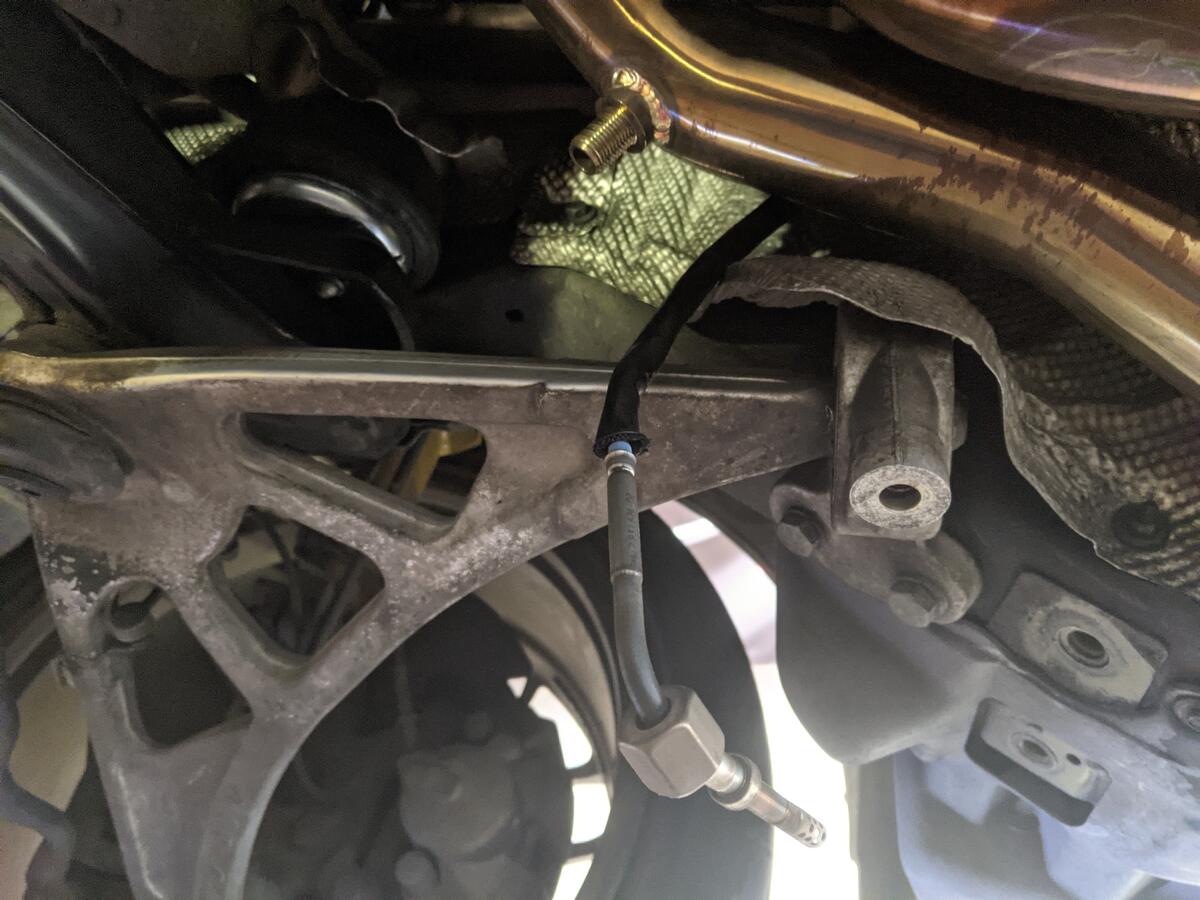

    EGT is for sure used for engine management with the csl engine management. I don’t know if that’s also true for the non csl engine management.
    My car hasn't had any issues since making the switch. It's location makes it really inaccurate and it only measures one side. If it is imperative, I may buy a new one and fix the cut wires but so far so good. It's one less thing I have to worry about. It's only purpose is to seal that bung atm.

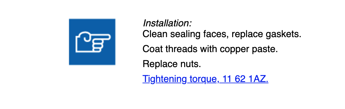

          Cubie, it's the other way around. The threads for the copper nuts only require copper anti-seize to aid in removal if the manifolds need to come off at any point in the future. The anti-seize keeps the nut from seizing to the stud and pulling the stud out of the cylinder head.
            #35
            That does make sense but is it not a good idea to put anti-sieze on the studs to prevent the threads from potentially galling in the head? You do not use any anti-sieze on the threads going in the head?
              #36
              No, you want the studs to stay in the cylinder head, so dry install seems preferable. I don't think BMW intended for the studs to be removed unless they had some damaged threads.
              TIS for reinstalling manifolds with new copper nuts using copper paste (anti-seize):

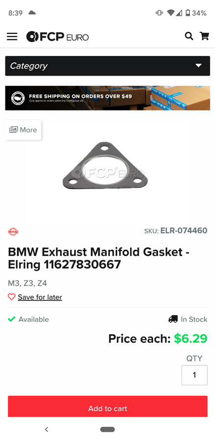

                    I used elring gaskets, so hopefully those aren't at fault. I tightened the new oe nuts decently tight in criss cross patterns across different flanges evenly but I was afraid of stripping it so maybe I didn't tighten it enough. I checked the flanges on the headers and they seemed fine.
