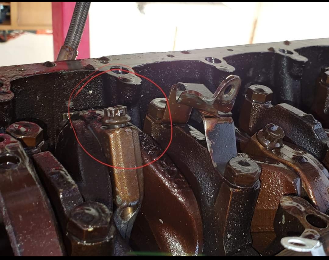

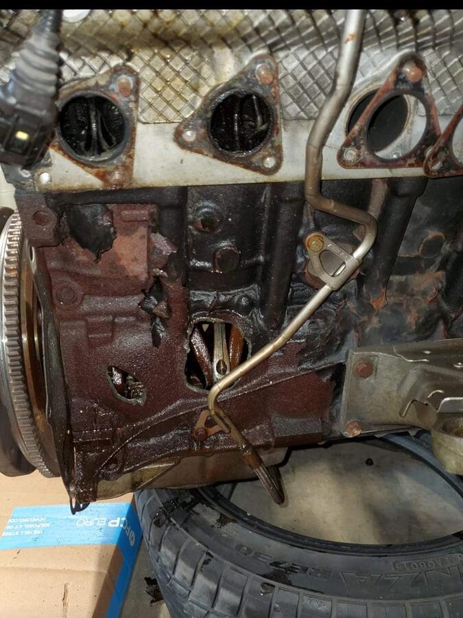

              Originally posted by Dash1 View Post
              What's more important than break-in is proper install. Which is what I think individuals nerf when they have rod bearing failure after a replacement.
              One of the local M3 owners posted this the other day. He had just bought the car and it was making a ticking sound but he thought it just needed a valve adjustment. Now the block is well ventilated with a total of 5 windows. It looks like someone messed up the rod bearing replacement.
              IG: https://www.instagram.com/mspir3d/
                That sucks. Did he post on facebook that he had a ticking noise, got responses that "it's normal", to which he said, "thanks, sending it"...?
