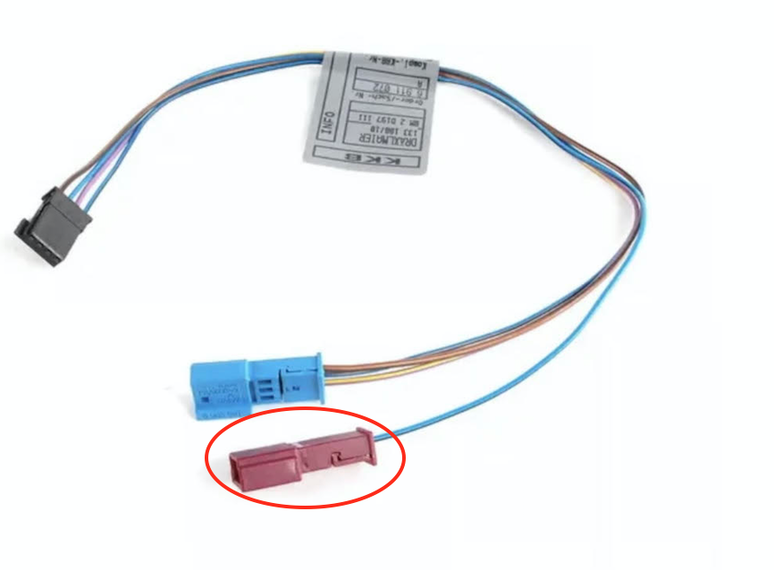

            Hey Liam - I know it's been a while since you fixed this issue. What did you do with the 4th wire/pin (burgundy block) for the harness lead? Did you end up pinning it into the EWS or leaving it out? I do not want to mess with the EWS or implement a lockout feature.
            This thread suggests Pin 4 can be omitted if one is not installing the EWS stater lockout feature. Wanted to check with you and confirm. Thanks in advance.

              So my clutch switch I'm using, 61318363710, is a 3-pin switch, not the newer fancy 4-pin like all the 2001+ models. It connects to power, ground, and X60002 / PIN 20 on the DME. That's it. My EWS starter lockout feature has been disabled, so I don't need to press the clutch to start the car.
              If you have a newer 4-pin style, the 4th pin goes to the EWS X1659 pin 8. (Note that pin 8 has nothing in it if your car was an SMG, so you'll need a new pin for the connector)
              So to recap:
              Pin 1 = Br/Sw (Brown w/Black stripe) -> Ground (tap into the brake light switch on the pedal box that has the same wiring colors)
              Pin 2 = Bl/Br (Blue w/Brown Stripe) -> Pin 20 @ DME x60002
              Pin 3 = Vi/Ge (Violet w/Yellow Stripe) -> 12V (tap into the brake light switch on the pedal box which has the same wire colors)
              Pin 4: Bl/Sw (Blue w/Black Stripe) -> Pin 8 in EWS (white box in the upper left-hand side of driver's footwell. Pin 8 is empty)
              If you have a 3-pin clutch switch as I did or you don't want to wire in pin-4, you need to code out the EWS starter lockout feature.
                Thank you, Liam. There’s no documentation I can find for that EWS pin 8 tap. I saw it in a YouTube video and wanted to confirm. I’ll let my shop know.
                Thanks again!
