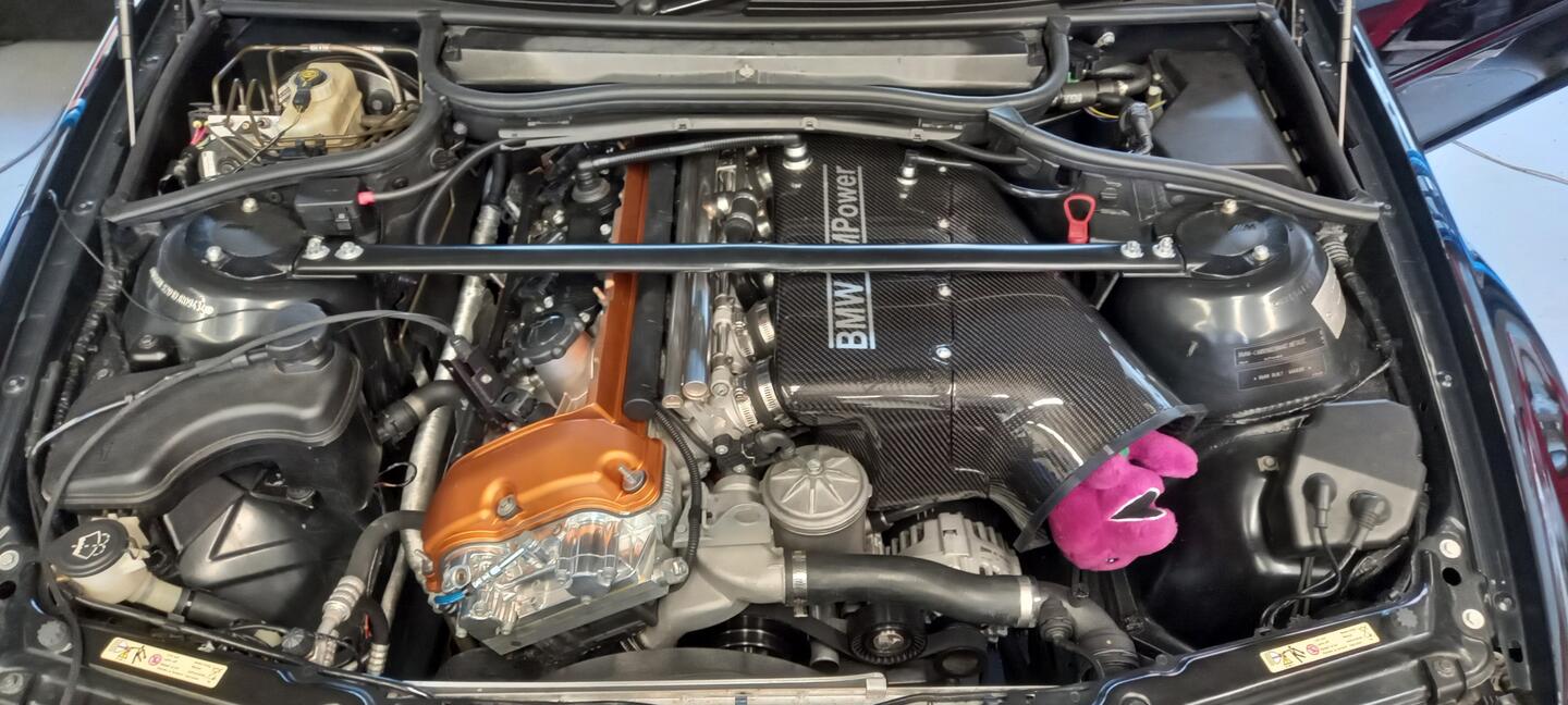

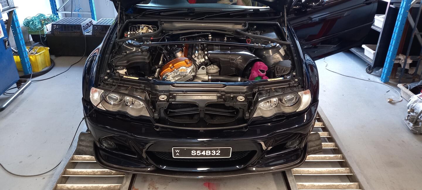

I only took a couple pics of it on the dyno. Barney the Dinosaur looks right at home LOLOriginally posted by bigjae46 View PostIn for pics. Car looks fantastic!
