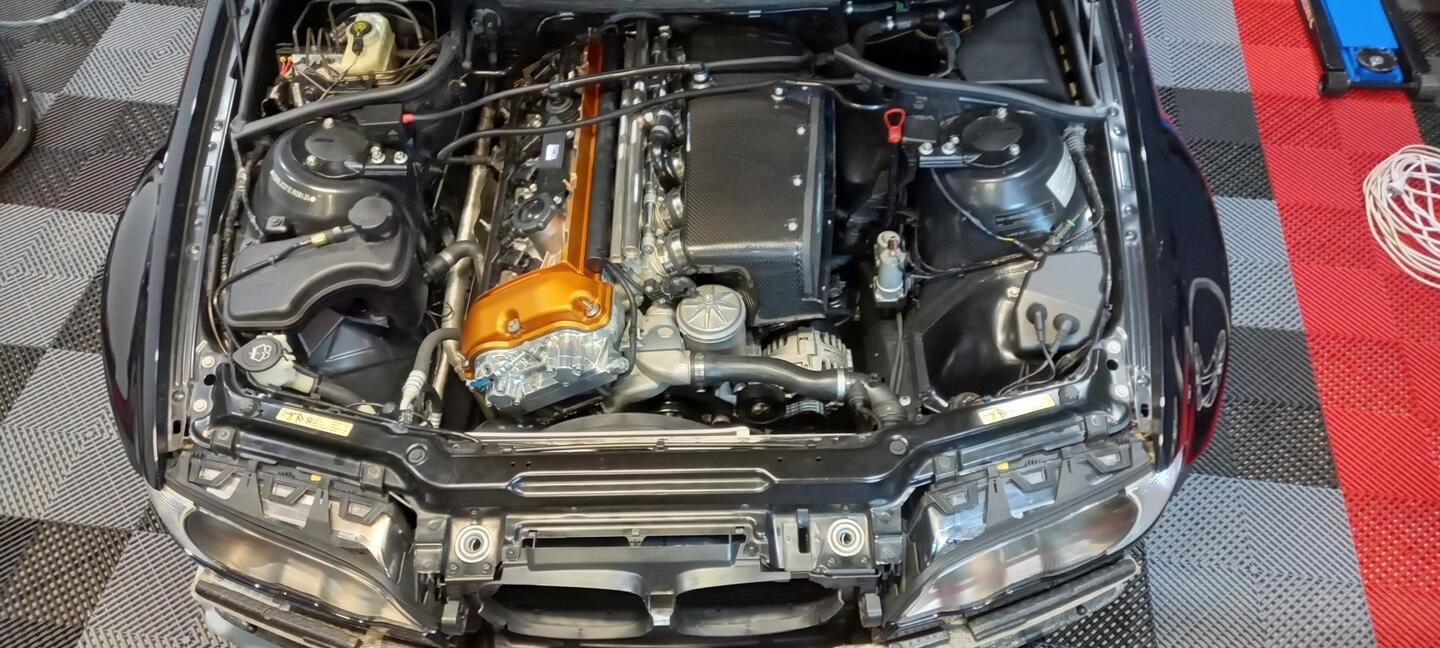

                        So over the Easter weekend I ran into a few issues. One of them being the oe exhaust manifold studs are too short to accommodate the (much) thicker flanges on the SSV1 manifolds. The oe manifold flanges are very thin, therefore the studs protrude a fair distance allowing the copper nuts plenty of thread to bite onto. As everywhere was closed on Easter Friday, I ran to the only fastener supplier open in the entire city on the Saturday to purchase 18 x M7 bolts with the same thread pitch. I modified each of the bolts by cutting the heads off and cleaning up the threads. Screwed into the head and manifolds on, the replacement studs are ~8mm longer than before. The SSV1 manifolds are now secure. I didn't get any close up photos of them on the car, but you can see the studs I made out of bolts.
                        The rest of Saturday was spent replacing the oe rubber steering shaft guibo with a solid aluminium piece from CPM Auto Engineering, and bolting all remaining accessories to the motor (O2 sensors, idle control valve, throttle actuator, hoses, pipes, air con and serpentine belts, etc.).
                        By Sunday afternoon the JB Racing Lightweight Aluminum flywheel + Clutchmasters FX100 (sprung hub) clutch & pressure plate were correctly installed and torqued to spec. The transmission was also bolted on along with the starter motor.
                        Last order of business for Sunday evening was to drain the fuel tank. I opened up the tank from the access points beneath the rear bench seat and siphoned ~40L of stale fuel. The fuel would have been ~20months old. Half the fuel went in my car, the other half in my brothers. No issues there lol.
                        Come Monday morning, everything was set for the engine and transmission to go in! I utilised the assistance of a good friend and his workshop to obtain a piece of steel 300mm x 30mm x 5mm with holes punched on either end. I attached one end to the lifting point at the back top of the engine block and the chain to the top of this steel plate (you can see it in the pics). Reason for this is I wasn't comfortable lifting the motor from this point and having the chain rest against part of the plastic wiring harness assembly or the fuel/air rail at the back top of the head. This simply created a little more clearance and peace of mind.
                        The motor and transmission went in without too much of an issue. There was 5 of us haha, so with two of us under the car and the transmission on a trolley jack, plus the other 3 up front moving the motor about on the crane, we managed to get it bolted up to the mounts relatively easily. Tail shaft back in with a new drive flex disc (guibo) and centre support bearing. Underbody heat shield on.
                        Massive load off my mind knowing the motor/transmission is now in the car!
                        Yesterday she went for a little exhaust fabrication; mate the SSV1's to my section 1. A little cutting, pipe flaring, welding and it's all done. Exhaust system installed (you can see in the photos the exhaust tips are on the piss, so I'll have those cut off and something bigger to fill the gaps in due course. That's megan racing for you lol).
                        Next steps are to install Mishimoto electric fan + wire to oe aux fan controller, install entire front end, plug in all sensors/wires/air/fuel/clutch lines etc., bleed brakes and clutch, fill it with fluids, pray to the ///M gods and start her up for the first time!
                        Likely not doing any work on it over the coming days. Maybe this weekend. I'm on the home straight now, so come the end of April she'll live once again!

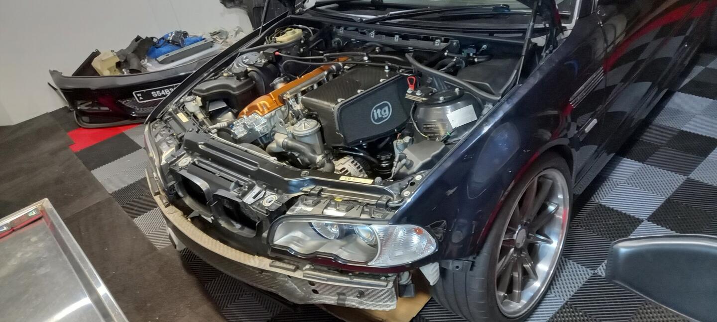

                          Small update!
                          Spent a few hours earlier this week installing the rad support, radiator, a/c condensor, mishimoto fan + wiring to aux fan controller. Also attached the carbon kevlar reo bar. Just taking my time and going very slowly with reassembly.
                          Was going to continue working on it this evening, however an opportunity to attend a corporate box for the Eagles v Collingwood football game; Australian Rules Football - the best kind in the world , came up.
                          Will update in a day or two with more progress

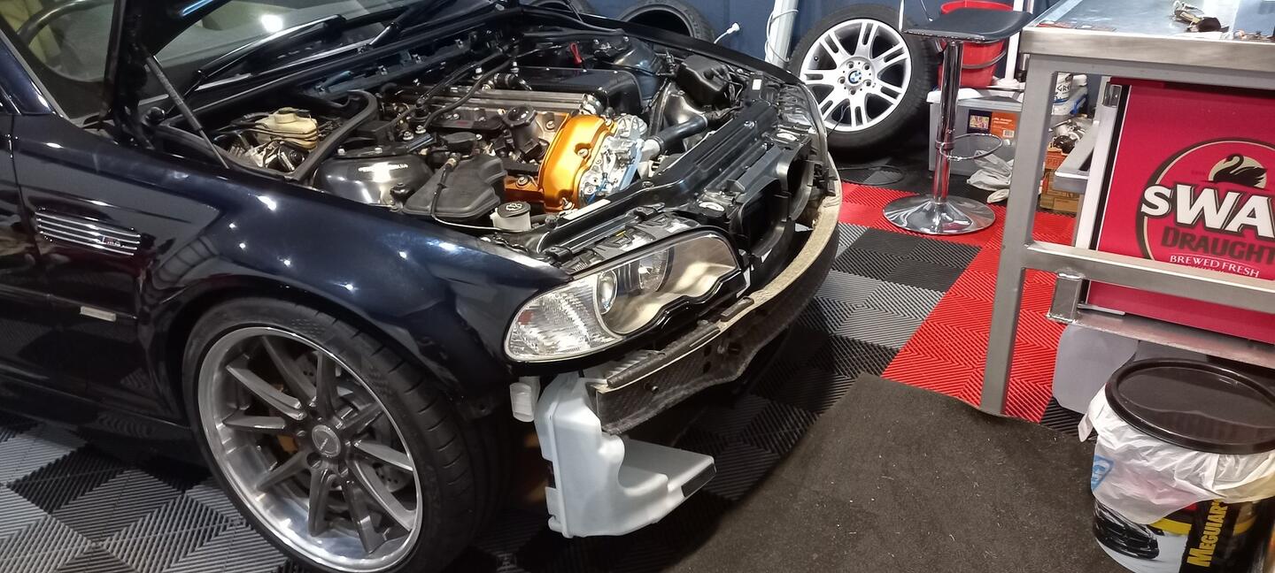

                            IT's RUNNING! Perfectly! No weird noises. Idled perfectly. Revved freely. Valvetrain quiet. No knocks.
                            Had a few issues to sort during the day.
                            We couldn't get oil pressure to build after 3-4 lots of ~15secs cranking. Ended up pulling the oil filter housing and manual filling the block with oil whilst manually cranking it back & forth. Reinstalled the OFH, cranked it off the starter for 2 x 15secs, removed oil filter lid, full oil. We had oil pressure. Fantastic.
                            After re-checking the entire motor/front end, battery on, started it. Fired right up however was missing (or so we thought). After checking coils (which are perfect), pulled all plugs and cyl 1 & 3 were not getting any fuel. Bone dry. Turned out injectors 1 & 3 weren't firing. Removed the air & fuel rails to check the plugs and confirm we were #1 getting the correct voltage & #2 confirm they were correctly pulsing/cycling the voltage. With this confirmed to be true and therefore not an electrical fault, I borrowed a set of injectors from a friend (massive shout out to STAATS), installed everything and bingo!
                            She fired right up, smooth as silk after 2-3 seconds. Took ~15min to achieve operating temp. Oil temp around 95c. Zero leaks of any kind. Revved it around between 1.5-3k rpm, held it for short periods at differing rpm's. Total first-start run time was approx. 30-35min.
                            Also used a laser temperature sensor; each exhaust port was roughly the same. Didn't take note of those temps haha
                            Tomorrow I'll drop oil for fresh 15w-40 mineral run in oil + fresh filter, install front bumper & splash guards etc. then the first drive
