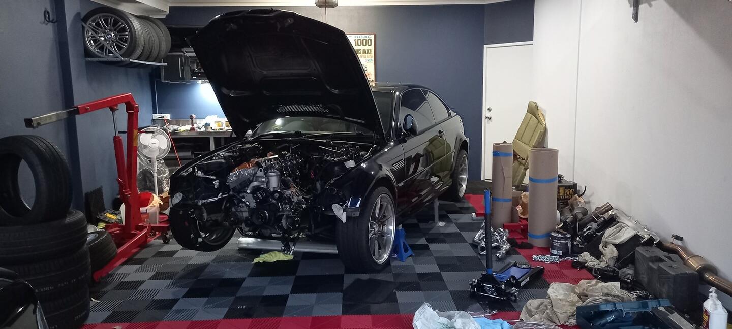

      Exciting! Did you drop it in yet?

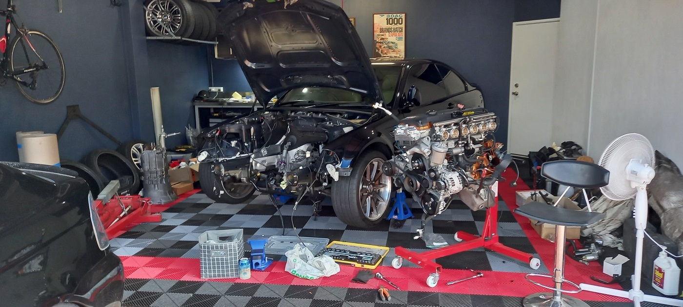

      I am about to complete mine and am looking to drop it in on Sunday
      Plan for tomorrow is
      -Install oil pan
      -Bolt up last accessories (alternator, PS pump, throttle body motor thing)
      -Install Clutch and Trans
      -Clean up garage and prep all tools for install.
      I also picked up a ZHP rack. Will have to install that before the engine goes in.

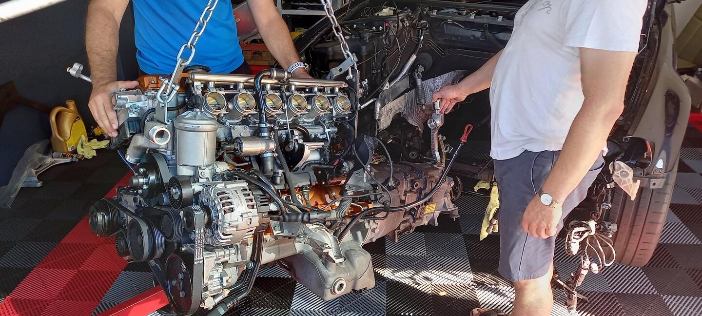

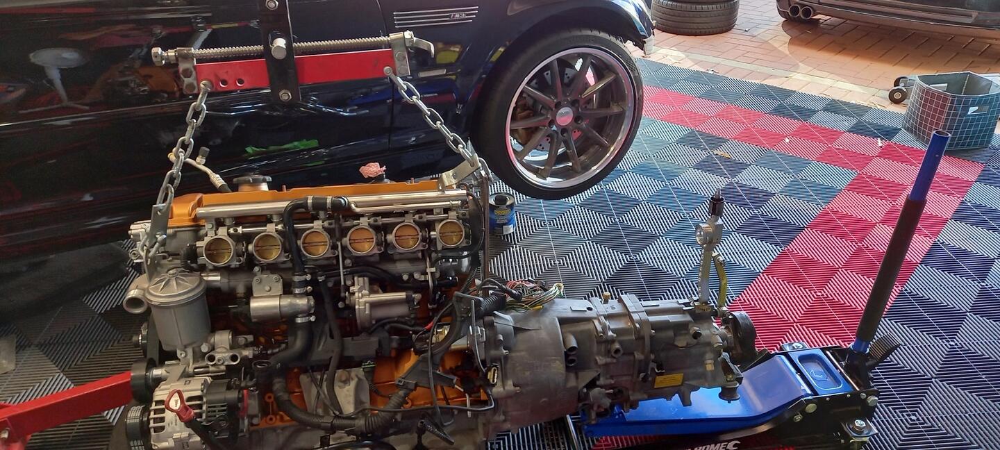

      Have you figured out a good way to put the engine and trans in together? The engine is currently on a stand so it will need to come off before I install the clutch of course. I remember pulling it out together was a nightmare... and I didn’t even have the head on.
      I am trying to avoid putting the trans on separately but this might be the easiest option in the end.
      Oh and for reference my entire front end is off the car.
        -Install oil pan
        I installed my gearbox before installing everything on the car. I have a levelling bar on the engine crane holding the crane and just came in at an angle and levelled out as I dropped in and found it when in together with the engine just as easily as it came out. Having the levelling var for that extra adjustment to the engine crane as you go in and out I feel gave me a lot of control. may have been harder without it so if you're not using one of them I would recommend it.

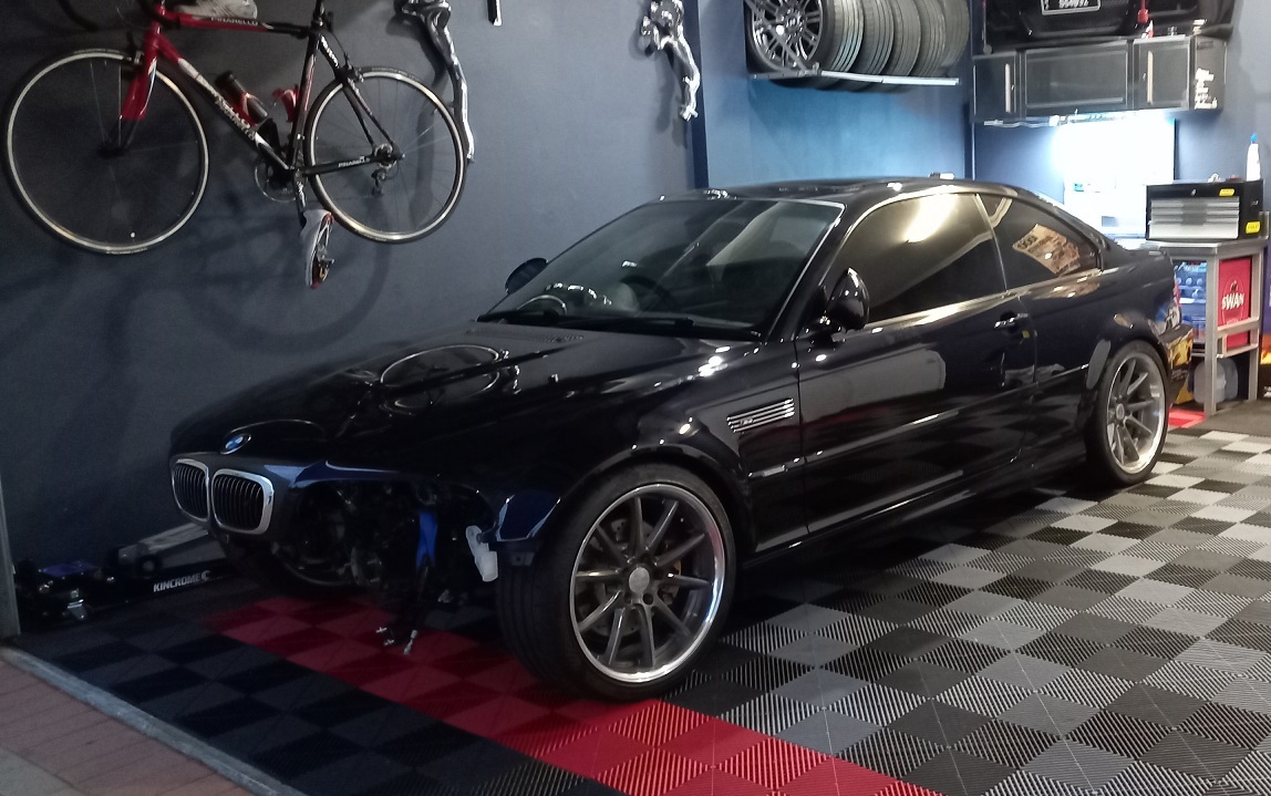

          The engine block looks great in gold. How did you get so a clean finish, spraying rather than brush painting?
          Did you just use masking tape on the top of the block to keep the paint off of it?

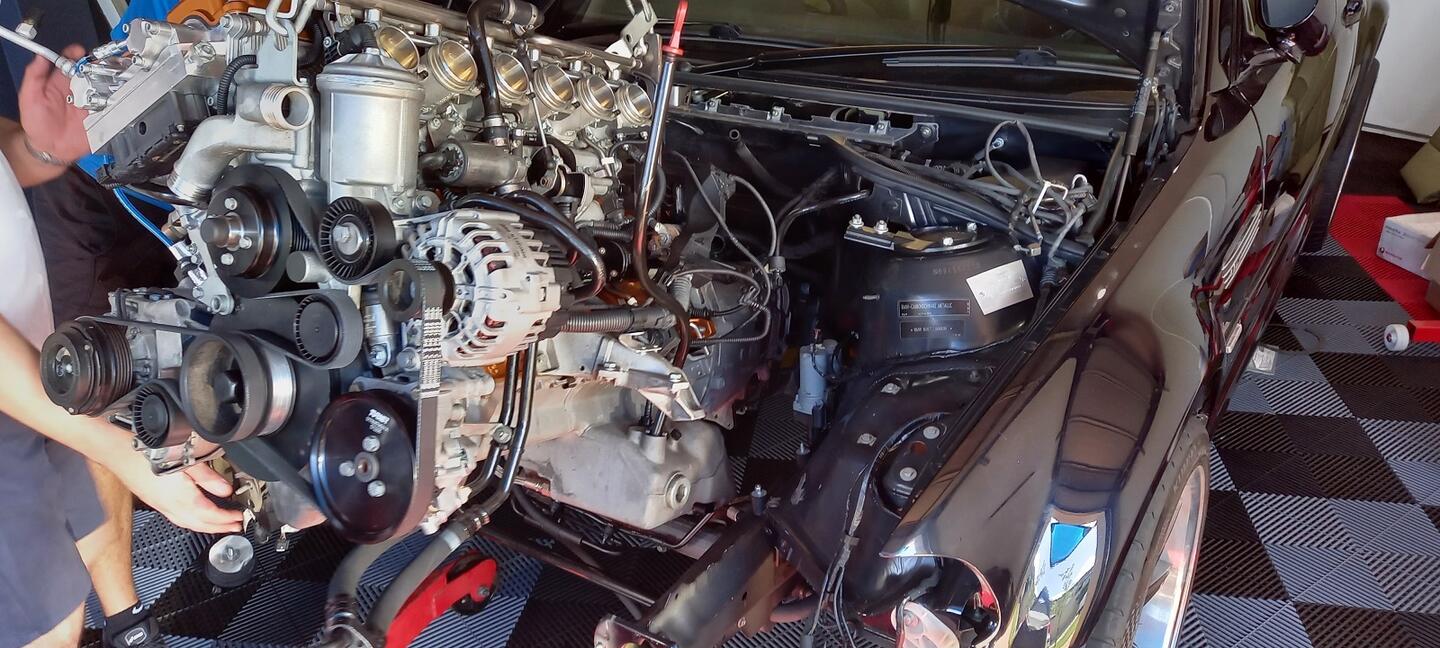

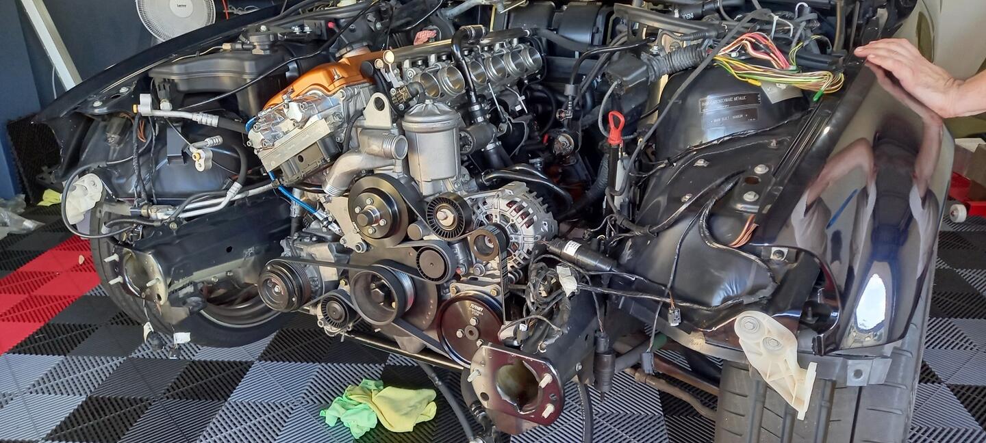

            Quick update - engine and transmission bolted in place! Tailshaft and exhaust system also on. Was a very very long 4 days this past easter weekend.
            Will update with photos and answer any queries in the next day or two!

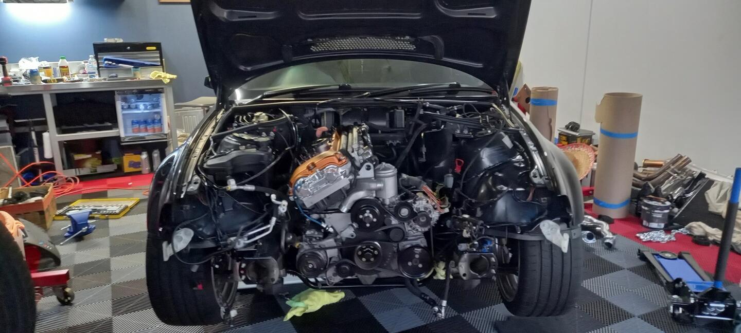

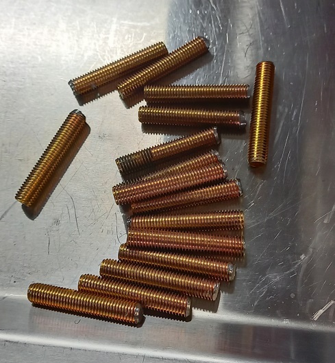

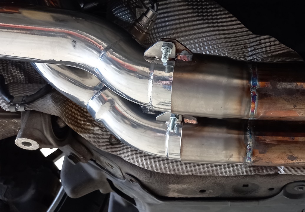

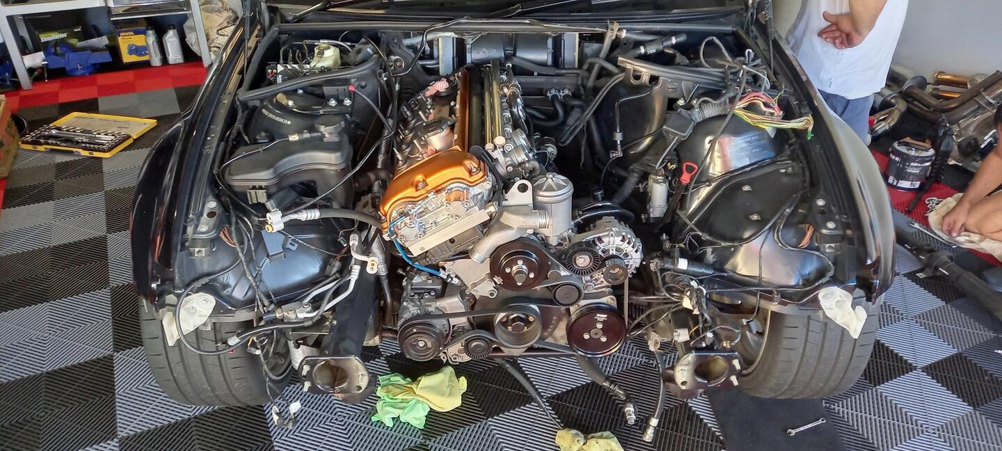

              So over the Easter weekend I ran into a few issues. One of them being the oe exhaust manifold studs are too short to accommodate the (much) thicker flanges on the SSV1 manifolds. The oe manifold flanges are very thin, therefore the studs protrude a fair distance allowing the copper nuts plenty of thread to bite onto. As everywhere was closed on Easter Friday, I ran to the only fastener supplier open in the entire city on the Saturday to purchase 18 x M7 bolts with the same thread pitch. I modified each of the bolts by cutting the heads off and cleaning up the threads. Screwed into the head and manifolds on, the replacement studs are ~8mm longer than before. The SSV1 manifolds are now secure. I didn't get any close up photos of them on the car, but you can see the studs I made out of bolts.
              The rest of Saturday was spent replacing the oe rubber steering shaft guibo with a solid aluminium piece from CPM Auto Engineering, and bolting all remaining accessories to the motor (O2 sensors, idle control valve, throttle actuator, hoses, pipes, air con and serpentine belts, etc.).
              By Sunday afternoon the JB Racing Lightweight Aluminum flywheel + Clutchmasters FX100 (sprung hub) clutch & pressure plate were correctly installed and torqued to spec. The transmission was also bolted on along with the starter motor.
              Last order of business for Sunday evening was to drain the fuel tank. I opened up the tank from the access points beneath the rear bench seat and siphoned ~40L of stale fuel. The fuel would have been ~20months old. Half the fuel went in my car, the other half in my brothers. No issues there lol.
              Come Monday morning, everything was set for the engine and transmission to go in! I utilised the assistance of a good friend and his workshop to obtain a piece of steel 300mm x 30mm x 5mm with holes punched on either end. I attached one end to the lifting point at the back top of the engine block and the chain to the top of this steel plate (you can see it in the pics). Reason for this is I wasn't comfortable lifting the motor from this point and having the chain rest against part of the plastic wiring harness assembly or the fuel/air rail at the back top of the head. This simply created a little more clearance and peace of mind.
              The motor and transmission went in without too much of an issue. There was 5 of us haha, so with two of us under the car and the transmission on a trolley jack, plus the other 3 up front moving the motor about on the crane, we managed to get it bolted up to the mounts relatively easily. Tail shaft back in with a new drive flex disc (guibo) and centre support bearing. Underbody heat shield on.
              Massive load off my mind knowing the motor/transmission is now in the car!

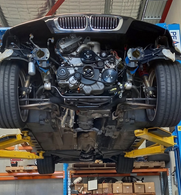

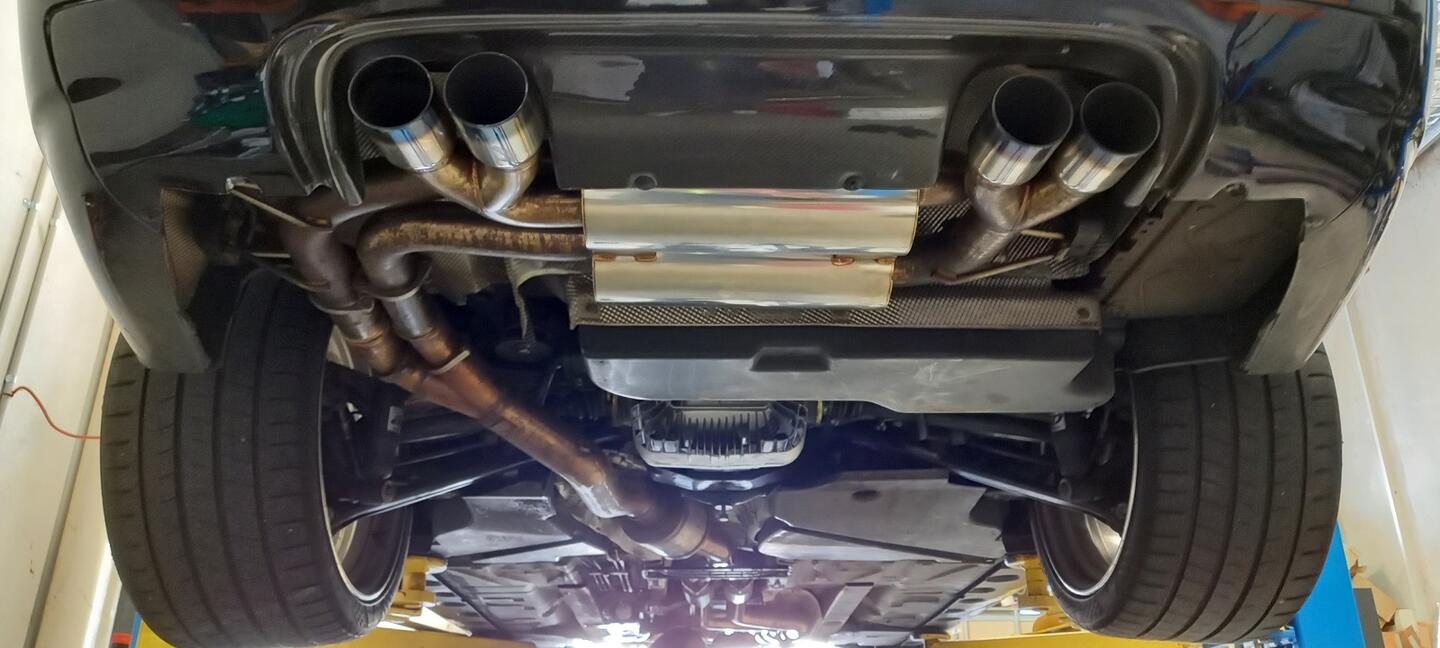

              Yesterday she went for a little exhaust fabrication; mate the SSV1's to my section 1. A little cutting, pipe flaring, welding and it's all done. Exhaust system installed (you can see in the photos the exhaust tips are on the piss, so I'll have those cut off and something bigger to fill the gaps in due course. That's megan racing for you lol).
              Next steps are to install Mishimoto electric fan + wire to oe aux fan controller, install entire front end, plug in all sensors/wires/air/fuel/clutch lines etc., bleed brakes and clutch, fill it with fluids, pray to the ///M gods and start her up for the first time!
              Likely not doing any work on it over the coming days. Maybe this weekend. I'm on the home straight now, so come the end of April she'll live once again!

                I don't really think there is a "good way" to be honest. Have a few friends help , make sure the car is up on stands so you can get under it. I used a trolley jack to lift the transmission whilst lowering the motor on the crane so the entire unit would pitch which way we wanted. This made is a little easier to line everything up.
                I'm unsure about installing the transmission first; would it not be very difficult to get the transmission input shaft lined up with the motor given the relatively large angle the motor has to come into the bay at?
                  Wow, this is some great progress and very well done, so clean! Also, you have showed that the stock head studs are NOT long enough for the SSV1's which has been talked about recently on the forum, I figured they were long enough as did other members.
                  I ended up using N54 studs which are almost too long and make lining up the flanges a pain (with engine in car), but great work making your own, I like it.
                  Do you think you could have done all of this on a 4 post just as easily? I'm sure it's possible, it's just the front bar on a 4 post and less overall width might make things a bit more difficult.
                    I used painters tape to mask up where ever I didn't want paint getting, wiped the block down with a rag and a heap of wax and grease remover then sprayed straight out of the can.
                    Gave it 3 or 4 light coats from memory. Went every which direction to achieve consistent coverage.

                      I read somewhere a while back about the stock exhaust studs not being long enough for the SSV1's, however I forgot about this and neglected to buy N54 studs. Either way, the issue has been sorted. On this topic however, I did see a friends e46 m3 over the weekend. His has an SS manifold although I forget which one. No extended studs and his manifold is still attached soooo idk.
                      Umm I'm unsure tbh. I know a 2 post would made things a breeze; just drop the entire front end with everything attached and install in reverse order.
