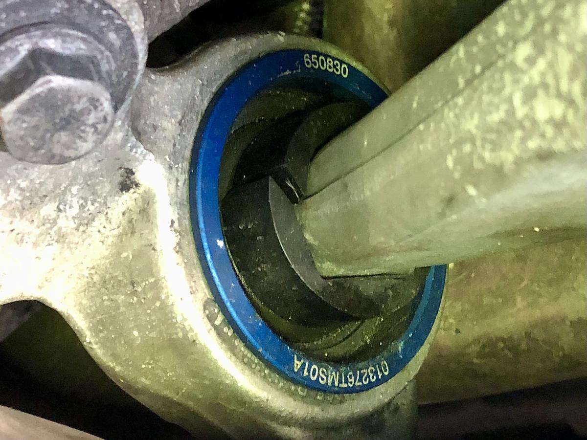

    Completely unrelated, I have a p/n request: I pulled my windshield wiper arms off the other day to install a new cowl. I found that sitting just under where the arms attach to the spindles, there seemed to be some sort of bushign and/or plastic washer that was all busted and degraded. I would like to replace before putting the wiper arms back on, but no idea how to find them?
