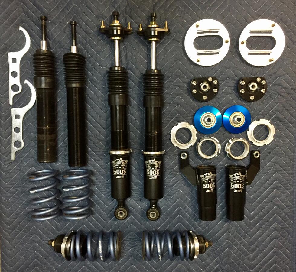

    Here are some pictures:
    Alumunum T6 6061 camber plates
    Rear damper

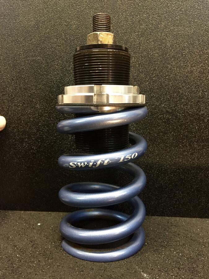

    Rear spring height adjustment perch
    The following pictures were taken after I took apart the suspension to install a new spring isolator. So they had about 1000 miles of use on them - that's why they're a bit dirty.
    While some parts are very pretty, like the top camber plates, other pieces aren't as nice. Some parts are welded together, not billet pieces like some of the other kits. A perfect example of this would be the front damper bottom height-adjustable/swaybar mount. While I'm sure that weld is strong, it's not very pretty.
    Front damper without mounting collar - alllll the adjustability.

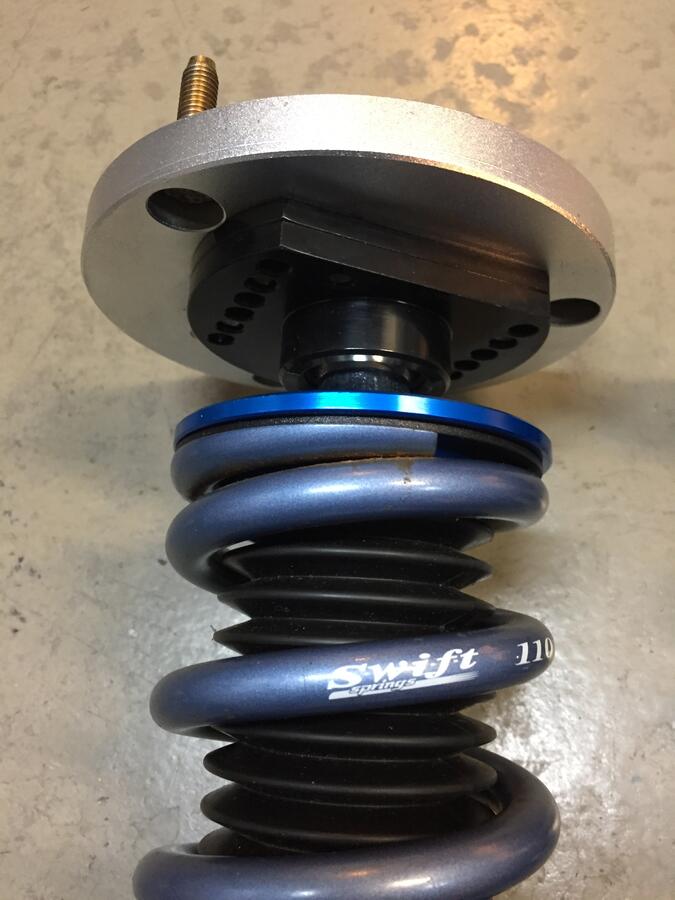

    Front camber plate pillow mount and bottom of the camber adjustment. You have a lot of camber adjustability.
    Top spring holder, anodized blue
    They use off-the-shelf Swing Springs in whatever size you want

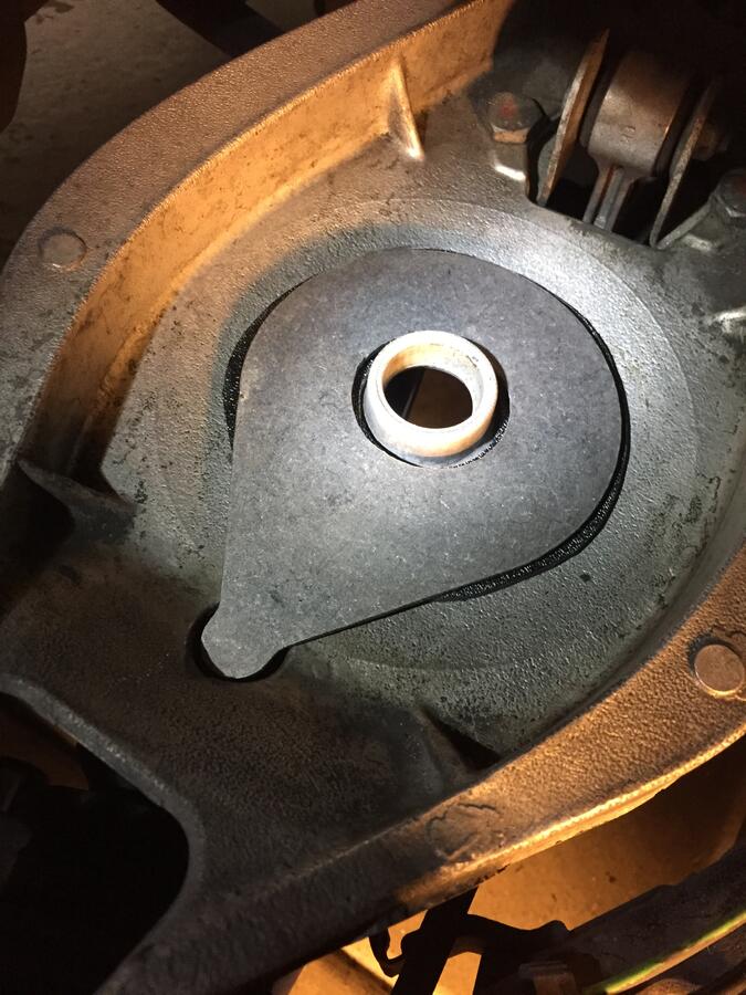

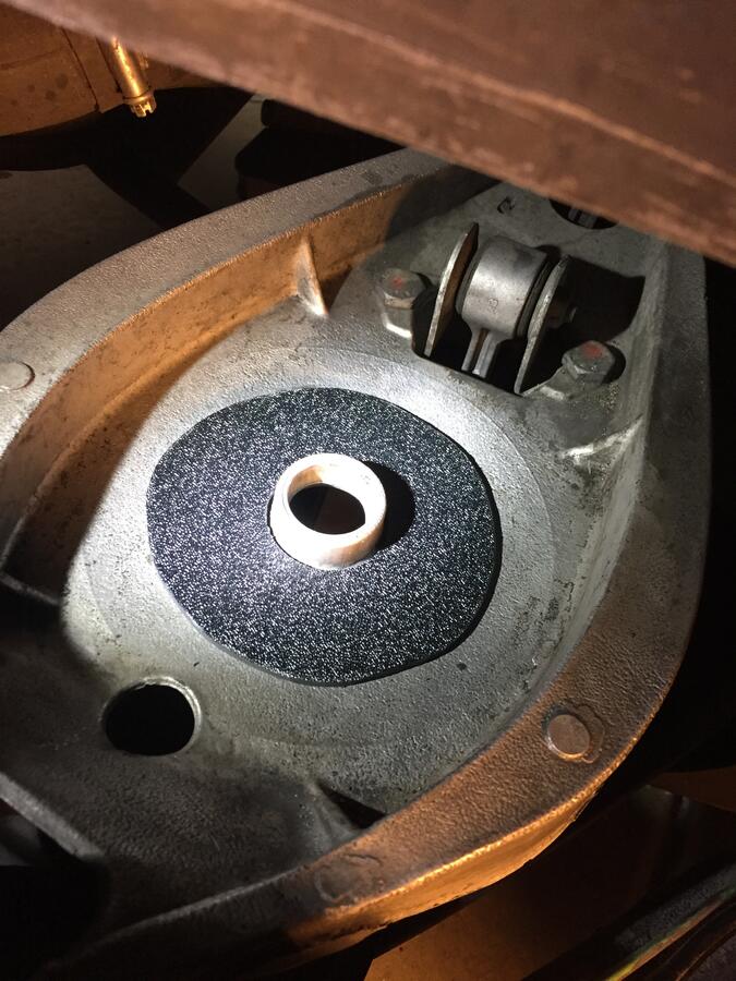

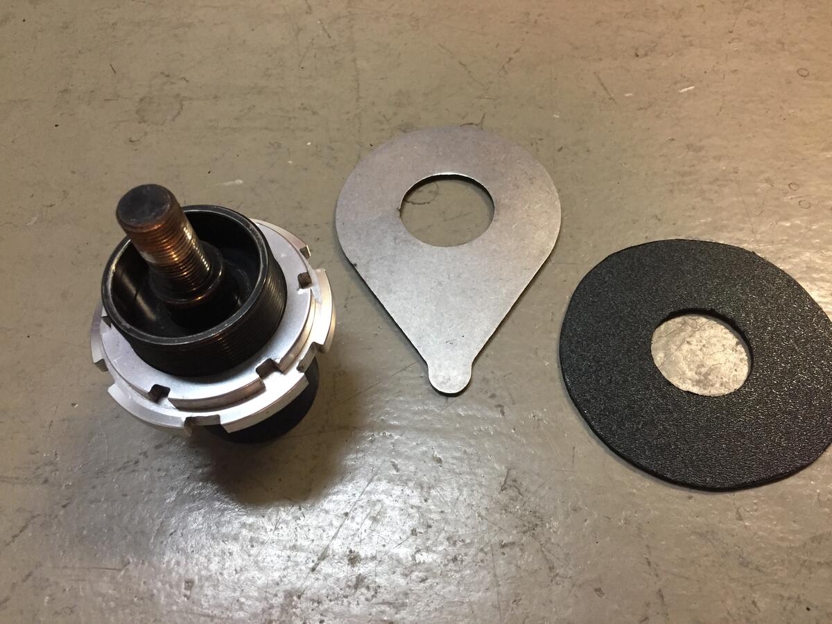

    I swapped the 1mm thick plastic bushing between the spring and camber plate with an energy suspension coil isolator 9.6121. I was hoping this would help with a bit of my driveway crashing, and it did indeed help some. Although you can definitely feel it added a bit of squish to the front suspension. I took a few pictures of that progress here...
    **** UPDATE - ^ The Energy suspension coil isolator did help, but all my NVH issues were the swaybar bushings. The Energy bushing did add a bit of slop to the front suspension, don't recommend. It's since been removed ****

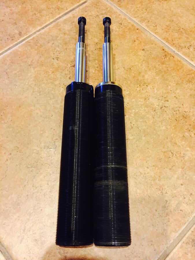

    after 1000 miles of use - you can see the small bushing under the top blue anodized piece on top of the spring
    Unscrew the bottom damper height-adjustable collar.
    Unscrew both height and preload adjustment rings (the purple rings)
    Energy Suspension coil isolator installed

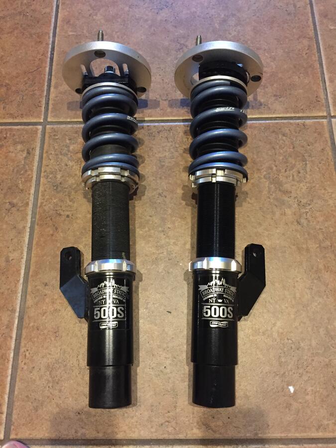

                Nice write up Liam! I'm running a very similar setup, BWS 500S with 9kg front (500) and 11kg rear (615) Swift springs, 16 clicks in the rear from soft, and 4 clicks from soft in the front. These are actually Fortune Auto coilover's valved to Broadway Static's specifications.
                I previously ran BC Racing coiler's with 8k and 12k springs. The BWS 500's were a very noticeable improvement from the BC's. I don't notice the NVH much at all. The only thing different with my setup is the rear control arm Rogue Engineering reinforcement plates with custom made dampers underneath. Take a look at the photos to compare the similarity between FA and BWS.
