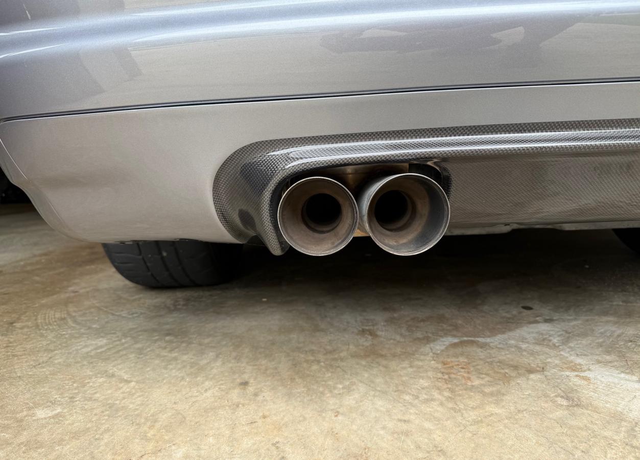

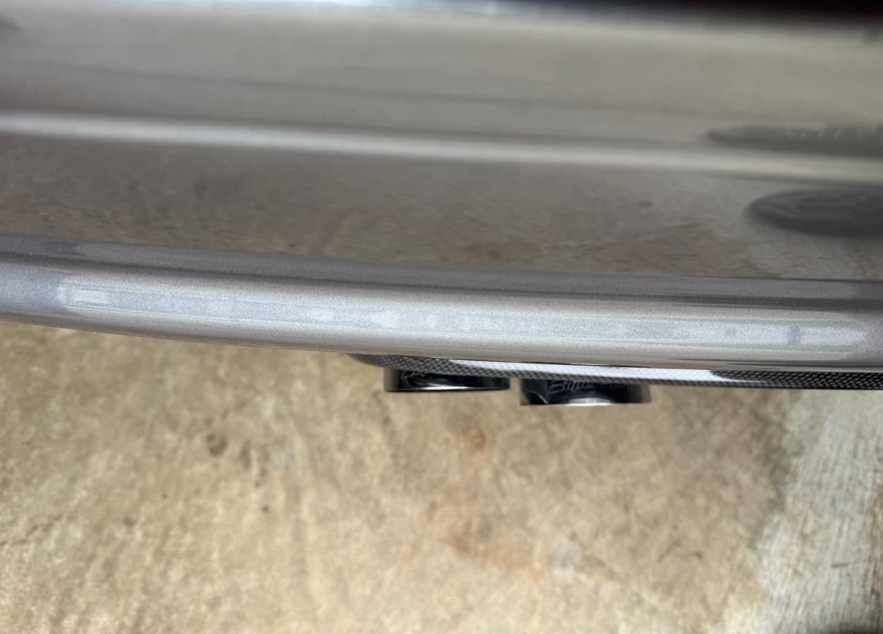

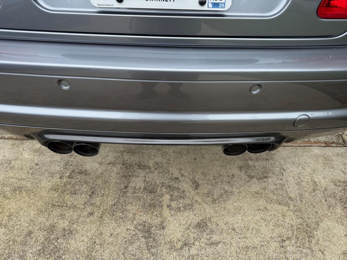

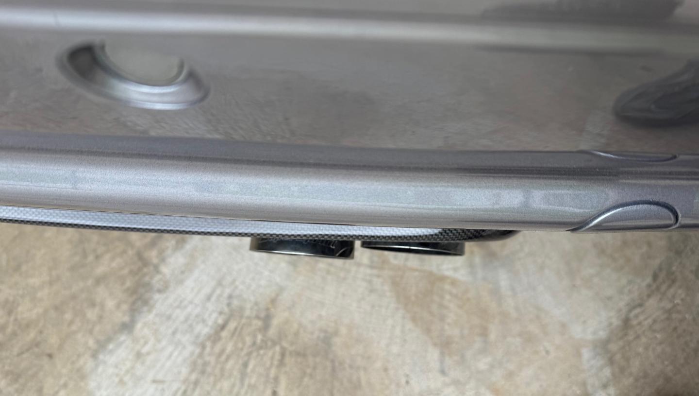

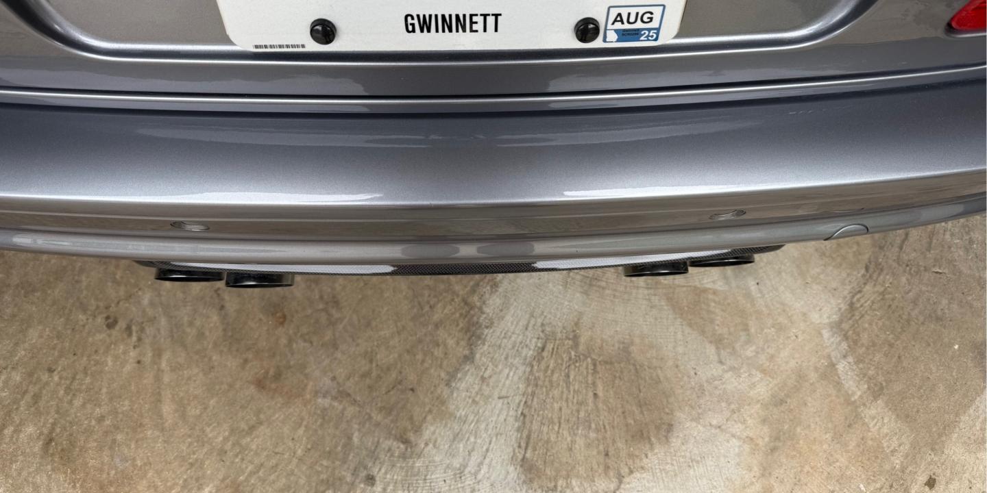

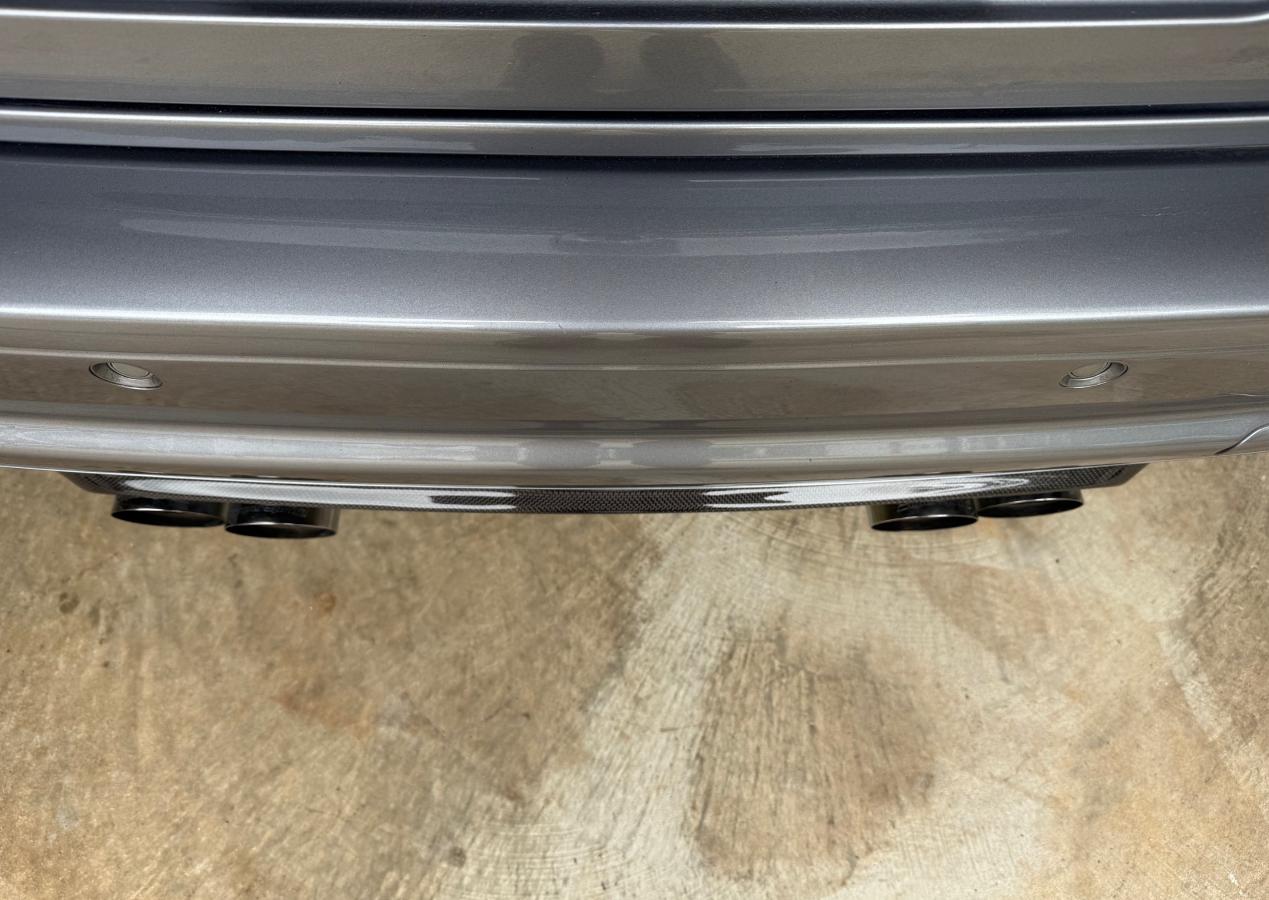

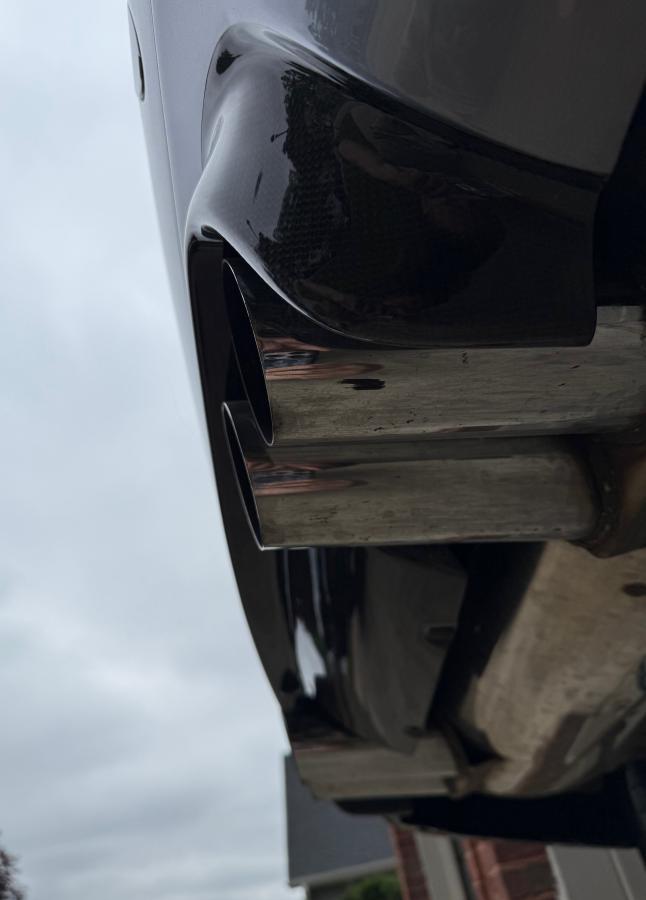

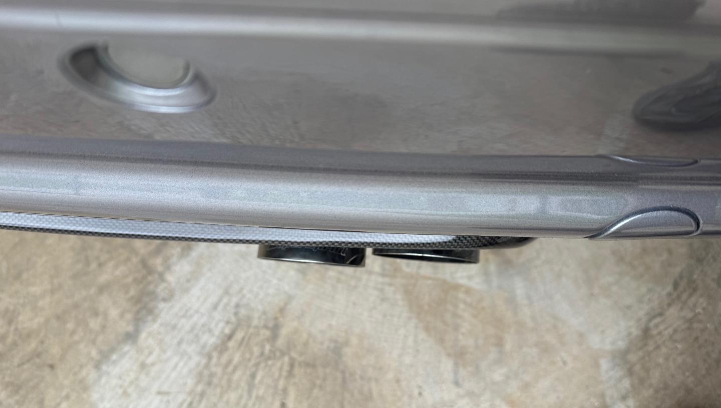

            A little update for those of us who are running Supersprint Sport mufflers and mis-aligned tips. I purchased the Rogue muffler hanger mentioned above when the V2 version was out, didn't realize there was a V3 available now.
            Anyhow, I was going to install the hanger a few weeks ago and got underneath the car and didn't really like the solution. It will undoubtedly add NVH and also I didn't want to accidentally break the exhaust mounting bolts as I understand they can be a bit flimsy.
            I took the car to a local muffler shop and they did a pretty good job WITHOUT using the rogue hanger. They loosened the nuts between section 2 and 3 and did the adjustment that way. The passenger side is probably a cm recessed compared to the driver side but looks a thousand times better than it did before. Attached are some before and after pictures for you to digest.
            BEFORE:
            Click image for larger version  Name:	before1.jpg Views:	26 Size:	36.2 KB ID:	308218
            Click image for larger version  Name:	before.jpg Views:	26 Size:	209.3 KB ID:	308224
            AFTER:
            Click image for larger version  Name:	after.jpg Views:	26 Size:	125.0 KB ID:	308219
            Click image for larger version  Name:	afterLeft.jpg Views:	26 Size:	82.6 KB ID:	308220
            Click image for larger version  Name:	afterRight.jpg Views:	26 Size:	83.2 KB ID:	308225
            Click image for larger version  Name:	afterLeft2.jpg Views:	25 Size:	132.6 KB ID:	308223
            Click image for larger version  Name:	afterRight1.jpg Views:	25 Size:	156.0 KB ID:	308222

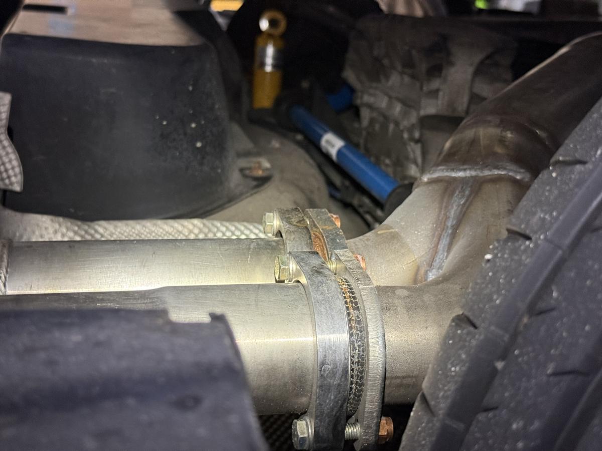

              Same issue (though not quite as bad) with my set up. Fabspeed long tube headers, CPI/BimmerWorld Section 1 Rasp Pipe, Supersprint resonated section 2 x-pipe, Eisenmann Race 76mm mufflers. It seems that the Supersprint section 2 is causing the Eisenmann muffler to sit slightly crooked no matter the adjustment. I'm sure that the Fabspeed headers aren't helping either. It's not bad enough to truly bother me.
                Any issue with torquing one side of each of the section 2 to 3 flanges more than the other? Spent more time that I should have trying to improve the fitment and got it marginally better. I experimented with sliding the flanges around and torquing the opposite side more than the other to try to create a pivot to counteract the imperfect outlet of the SS section 2 xpipe.
                  As long as the “loose” side seals I wouldn’t think so. I’ve never purchased new gaskets to take another crack at this, but assuming the hardware is 12mm I wouldn’t think you could torque it up to about 30-40 or so without much risk.
