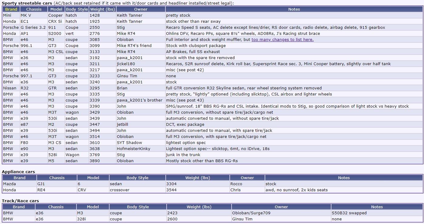

    Thanks for sharing. Im struggling to figure out why my corner weights are so high. I have a ZCP model with manual stock seats, CSL airbox, and CF roof for weight savings. I have the front and rear Mason Bars which add some weight. These corners weights were measured with 5/8 tank of gas so not really that much difference.

        That weight is fairly normal for a non stripped down car. Do you have original wiring, interior, glass, and material aside from roof and trunk? duracellttu
          #64
          Manual seats are only 2 lbs lighter than power seals. CF roof is only 4-8 lbs lighter than a steel slicktop. CSL airbox is <10 lbs lighter than stock airbox. Combined, you're less than 20 lbs off stock, minus what you've added back in with the mason bars.
          ... which jibes-- your corner weights are pretty close to stock.
          I try to weight random cars that show up at my house. Your car is pretty in line with where it should be.
          Everything adjusted to a half tank, no driver:
          Click image for larger version  Name:	5.jpg Views:	0 Size:	307.0 KB ID:	161131
            This is really helpful. Thank you!
            I’m planning to do Recaro CS seat this summer but assume that is a wash weight wise compared to my current manual seats.
                  Why didn’t they calculate the cross weights?
                  I think you can get down to 3000lbs just by taking big stuff out and will still be daily drivable.
                  To get below 3k you have to be willing to sacrifice. Then you need to start slicing up the car to get below 2750.
                    #69
                    I used the flat ride calculator spreadsheet to get the cross weights so it wasn’t a big deal.
                    What do you consider “big stuff”? I’m starting to consider cutting weight. Hitting 3k would be nice, just want to maintain comfort like you stated.
