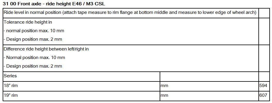

    Some data to entertain
    Regular E46 M3
    Click image for larger version  Name:	E46M3-RideHeight.JPG Views:	0 Size:	35.9 KB ID:	147023
    CSL M3
    Click image for larger version  Name:	E46M3-RideHeightCSL.JPG Views:	0 Size:	38.8 KB ID:	147024
    Rears are
    Regular
    587mm - 18" rim
    600mm - 19" rim
    CSL
    589mm - 18" rim
    602mm - 19" rim
    Yes, surprisingly the CSL is 2mm higher at the rear V Regular M3
    Based on the above, I assume the shock travel for the E46 is the same, in fact, it seems that the Z4M is taller (2mm at 607 at the front and 7mm at the rear at 594)
    I hope this is useful, someone with actual E46 M3 Billies should confirm in the name of data.

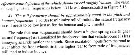

            EDIT: I am technically inclined and an engineer in the field of automotive, but I am not a suspension expert. What I am commenting on here is what I learned from a research driven by my curiosity and if anyone has additional information I will be happy to learn more.
            It's not really clear what FCM means by front/rear bounce rate. From what I know (reference below), the bounce rate is related to how we derive the bounce and pitch frequencies and centers for the coupled front-rear vertical motion of a car. There is not a front and a rear bounce rate. There is just a bounce rate.
            The vehicle bounces (up and down) and oscillates (rocks back and forth) about a bounce center and a pitch center, respectively, at a bounce frequency and a pitch frequency. These two modes are superposed to give the final motion. Given the specifications of the vehicle, one can calculate the centers and frequencies and these properties have an impact on comfort.
            Cars have higher spring rates in the rear than in the front because it minimizes the pitch motion which is the most annoying mode. According to design principles, not only should the rear rate be higher, but it has to be 30% higher - or the spring center should be at least 6.5% of the wheelbase behind the CG. There are also other guidelines as quoted below. So the "Flat Ride" concept might be vaguely related to these guidelines but it isn't 100% defined by them. "Flat Ride" isn't something that's defined in any vehicle dynamics textbooks, as far as I know.
            These principles affect only the ride quality and are unrelated to the cornering ability. I think it is safe to say that cornering ability usually comes at the cost of ride comfort.
            Here are the derived design principles from the source mentioned below:
            Click image for larger version  Name:	Screenshot from 2022-03-23 18-19-58.png Views:	0 Size:	261.4 KB ID:	160407
            Click image for larger version  Name:	Screenshot from 2022-03-23 18-22-08.png Views:	0 Size:	134.9 KB ID:	160408
            Source: Gillespie, Thomas D., fundamentals of vehicle dynamics (relevant chapter available here: https://edisciplinas.usp.br/mod/reso...php?id=2960518
            The relevant portion starts on page 175).

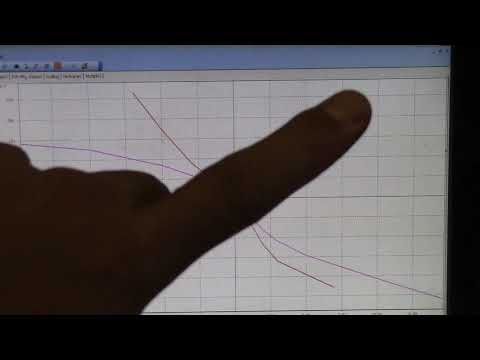

                  Duracellttu is changing from single-adjustable TC Klines and these are two videos I made to show him why his driving experience in Christina was so much more supple and composed than the TC Klines:
                  E46 M3 TC Kline front dyno tests
                  E46 M3 TC Kline rear dyno tests
                  I'll look forward to adding his FCM Elite Stage 3 testimonials to this page, and to the website! Then Ian's later on
