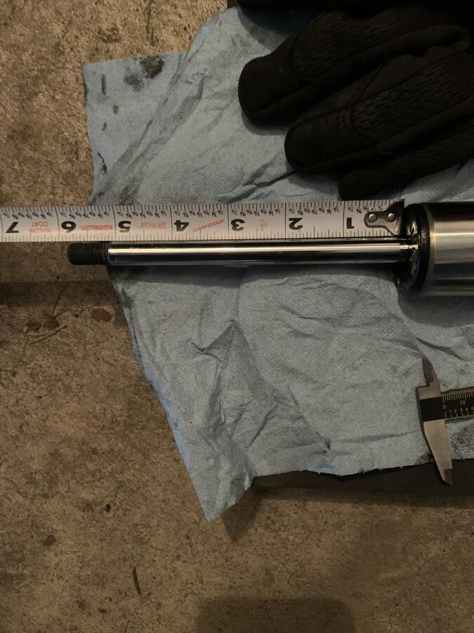

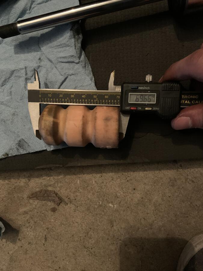

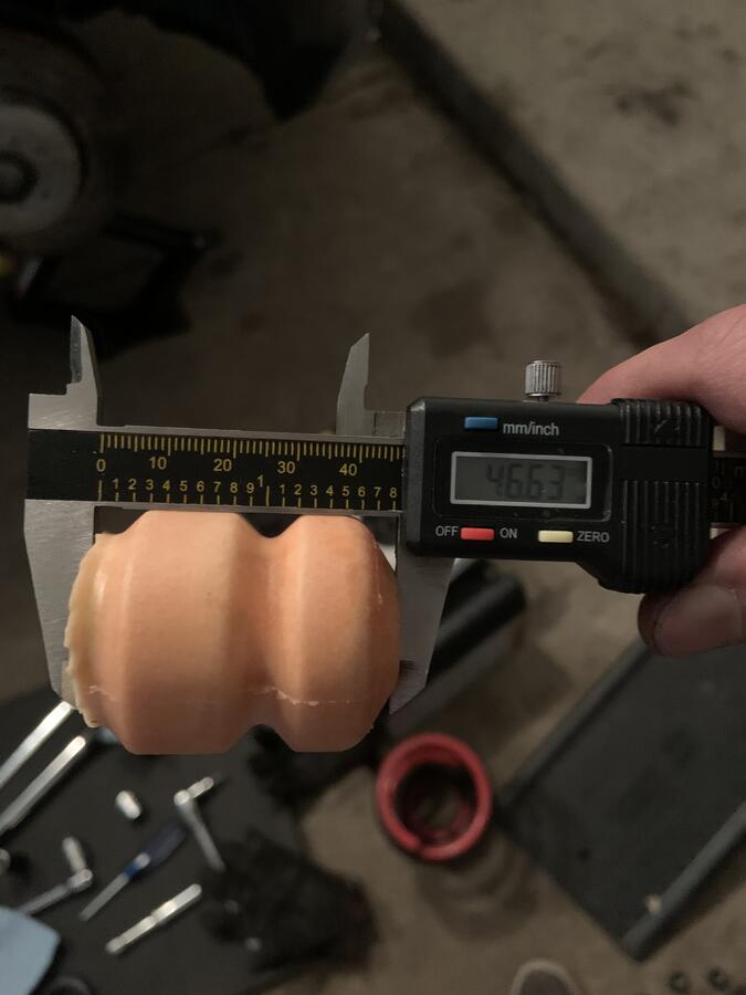

                            I have those rates, and my car was set up at OE ride height (607mm front / 594mm rear), my dampers are a combination of H&R and Bilsteins shocks (H&R Coilover front strut, and B8 HD shock from the Non-M Z4 at the rear).
                            At those rates, the car is still very firmly supported (I would not call them soft at all), it really takes some aggressive dips to make the car even try to bottom out (I have not managed to do that yet - but I am not trying as I don't abuse the car), also keep in mind the Z4MC has the 27mm front sway bar, and I am installing the CSL item to reduce roll up front and balance the FRC.
                            A few reference notes (note this is for the Z4M)...
                            • The H&R coils have 130mm of total travel until the inverted strut insert bottoms out inside the strut housing
                            • The internal bump stop is 70mm long
                            • I would assume a solid block height of ~30mm when the stop is fully compressed
                            Based on the above, and considering I trimmed 25mm off the stop, my car is set so that when supported the damper travels ~55mm, with a remaining ~60mm of bump travel leaving another 15mm in there for a fully compressed bump stop. With this, the car still has 30mm of bump travel before engaging the BS, and another 30mm of the BS acting as a secondary spring.
                            I trimmed the stiffer section.
                            Some images as that are what is always lacking, isn't it?
                            Full travel without the BS, the insert would bottom out inside the strut housing
                            OE H&R Bumpstop
                            Trimmed BS
                            So, I think I could still lower the car by 10mm and still have a good setup, albeit I would give out some travel, or I can use aftermarket plates to not affect travel at all, but since my last interest is in lowering the car, I just don't care. I set her up with functionality and fast road performance in mind.
                            But there you go, if you take some time and make the math you can set up the car in a way that will serve the purpose you have in mind better than just slapping new parts on.
                            P.S. Bilstein HD also use 70mm BS, so they can be trimmed to avoid riding on them all the time (even at stock ride height)
