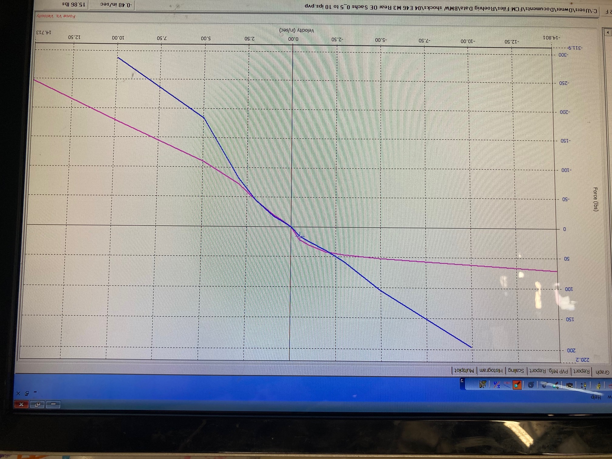

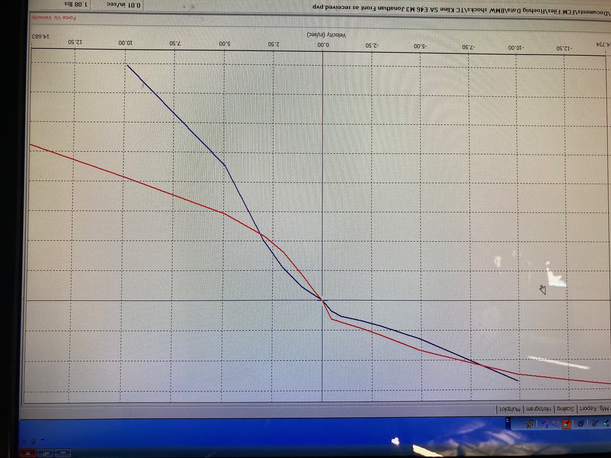

                        At this point it practically IS a guarantee to go faster when switching to FCM. People show up with TCK, Ohlins, MCS, JRZ, Moton, whatever and always go faster with an FCM Elite Bilstein-based setup.
                        The challenge here is I really need to think about what I want before doing the consult with FCM. I think I’ll know more after the consult.
                        The TC Kline front and rear have a fair amount of low speed jerk in bump which isn't good for tire grip or lap times (or comfort - amazing how those three are connected...!).
                        The TC Kline front rebound is less aggressive than OE which is better for overall grip and compliance but it still has a linear-esque curve and IMO too much HS rebound. Also too little HS compression.
                        The TC Kline rear bump is VERY soft while the rebound builds fairly linear it seems (up to 10 ips at least). You get into jacking down by 3 in/sec and the rear is constantly going to be pulling you into the bump stops. Not good.
                        The twin-tube design shows a decent amount of hysteresis - it simply can't be as consistent as a well-tuned monotube, esp. in hotter driving conditions.
                        Most people don't know what to ask a vendor to change - I sure didn't at the beginning of my suspension adventures. There are certain behaviors a damper can produce which - no matter the setting - will result in worse lap times and/or comfort (again, they're more connected than you may realize).
                        Think 'tarmac rally style' suspension tuning more than 'NASCAR style' (rebound-biased). Almost everything out there is the latter, while the superior and provably faster approach is the former (which is how I tune).

                            The TC Klines are weak in compression and strong in rebound as is the case with nearly every twin-tube I've come across, and quite a lot of monotubes as well. This results in a propensity to jack down and bottom out.

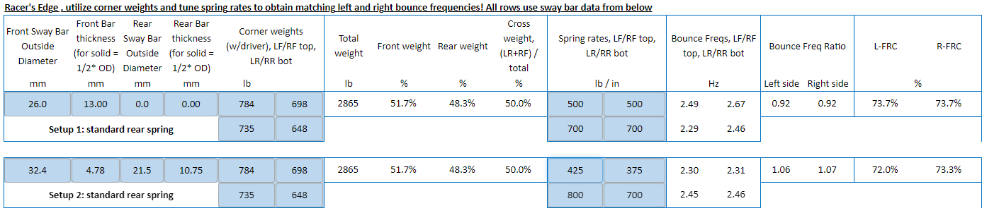

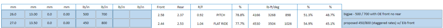

                              bigjae46 Another comment on your ride frequencies, based on the corner weights and spring rates you provided. You have some mismatch in the side-to-side ride frequencies, looks like around 2.49 / 2.67 Hz front and 2.29 / 2.46 Hz rear. The LF and LR springs should be IMO 50 lb/in and 100 lb/in higher than the corresponding right. Also, I'm not sure if you're on stock sways due to NASA point limitations, but your setup does appear to be pitching right now but perhaps less than before? The damper behavior is likely affecting the overall real-world ride frequency compared to the undamped frequency, and there may be some bump stop contact happening as well. In fact, given the rebound-biased nature of the dampers I'm certain that's another factor to consider as a non-linear behavior you're fighting. I'm guessing that your current damper settings even with D/A are likely still giving a rebound bias though admittedly that's an informed ASSumption on my part.
                              My suggestion would be to separate the front and rear more, something like 425 / 375 front and 800 / 700 rear to get ~2.30 / 2.31 Hz front and 2.45 / 2.46 Hz rear. That'd be about 6% Flat Ride. To keep a similar FRC / handling balance you'd want a slightly bigger front bar, like an Eibach 27mm or just deal with the slightly looser handling with alignment / pressure / other adjustments.
                              If we were going to work together, I'd really want you to get a Ground Control front tubular Race and start with it on a softer setting. It's such a great piece with a HUGE adjustment range and you ought to get some weight off the nose of the car as well.
                              Then, as another change to address the low speed understeer, you'd likely want to reinstall the factory rear bar (or any small bar that fits). Without a rear bar, any car will experience terminal understeer in high steering angle (large weight jacking) maneuvers. This is due to an asymmetry in the roll center migration front vs. rear. The front bar being present limits the dynamic roll center change while on the rear with no bar, the droop is higher and the rear roll center changes more. This acts like a dynamic understeer effect which is what we experience particularly in slower turns with higher steering input / weight jacking. Kudos to Emilio at 949Racing who pointed this out. If you look for some posts by him or anyone else who understand the phenomenon, it makes sense and echoes my prior experience when I used to run Miatas with no rear bar and got terminal low speed understeer. I always recommend any racer run a rear bar - and a good quality adjustable end link to prevent bind & preload.
                              I think the current pitching behavior, the lack of rear bar, rebound bias in the TC Kline, and near-certainty of bump stop interaction and dynamic spring rate changes due to jacking down are all points to address to get further optimization from your tire contact patch. You can make a few changes even with your current TC Kline (and maybe run them even softer than you have them, I don't know what settings they're at currently) and likely get further improvements. But unless the TC Kline design allows you to bias the damper more toward 'rally-style' tuning, especially at high damper velocities, you WILL need a superior damper to get to the next level.
                              I really do think a good front tubular bar will be part of that package. There is something to be said for running as little overall bar as possible, but not when you're dealing with pitch and probably can't get on the power aggressively enough or if the car is still pitching / oscillating back-and-forth, your results are limited. I didn't ask about your LSD type and behavior which also plays a role.
                              It sounds like you've done great to this point - I'd like to see you get even faster. The FCM Elite Stage 2 will be a good choice and also show others on this forum that you don't have to sell a kidney to get an awesome Fat Cat setup.
