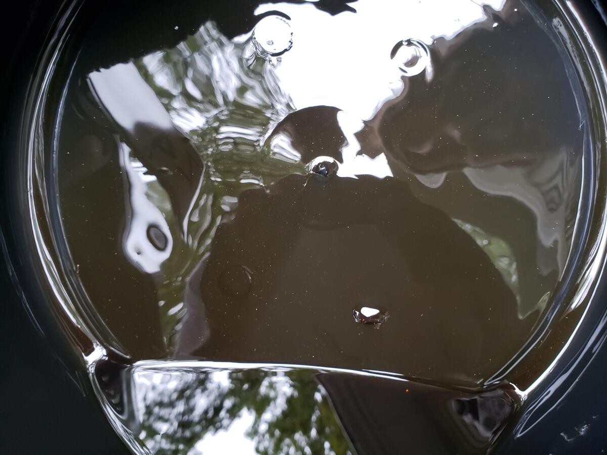

    Yesterday I did an oil change after completing the run in procedure. In the pan and filter, I found a significant amount of metal dust, sand, flakes, etc. Some pieces are as large as a flattened grain of rice.
    Note, prior to the bearings being replaced I had not seen any metal during oil changes.
    How concerned should I be? What would you do?

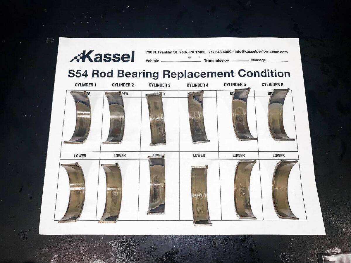

    For reference: old bearings from the replacement 1250 miles ago, and the last oil samples prior to the bearing change.

    How bad were the bearings? This could be residual from old bearings if they were bad. Check the filter, I'm sure all of it is caught there. Are the flakes magnetic?
      Some of that's old bearing material. A few oil changes will help clear it out some. You're going to have that if your bearings were failing. When I did my engine, I changed the oil 5 times because the oil cooler held onto some stuff. I had some throwaway LM that I used initially. Then I changed it again with TWS. In about 1000 miles my car got 5 oil changes and now I use Motul and the oil is spotless. Obviously change the filter with it. You buy Mann filters in bulk for a slight discount.
      Now those big chinks are not good. My previous engine disintegrated a piston and blew holes in each side of cyclinder 6. Those larger chunks appeared and I knew where they were from. You still have that mystery.

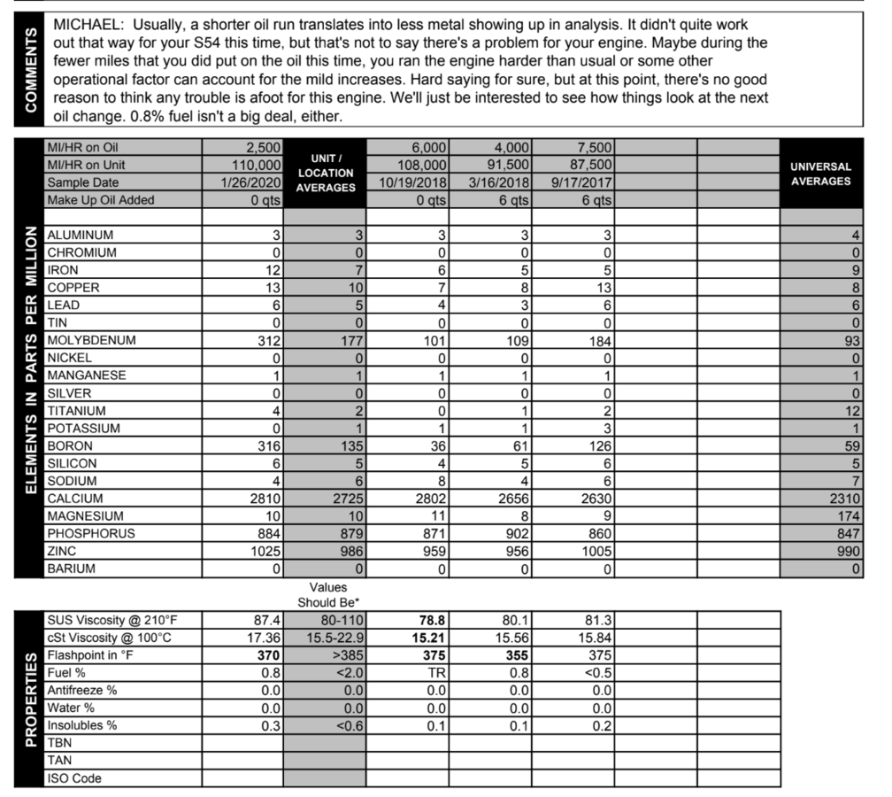

        Old bearings were definitely used up, but I never saw any metal deposits while preforming oil changes with them all the way up to the moment that they were replaced.

        This is the oil analyses prior to bearing replacement

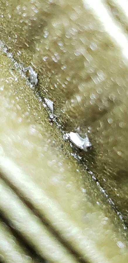

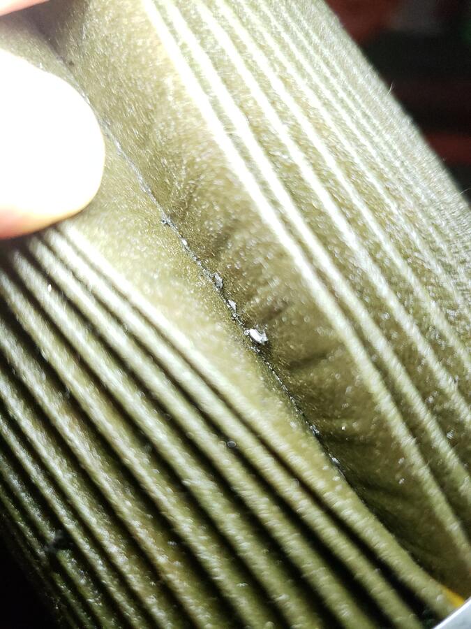

          Took some pictures of the oil filter today. Silver flattened metal, some decent sized chunks as big as a grain of rice. Metal is nonmetalic, as far as I could tell. There did seem to be some small dusty glistening bits of metal in the filter as well - which may be more copper colored, or copper itself, not sure.

            You need to not start the engine again and contact the shop that did the work, give them this information and go from there.

                I think you are taking unnecessary risks by identifying there is a problem and then just blindly driving the car 250 miles there without discussing the situation. If this happened at my shop I would likely come get the car with trailer.
                Email to [email protected]
                  Those large chunks are almost guaranteed to be from something else, NOT the bearings. Glitter in the oil and filter could be residual.
                  But yeah, I would not drive the car until I talk to the shop that did the bearing swap.
                    I've contacted Matt Coyne and will update here.
                    The VANOS was bulletproofed, valve adjustment done, and the cooling system entirely refreshed at the same time the rod bearings were replaced. May be relevant - not sure.

                      Chain guide plastic?

                        The cooling system obviously not, the rest - maybe.
                        I'd say no, since its usually dark colored plastic.
                          Did you get a fresh oil pump chain tensioner/chain/oil pump?
                          Youtube DIYs and more
                            I do not believe so, though the chain guide was replaced.
                            Meanwhile, I have heard back from Matt and he will be picking up the car and trailoring it back to the shop upon request. Will update here, likely in a few weeks, once it's in the shop and Matt has opened up the belly of the beast.

                              Chain that drives cams is separate from chain that drives the oil pump. So where I was going with this (chain/tensioner specific to the one that drives the oil pump) is the shavings could be from the the oil pump to chain contact. Folks usually notice a notch ground into the pick up tube.
                              Good to hear they will take a look.
