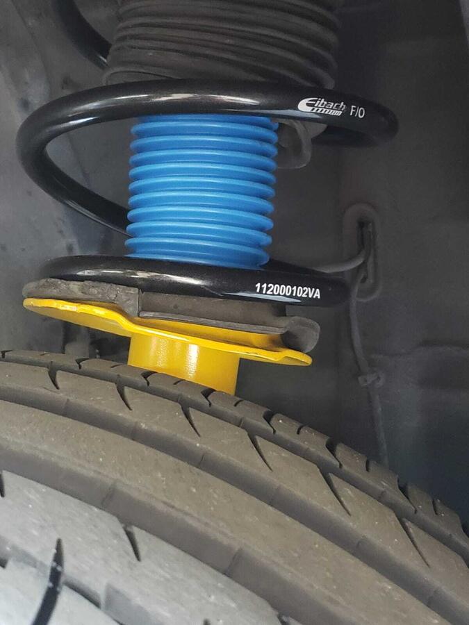

          +1 On the B12 Pro Kit, feels great on SoCal roads and about to find out how it handles at the track this weekend (Autoclub in Fontana)
            ^^ your spring isn't seated right. The coil end should be there in that empty space.
              And...going to go check right now if that's how it is, i took this picture while they were installing, thanks for the catch
