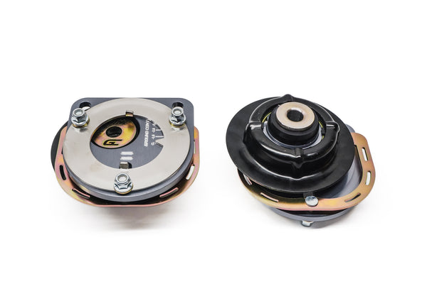

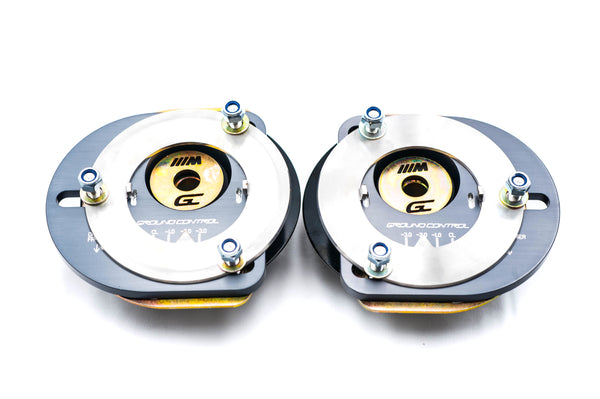

              Another note I fogot to mention is he highly suggested NOT using camber/caster plates with these. It voids the warranty if that causes any problems. I would not advise telling them you have camber plates unless they ask. He said it puts stress on the shaft and cause leaks or other issues.
              I've seen this mentioned in GC's camber plate description. They also call Bilsteins out as specifically being susceptible to this.
              These camber plates are built at an angle, just like the engineers correctly determined the stock ones should be.......A straight camber plate will always hold the strut at angle, causing premature wear of the side seals, especially on Bilstein PSS9. This is because the e46 M3 strut NEVER is straight.
              Ground Control Sport Camber / Caster Plates This a high quality, complete replacement for the e46 upper mount, this product is not the style that is bolted between and raises the car.  This is a camber plate for the E46 M3 (for non-M E46 click here). Camber is adjustable through a 2 degree range.Stainless steel reinfor

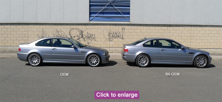

                                Bilstein B6 dampers make the car sit higher due to its high gas pressure.
